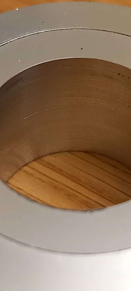

      I chose a 60 tooth pulley to go on the end of the spindle coupled to a 30 tooth on the encoder. So the first task is to bore out the pulley to fit in place of the 25T gear on the end of the spindle. The end of of the spindle is 7/8″.
      So this is my first ever attempt at boring. Just to add a bit of pressure it is to a size.

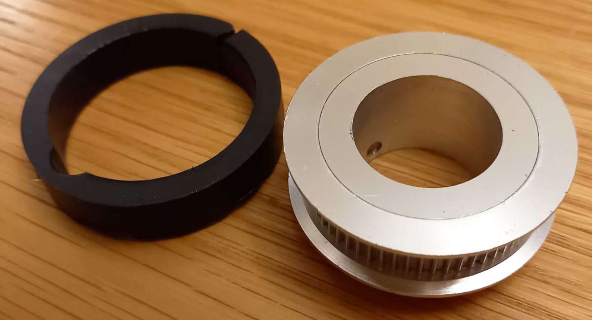

      First issue is that the pulley is flanged so I can’t just stck it in the chuck. So first tak is to make a collet. I decided on delrin as I had a bit of scrap plate handy. Hacked it into rough hexagon with a hacksaw and stuck a M12 bolt through the middle. also put a hole approximately on what would be the inner diameter. Held it in the 3 jaw by the bolt head and turned the outside to a few millimeters larger than the pulley flange diameter. Took it off, removed the bolt and chucked it in the 3 jaw marking the jaw 1 position. Bored out the center to the OD of the pulley teeth (34mm). Took out of chuck and silt it opposite the remains of the 10mm hole.
      The Delrin is flexible enough at the thinned out bit made by the 10mm semicircle to snap over the pully flange. Aligned the mark with jaw 1, chucked it and run-out was acceptable. Drilled out the existing 5mm bore to 1/2″. Then started boring using a HSS tool and brush applied WD40 as lubrication.
      Even if I say so myself the finish isn’t too bad for a first attempt:
      Headstock-pulley-1Headstock-pulley-2

        Hold it on the flanges and take light cuts. If you really want to, cut up 3 bits of soft aluminium and put them between chuck teeth and the pulley flanges.

            I used the 4-jaw to hold by the flanges on mine, but they were steel. Your flexible ‘collet’ is a good idea and should give good concentricity with the teeth.

                    The flanges are aluminium and not really strong enough even for aluminium. As I have at least one other 60T pulley to bore it was worth spending the time to make the delrin collet.
