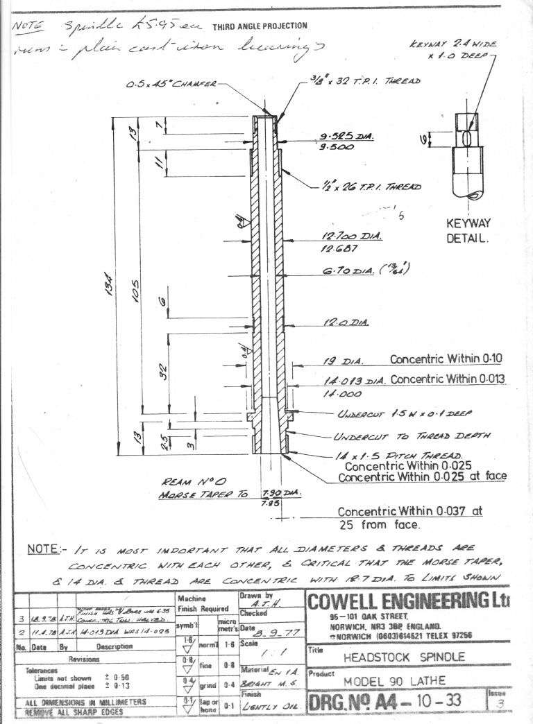

        #737884
          This is the early version of the Cowells spindle [1.5mm pitch] but so far as I am aware all other details remain unchanged … It may be of interest.

          #737893
          MichaelR
            @michaelr
            You will have to remove the gear on the spindle and slacken the drive pulleys to withdraw the spindle for a belt change..
            See this Link https://altrish.co.uk/tag/cowells-lathe/ there is a full explanation.

            #737896
            Roger Woollett
              @rogerwoollett53105
              I also have a Cowells 90ME. The instructions in MichaelR’s link look good to me. Two things to be particularly careful of. Do slacken the bearings completely. Wear is likely to have made the arbor bearing slightly smaller tan the rest of the arbor Also the grub screw securing the pulley is likely to have raised a burr. You may have to tap the arbor gently to get the burr through the front bearing.
              #737899
              Hopper
                @hopper
                Or possibly drop a drill bit down the grub screw hole and remove the burr on the spindle before passing it through the bearing?
