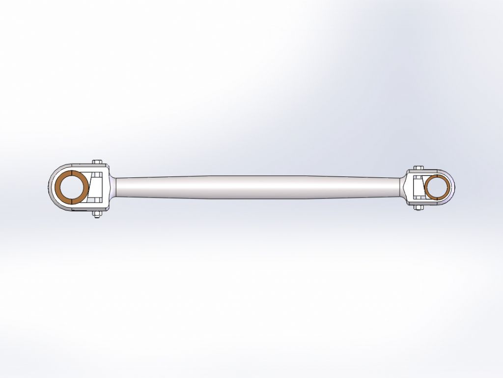

The usual way is to roughly divide the length into three, the centre is left parallel, left and right ends turned to a slight taper and then blend the three with a file.
Have a look at this post of mine about crowning a pully/flywheel its the same method.
Depending on the radius at each end you may get away with a round nose tool or it can be done will a ball turner set to turn concave like this, the ends are then machined to the rectangular section

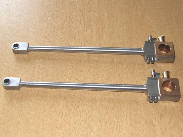

Hopefully Andrew Johnson will see this as he has just posted the machining of a couple of conrods with a template follower on TT, I won't steal his thunder and post the pics here, he can do that.
