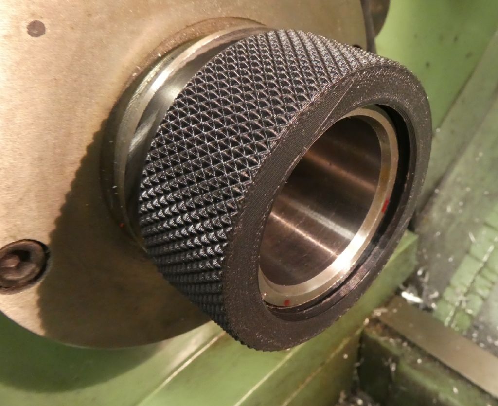

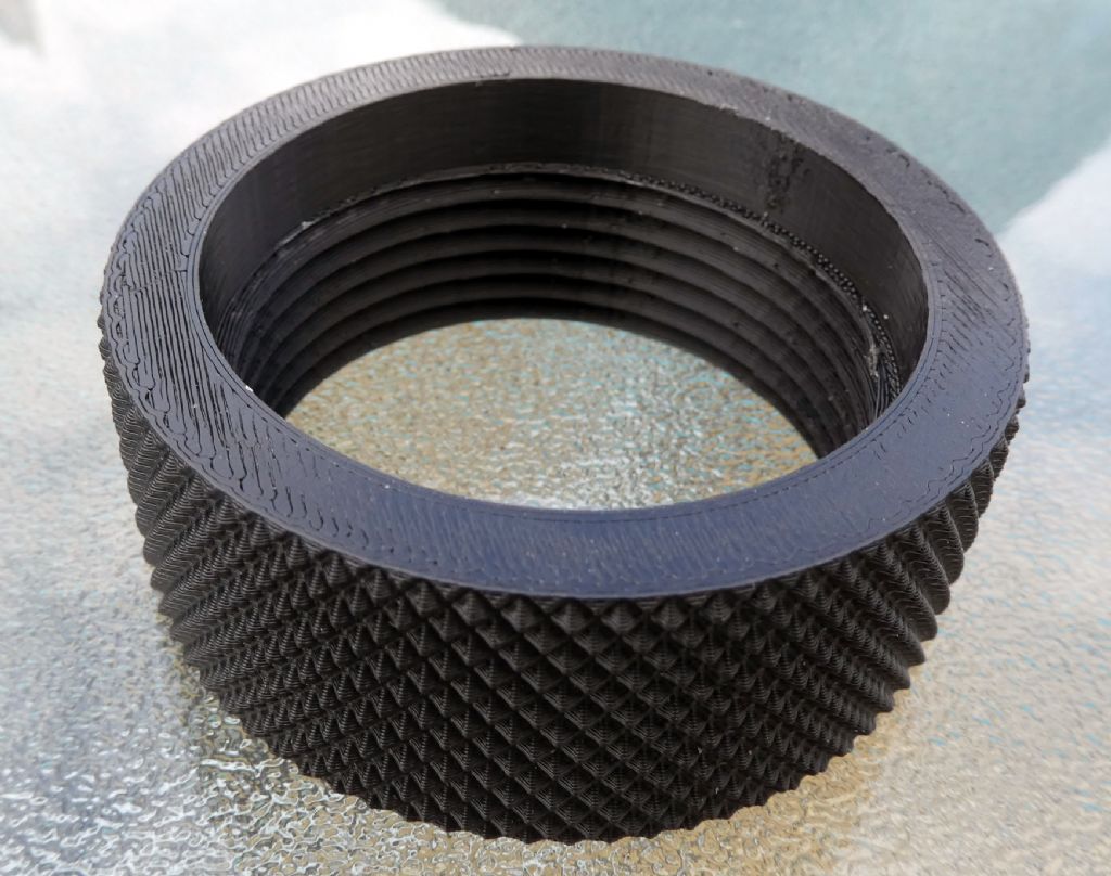

      My first 3D printer sits on the desk and the question now is what to print first? I didn't need a plastic frog or any other pointless "thingy" but I did need a thread protector for my lathe spindle. Not having mastered any modelling software as yet I cheated and eventually found an .STL file online that I thought might be near enough.

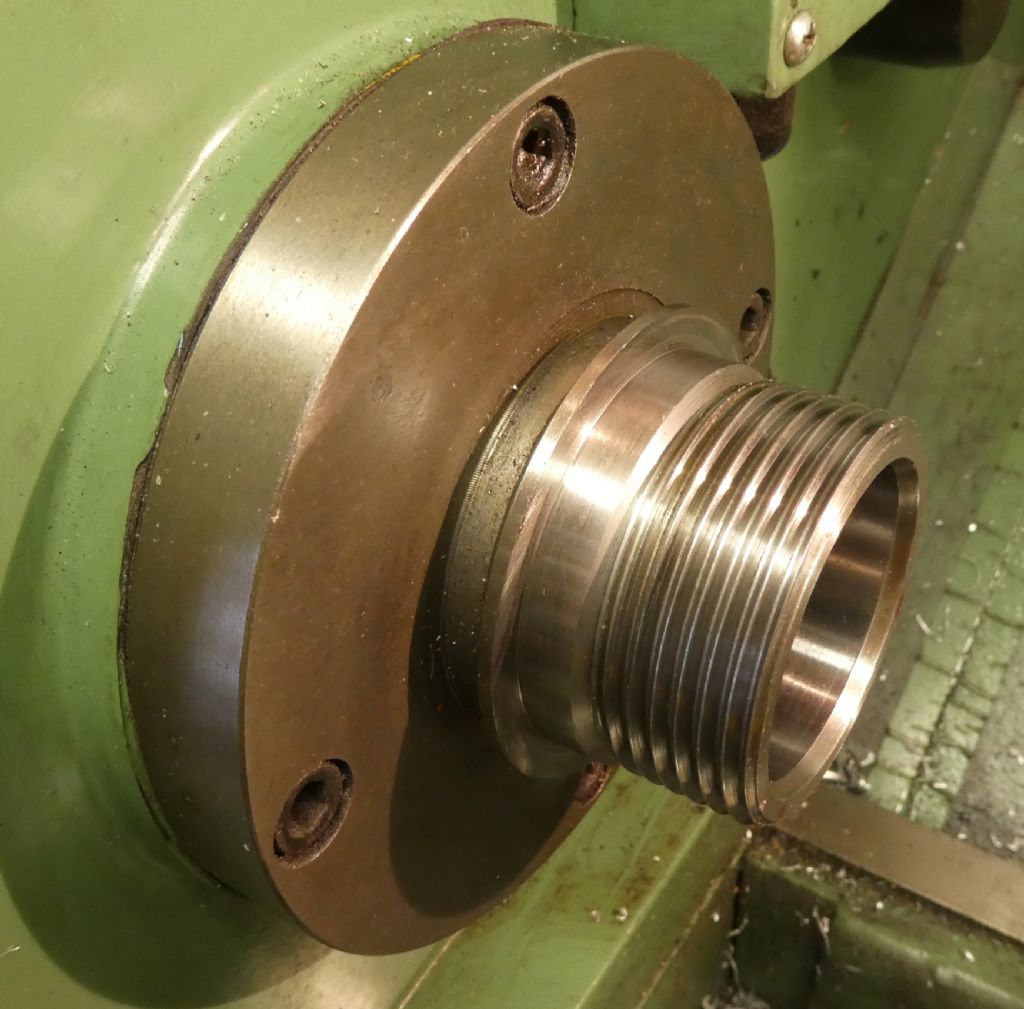

      This had been designed to fit a Logan lathe with a 2.25" x 8tpi thread, the same thread as my WARCO BH600G. The overall length was a bit short and the plain bore a little small but I thought that it might work.
      And work it does. It screws on with a flick and jams tight as seen in the third pic – covering the threads and keeping them safe. Printed using eco-ABS filament.

            Excellent, an ideal application.
            Lovely crisp 'knurling' – which printer is it?

              Thanks for the comment Neil, I eventually decided on the Dremel 3D45. Lots of £££'s I know but there's no pockets in shrouds is there?
