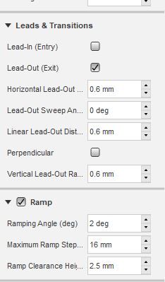

                                  I might be tempted to reduce the plunge rate a bit particularly when you get to the alumminium so the tool does not drop down into the cut quite so fast.
                                  The other alternative is to have it ramp down into the contour which also eliminates the need for it to lift and plunge each time it cuts a new layer. You can do this in the linking tab (yellow one) by ticking ramp. The only thing to watch is that if you only tick ramp at the end of teh cut it will lead out away from the finished edge into solid material so you need to set leadout angle to zero rather than 90deg, see below

                                    Thanks, Jason. I think that I’ll try out those settings and re-run the code in thin air but with the cutters mounted, just to see the effects. It was my intention to reduce the plunge rates in addition to the depths of cut before taking on the aluminium again.
                                    #547585
                                      If you do try it then set the Max Ramp Step to the max DOC you want to use eg 0.4mm not the 16mm in the image above. You can have a look at the way it changes things on the F360 simulator and then see if the air cut is the same.

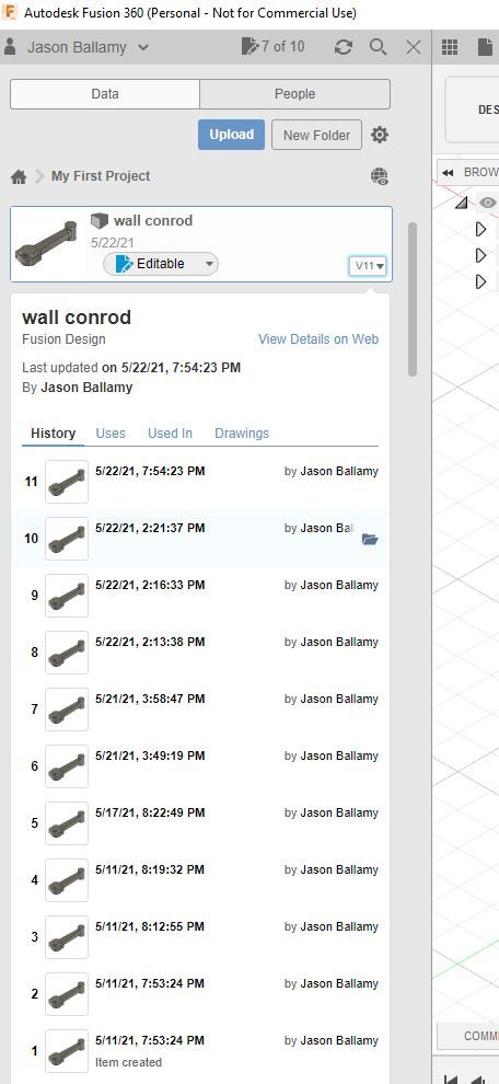

                                        Thanks, again. Just tried that and somehow managed to lose the changed file. I hate the way Fusion stores everything in the clouds. I much prefer to have it on my computer but don't see how to do that.
                                        #547599
                                          You should be able to list all the revisions if you click the data panel and then the box with your conrod will have the latest revision number with an arrow next to it, click that and all the saved versions should come up. Hold the mouse over your name on the revision you want and click the file icon that comes up to open.

                                            I see. I Googled it and it said to use the export option. So I tried that and it worked, so now I have two ways! London buses and all that!

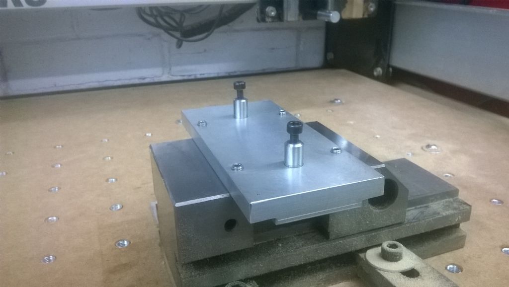

                                              Spent a bit of yesterday and some of today making a fixture to hold the aluminium stock for my attempt at milling the con rod shape. I half-inched an idea from Cough42 (he of electronic lead screw fame on YouTube) but modified it a little:
                                              Conrod holding fixture
                                              Here it is mounted in the vice. The bed of the router table is not necessarily exactly parallel to the plane of the X_Y axis carriages, so I've fitted some grub screws which bear on the top of the vice jaws that I hope will allow me to line up the top surface of the fixture using a dial gauge attached to the Z-axis carriage. That's the theory. Let's see if reality proves the theory correct. I'll make a video and that will show what happens. Three screws would have been better, of course, but there's nothing for the third one to bear on. The two dowels are silver steel rod pressed into the base at the centre distance of the little and big ends. This means I'll have to revert to material 10mm thick and do away with the facing process. As my stock of aluminium is severely depleted, I'm going to double- and triple-check the Gcode before committing to a full-blown run and publishing the results on here and YT.
