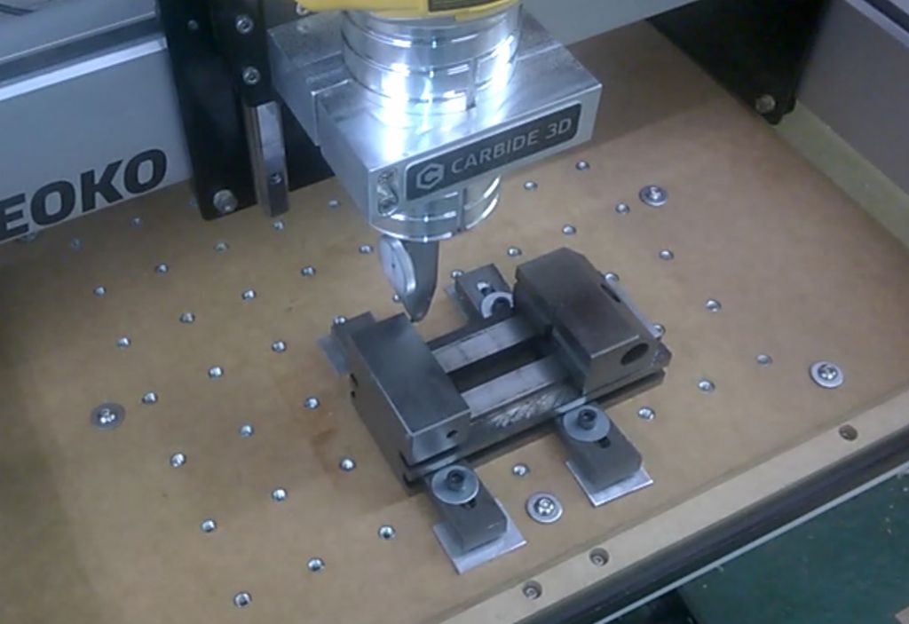

                                        #543542
                                        John Hinkley
                                          @johnhinkley26699
                                          Me again, folks!
                                          Having taken heed of Jason's wise words, I've relieved the shaper of its vice and mounted it on the router table. Fortunately only minor surgery to the bolt slots was required to align with the mounting holes in the wasteboard:
                                          Vice mounting

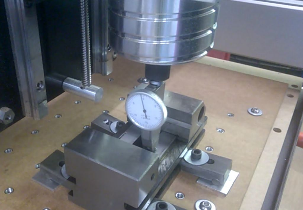

                                          I also managed to mount a DTI directly in the router spindle in order to check the Y-axis tramming. The photo of the start, below, is taken from the video, so not very clear, I'm afraid.
                                          Tramming the vice - start

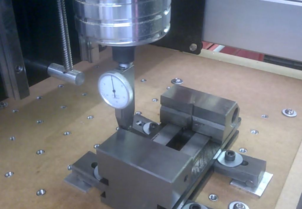

                                          Every journey has a start and an end and this is the end of that journey:
                                          Tramming the vice - end
                                          The DTI flattered to deceive as it remained solidly on the zero mark except for the last centimetre where it suddenly veered of by a miniscule* amount.
