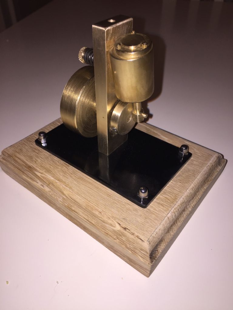

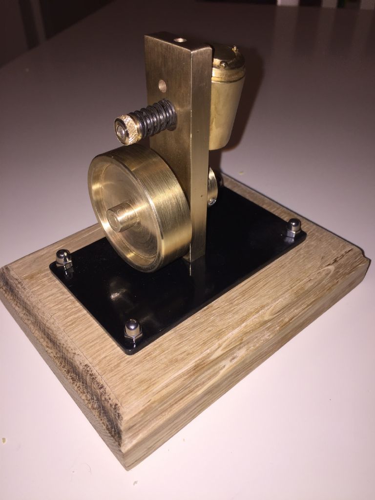

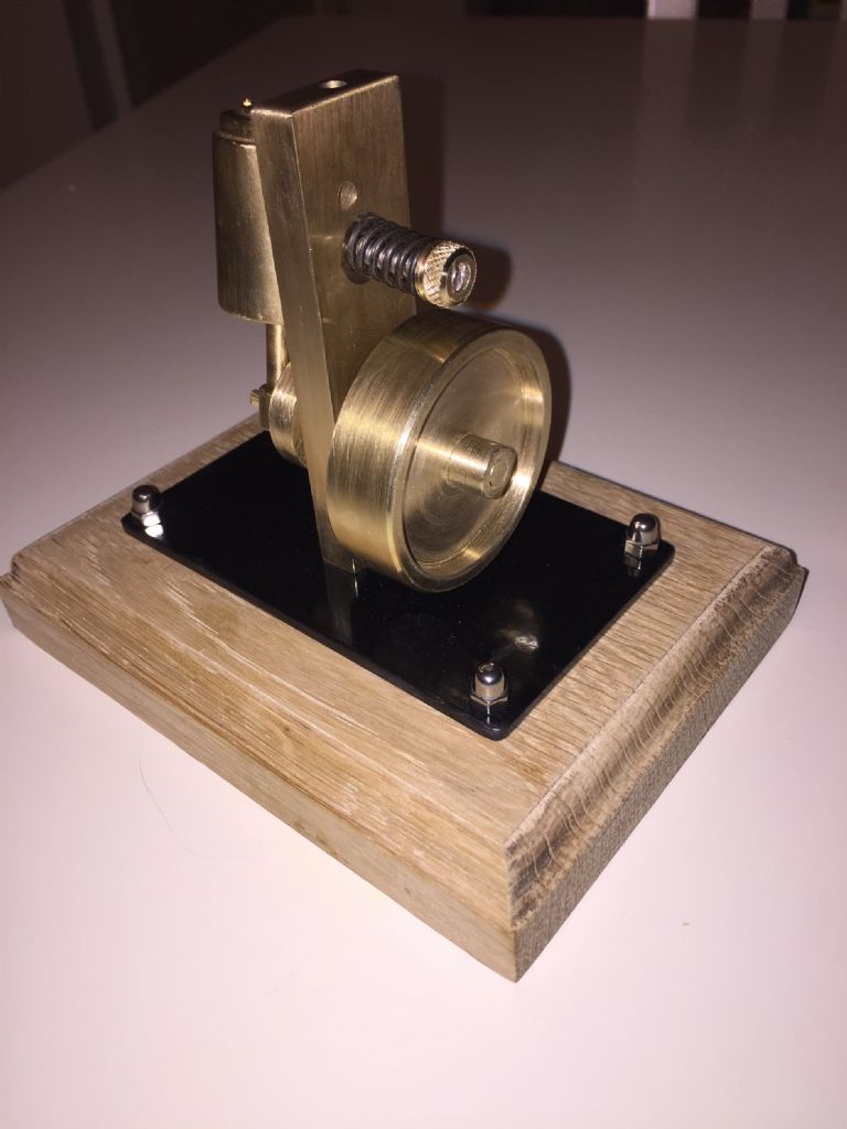

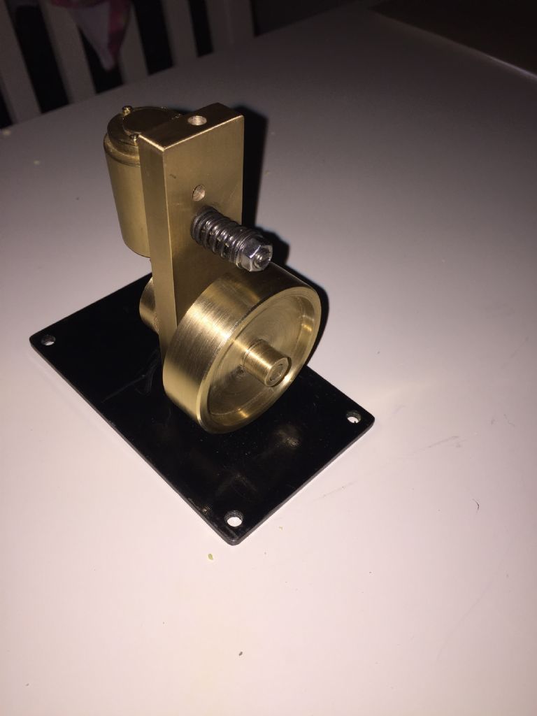

                  Update:
                  A little bit closer to getting finished, new knurled nut to replace hex nut on trunion pin, cleaned up a little more and mounted.
                  I think I only have the inlet/exhaust tubes to solder in and the base to varnish and as long as she runs she will be finished!! Hopefully I will be able to accomplish the above tomorrow.

                  Bruce Edney
                    @bruceedney59949
                    Is it just me or is this missing an exhaust port? I can see how the air/steam can get in but how does it get out?
                    Bruce
                    #243485
                    Bruce Edney
                      @bruceedney59949
                      Oh wait is that another port on the top???
                      #243486
                      Mark Williams 21
                        @markwilliams21
                        Posted by Bruce Edney on 20/06/2016 04:49:08:
                        Yes Bruce, the one on top is inlet, the one on the side exhaust.
                        #243555
                        Ian S C
                          @iansc
                          Mark, he means the wee one on the port face, there should be two side by side, they line up with the one hole in the cylinder, inlet at one extreme, exhaust at the other. Ian S C

                            Ah ok I thought he was commenting on the latest pics, I can assure you on the cylinder side there is indeed two holes side by side, one inlet, one exhaust 👍🏻
                            #243663
                            Ian S C
                              @iansc
                              Mark, it's usual to have one hole on the cylinder, and two on the fixed block, if it's the other way round where is the exhaust going to go? Ian S Cdsc01106 (800x600).jpg

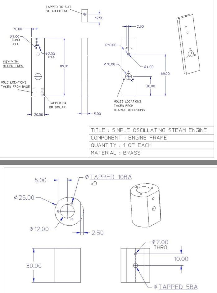

                                    Posted by Ian S C on 21/06/2016 10:03:12:
                                    Hi Ian, it has 2 on the block and one on the cylinder, one of the holes is a blind hole that connects to the vertical hole on the top of the block (inlet), and the other is the one going through the block for the exhaust as per the plan below:
                                    #243811
                                    Ian S C
                                      @iansc
                                      Sorry Mark, the photo I see must show the side away from the cylinder side, fuss all over. Ian S C

                                          What method would you use to slice off 2.5mm from the cylinder without a mill ?
                                          #243816
                                          Mark Williams 21
                                            @markwilliams21
                                            If you look on the website **LINK** it gives full instructions and shows you how to achieve the mill cut on your lathe
                                            #243828
                                            Bazyle
                                              @bazyle
                                              Slightly easier is to hold it in a 4-jaw but if you only have a 3-jaw it can still be held though purists will shudder but it doesn't need to be centralised in this application so do-able. Put a bridge plate across two of the jaws if the workpiece is a little short relative to the gap.
                                              It's a nice idea having the website pictorial instruction. Anyone else making this might consider making the second port come out the side instead of the back in a similar way to the top one. This will give more 'meat' for attaching a pipe.
