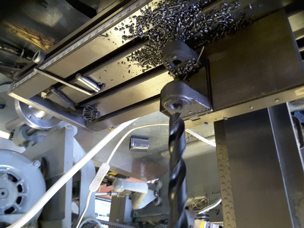

      I have started the model lathe which my wife bought me for Christmas. Its the first thing which isn't to do with tooling or parts for my lathe etc since retiring and my first model. The first few castings started.

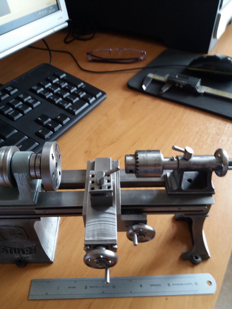

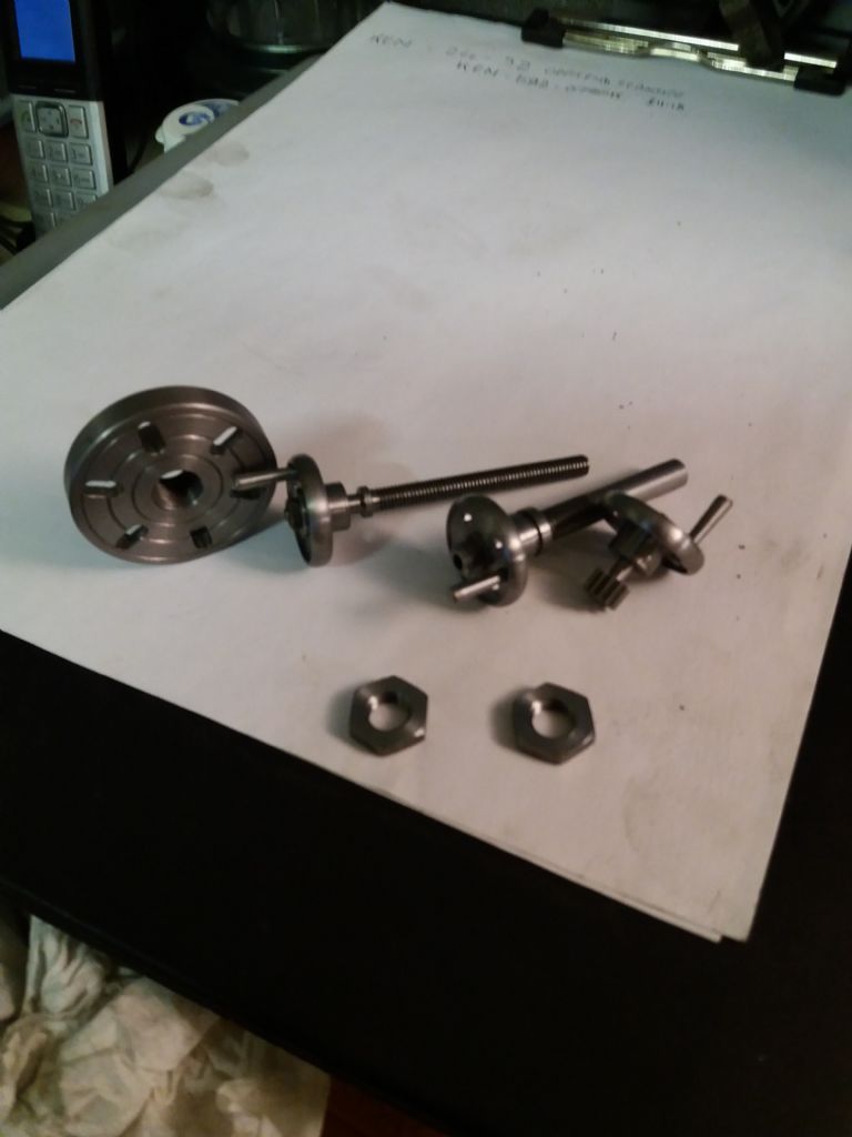

            #290235
            David George 1
              @davidgeorge1
              A couple of parts turned ready for milling, faceplate and tailstock hand wheel.
              David

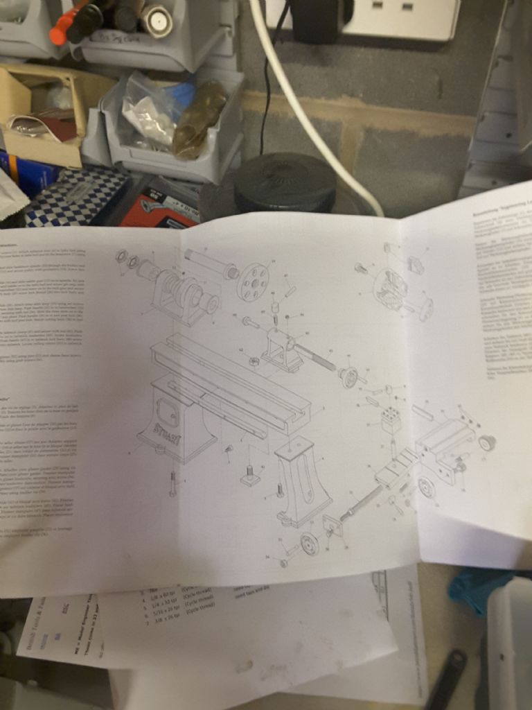

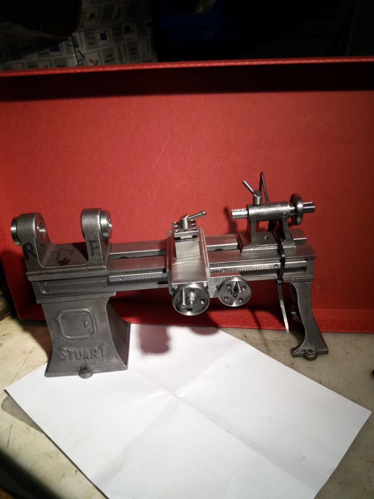

              #290311
              mechman48
                @mechman48
                Hi David; from the drawings I am assuming it's a Stuarts kit. looking at seeing the final built, do you plan to motorise it?

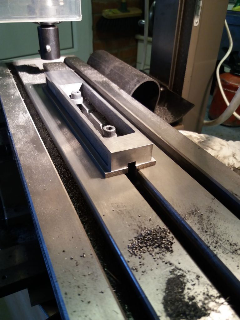

                  #290329
                  Martin Kyte
                    @martinkyte99762
                    The T slots on the cross slide are shown just as slots. I found if you take a piercing saw to them with the cross slide held on the vice you can cut reasonable representations of the _ bit of the T slot. The saw will only really cut on the outside of the piece but that's the only bit you can see. I didn't like the big hex nuts on the end of the spindle either so did some with slots on a 8 point PCD a la crescent wrench style and they are better but still a little chunky. Sometime I may get round to making some more with holes instead of slots. It's an attractive little model. A brass makers plate would look good too after you got rid of the STUART on the casting.

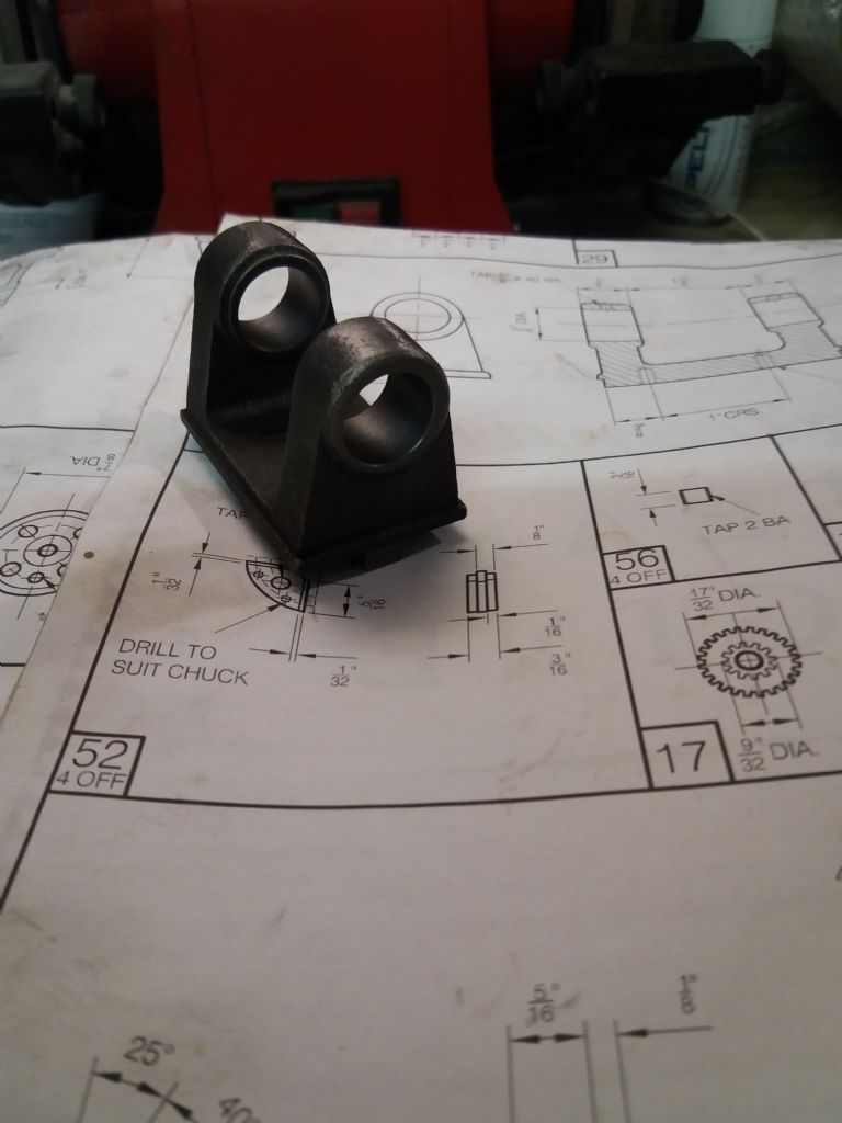

                      #300751
                      David George 1
                        @davidgeorge1
                        A few more parts in progress to Stuart lathe.
                        David

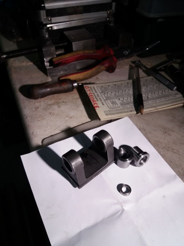

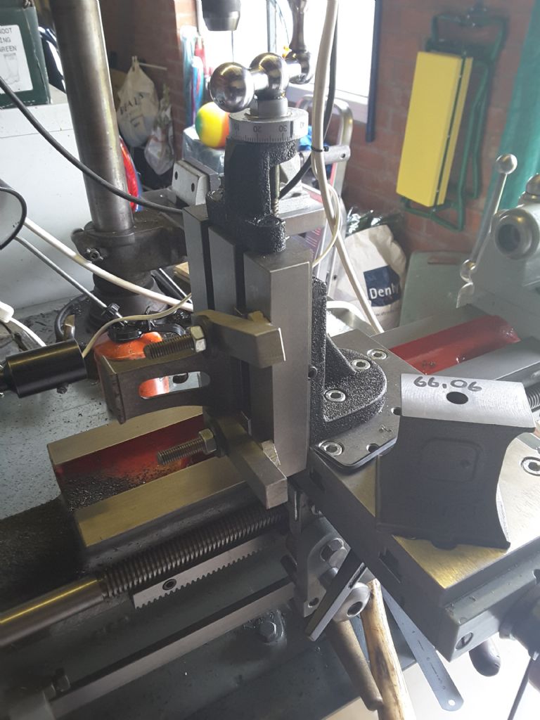

                        #308496
                        David George 1
                          @davidgeorge1
                          I have done a few new parts for Stuart Lathe.
                          David
                          #308497
                          Martin Kyte
                            @martinkyte99762
                            Are the bearings not in Brass?bronze?
                            Looks nice though.
                            regards Martin
                            #308508
                            David George 1
                              @davidgeorge1
                              I have tried to fit ball bearings into the headstock so I can run it at a higher speed, two in the front bearing and one in the rear. When I have made the spindle I shall see if it works.

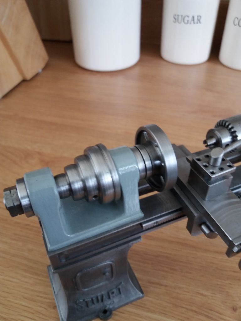

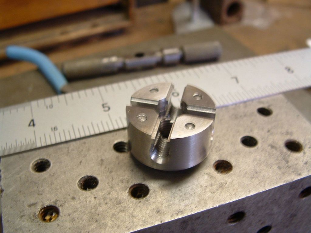

                                  #309486

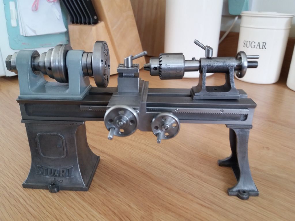

                                  David George 1
                                    @davidgeorge1
                                    Next stage finished on Lathe. Headstock finished and chuck fitted to tailstock. All looks ok at the moment.
                                    David
                                    #309498
                                    geoff walker 1
                                      @geoffwalker1
                                      Hi David,
                                      I have been following this thread with interest.
                                      Well done a really nice outcome, I'm jealous, I want one!
                                      Look forward to seeing it powered up.
                                      Could you post future pictures with a ruler in the foreground so I/we can get an idea of the size.
                                      Geoff
                                      #309499
                                        Coming along well!
                                        #309624
                                        Thomas Staubo
                                          @thomasstaubo12021
                                          Great work David! thumbs up
                                          Too few are making models of machine tools IMHO.
                                          The tailstock chuck you attached looked out of proportions though.
                                          But I have a tip for you; I bought a miniature chuck from Banggood, that may be more appropriate in size. I thought I would show the size of of the one I bought, by taking a picture in my hand, but I can't locate it at the moment (too small maybe? cheeky)
                                          It has a JT0 taper, but comes with a tapered adaptor if you need. Dimensions is ø 21.5mm x l 35mm
                                          Here's the link:
                                          **LINK**
                                          #309628
                                          geoff walker 1
                                            @geoffwalker1
                                            Hi David,
                                            I think Thomas has a point, the chuck does look a bit on the large side.
                                            I have just bought a mini chuck from Arc euro trade 4mm capacity and jto taper, it's a good chuck.
                                            geoff
                                            #309641
                                            David George 1
                                              @davidgeorge1
                                              I agree with you that the chuck is a bit large, but it is the smallest that I can find at 21mm dia by 28 long 4mm drill .
                                              David
                                              #309660
                                              Thomas Staubo
                                                @thomasstaubo12021
                                                Aah, that's the same size as the one I linked to. I don't think you can buy any smaller than that.
                                                That means that you have to make your own tailstock chuck from scratch too! laugh
                                                #309674
                                                Harry Wilkes
                                                  @harrywilkes58467
                                                  Nice work yes
                                                  H
                                                  #309692
                                                  Ian S C
                                                    @iansc
                                                    You could use the adjustable chuck from Dremel(or similar sized tool). i have a Jacobs Chuck that opens to 3/16".
                                                    Ian S C
                                                    #309775
                                                    Martin Kyte
                                                      @martinkyte99762
                                                      It does look nice and I hate to say but, but ,
                                                      Stuart Turner state that
                                                      The Stuart Engineering Lathe has been carefully designed by taking the most interesting elements from lathes in use at the end of the 19th century and combining them to produce an attractive model.
                                                      and . . .
                                                      The Jacobs Chuck was first Patented in 1902.
                                                      Personally I think it would look better with taper drills.
                                                      However it is your model and I say this only for information and not at all from a sense of criticism.
                                                      regards Martin
