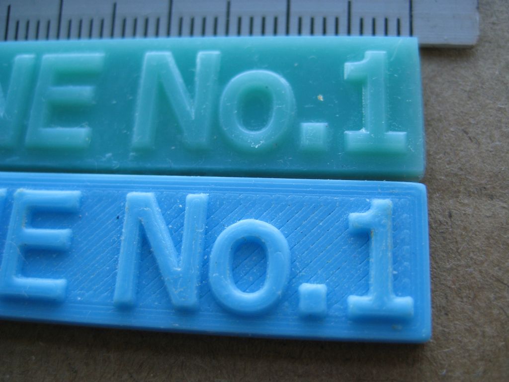

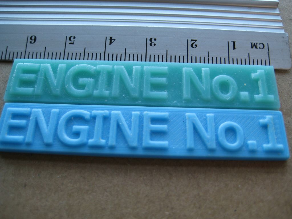

      I had an idea my first print wouldn't go well, I expected total failure. The FEP film at the bottom of the resin vat had small ripples in it, I don't know how or when they got there, but the film is supposed to be flat and under tension. An hour after pressing start I could see the build plate emerging from the resin vat, I had put too much resin in so I couldn't see what was going on before. I saw that there was some sort of failure, so I stopped the print to have a look. I had 5 items on the build plate, 3 had printed OK, 1 had failed and the 5th hadn't had time to get going. IMG-2061 shows a small name plate, the green one is from the resin printer, the blue one from my Ender3. IMG-2064 is the closest my old camera could get. The fillet is half a mm. IMG-2065 is 55mm across and shows how flat the surface is, it's glass smooth. I am now wondering if I should try another print with the existing FEP, I think some of the ripples have lessened.

            I watched a video this evening on youtube where the poster's FEP had as many wrinkles as mine. It didn't seem to bother him. I think, now that I have had to think, that the problem is down to me. Not enough supports and not strong enough for the job. I will create another slice with more thought put into the position and support of the parts. If it still fails then I have to turn to the FEP.

                  Bazyle, I found the missing bit at the bottom of the vat when I was cleaning it. The FEP seems to be a bit flatter after the first attempt at printing, so I think most of the problems were down to me not knowing what I was doing! I used Prusa slicer to produce an STL to import into Photon slicer which is a tad unstable on my computer. I didn't realise until today that the size of the supports in Prusa can be adjusted. I think the supports I used were too small and too few. I am now putting another file together using what I have learnt. Try two should be soon. I would like to find a source of FEP at that price, they seem to be very expensive.
