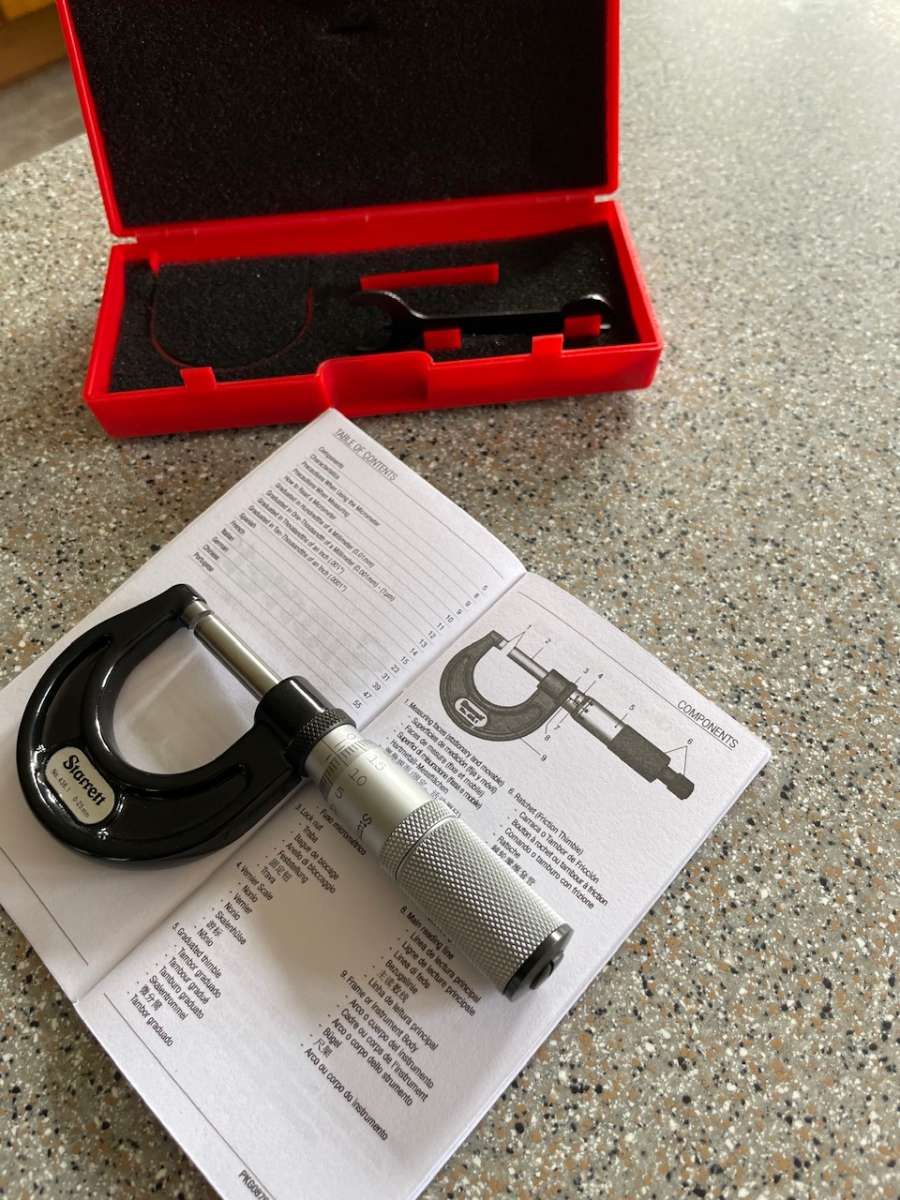

      Hi folks, I have just bought a Starrett 463.1MXRL-25 0-25mm outside micrometer, my first such device.
      There is supposed to be a ratchet friction thimble protruding from the end of the measuring shaft, but as supplied, my one does not have this – just a straight slot in a black coloured end cap.
      Do I unscrew this slot, and will the ratchet thimble spring out, or what do I do ? (It does not move with light turning pressure from a screwdriver).  If it does unscrew, is it right or left handed thread ?
      The measuring shaft itself is also VERY stiff to turn. Is there a way to reduce the friction on the measuring shaft ?
      There is nothing about any of this in the little leaflet, and I don’t want to force anything and risk damaging the unit.

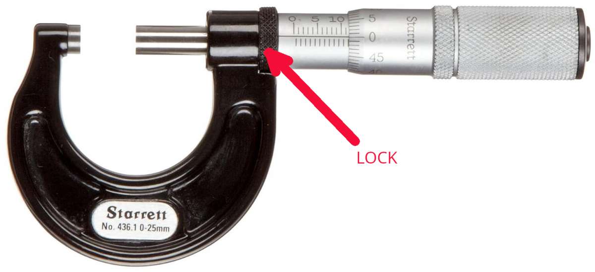

              Jason is right I think, John has one of these:
              starrett
              Many prefer ratchet-less micrometers, but the operator has to develop a consistent feel, which is harder to do than get consistency from a ratchet spring.   Unfortunately, a ratchet may be less accurate than an operator with a good feel, achieved by lots of practice.
              The stiffness may simply be due to the locking ring being applied.   It’s a brake, used to hold the micrometer at a particular setting for inspection type work.    Normally, the ring is rotated slightly to release the spindle, allowing it to be turned to take measurements.

                The one pictured is the friction Thimble type. The number given by John, should have a clicker ratchet on the end.
                Either the part number is not correct or he has been given the friction thimble type. The only solid type for Starrett micrometers that I am aware of, is the ones that have a dial gauge on the end of the anvil end. Also called indicator micrometers.

                  Thanks all for the replies.
                  Once I had identified and released the locking ring – thanks SoD – I could easily turn the measuring barrel, and it turns out that my micrometer does have a torque limiter. But it is not an external clicker sticking out the end; it is the longer knurled cylinder around the barrel in SoD’s photo – which is of my exact model – and there is no clicking, so it must be a friction type. I actually prefer it.
                  So I am up and running. Sorry, I realise this is very basic stuff !

                        John, just out of interest, what paperwork & other stuff comes in the box with the Starrett.?

                                  Knowing what I now know from you guys; the leaflet does show both the locking ring and the friction barrel. However, from its location, I assumed that the locking ring was for adjusting the micrometer zero point and I didn’t want to disturb that. I was not aware that micrometers had locking mechanisms for the measurement barrel. The diagram clearly shows a ratchet thimble at the end of the barrel, which mine does not have. So I was thrown into confusion with an apparently jammed barrel that had no ratchet thimble.
