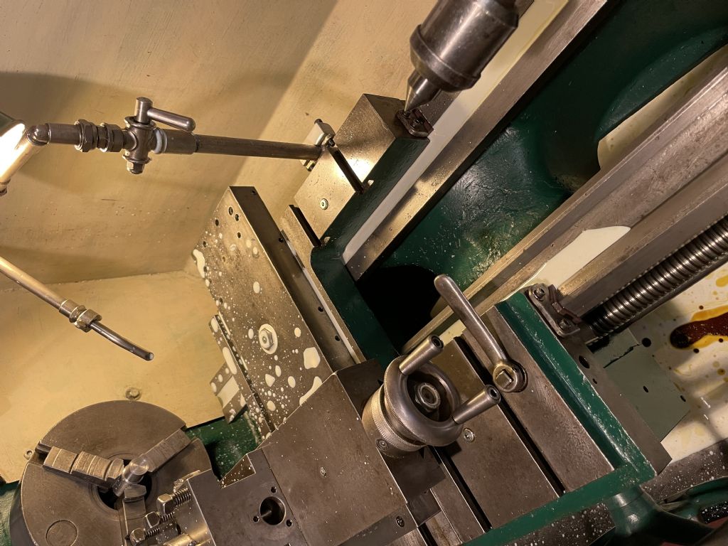

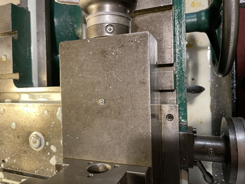

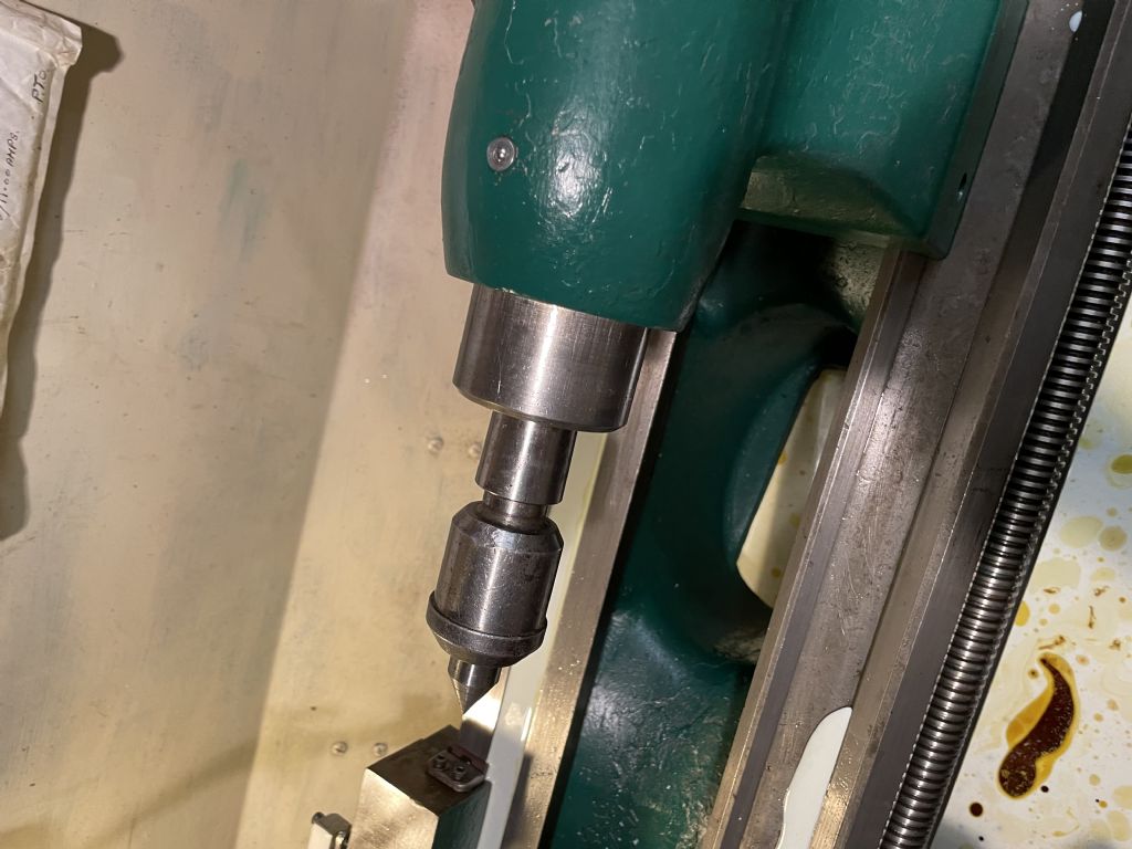

              I'll attach a couple of pics I snapped – stupidly didn't get any good shots of the ways although you can sort of make them out in a couple of pics.

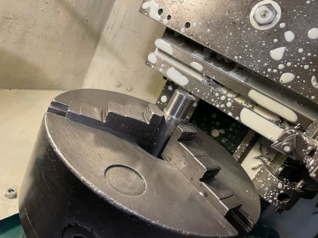

                A couple of thou cut with a worn insert would not have been the ideal test. Better to take a decent cut with one and a lighter with some HSS.
                Try to see it running in all gears under load and also with the power feeds to check they work and there are no nasty noises.

                  Shot of the turned down rod – couple of points on this:
                  It was turned down twice, the first go left a pretty rough finish with the carbide tip. I asked if it was possible to achieve a better finish and he swapped the tip around and tried with a different point – this did leave a slightly smoother finish but on that run a small groove appeared which is visible in the shot. Such a visible groove didn't appear in the first turning.
                  He then demonstrated polishing the piece with a bit of sandpaper and emory – the shot shows the rod after polishing – unfortunately don't have a pic of it prior to polishing.

                      A lathe like that should easily manage that finish straight off the tool.
                      While I have, and like, a WM250, in your circumstances I would buy the Colchester.

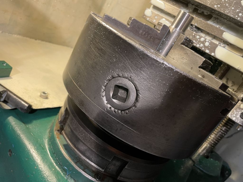

                                I've been a turner since 1975, but I'd only buy an older lathe if I'd had the chance to test it properly, especially as the chuck has obviously suffered some unknown but heavy trauma around the key square.
                                If you don't know lathes well, I'd say the safer option is to buy new.
                                I too have a Warco WM250V, and for the work I do – which is of small to moderate size – I don't think it's easily bettered.

                                  Thanks Mick – I think those marks around that key square are deliberate to mark it.
                                  The current owner mentioned boring out the 3 jaw chuck when he got it to take a slight taper out – and using that key square specifically whilst he was doing it – believe he marked it off and mentioned that he tried to always use that key square when changing out materials.
                                  I'll ask for more details when I pop over on Saturday.

                                        That Colchester might have been lightly used for the time the seller has known of it but it bears all the hallmarks of a machine that's been round the block a few times and down the motorway too.
                                        That chuck is almost certainly clapped out. If I had to guess I'd say that it's been heavily rusted and then brought back from the dead. The chisel and punch marks around the hole are where someoe has tried to shrink the hole so that the scroll driver doesn't flop about and bind up. The chuck is in dreadful condition so allow for buying a new one if you do end up with the lathe. You'd be just as well off with a 100 quid Indian jobbie from Vevor.
                                        Looking at the peck marks all over the compound top and saddle tops I'd say that it's done a good bit of factory or job shop work they are caused by the operator setting drills and reamers into taper adapters.
                                        Take someone with you who knows what they are looking at because if the spindle bearings are shot then you just added a grand to the cost and IMO even in great condition £2500 is too much money for that machine.
