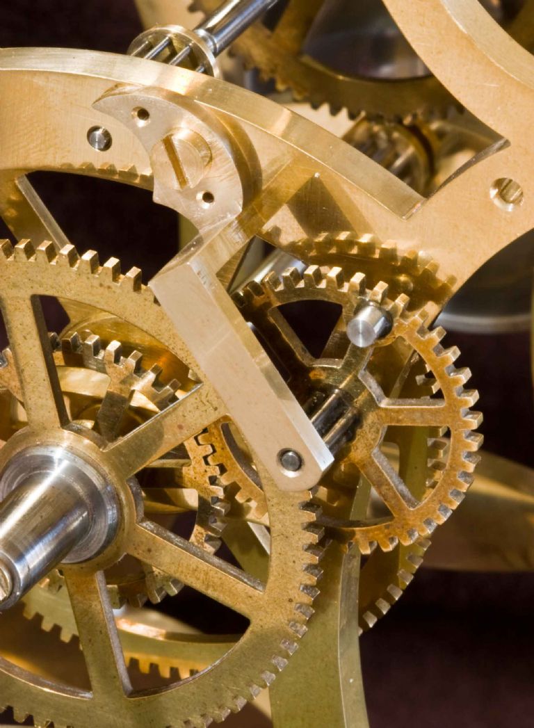

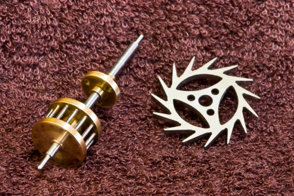

              Here's where I get shouted down, but …
              What's wrong with fly-cutters?
              It's likely that the teeth of the escapement wheel will need to be cut that way.
              Scape wheel & Arbor
              Apart from the lantern pinions, that's how I cut all the gears for John Stevens skeleton clock, including the six-leafed pinion.
              The teeth may not look pretty under magnification, and they certainly don't conform to any particular standard.
              The Hour & Minute Wheels
              The `proof in the pudding' is that the clock has been running since 2011.
              Regards to all,
              Sam

                  #232218
                  Russell Eberhardt
                    @russelleberhardt48058
                    That's interesting Sam. You can of course make fly cutters that produce a good approximation to the cycloidal tooth form but you have proved that it is not really necessary.
                    The cycloidal form minimises the friction but in a well made clock what is the biggest source of friction? I think it is a toss-up between the escapement and the friction in the pendulum suspension and air resistance.
                    Russell.

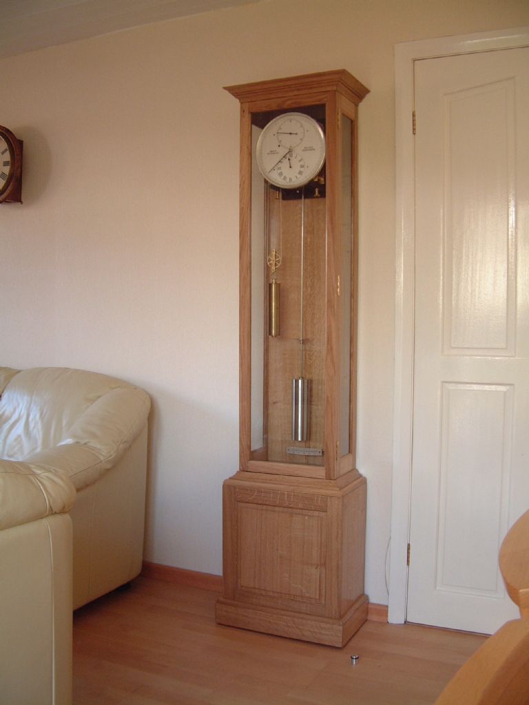

                    Brian H
                      @brianh50089
                      English Reg Clock Case
                      English Reg Clock
                      Edited By Brian Hutchings on 29/03/2016 10:12:24
                      My first clock was John Wildings English Regulator clock. I intended making the case myself but I'm no woodworker so I contacted a cabinet maker in Cromford, Derbyshire who made one out of light oak.
                      Edited By Brian Hutchings on 29/03/2016 10:15:13

                                                      Posted by Brian Hutchings on 29/03/2016 10:11:28:My first clock was John Wildings English Regulator clock. I intended making the case myself but I'm no woodworker so I contacted a cabinet maker in Cromford, Derbyshire who made one out of light oak.
                                                      Nice looking clock Brian. I have recently completed the month going version and am in the process of making the case. Metalwork is much easier though!
                                                      Russell.
