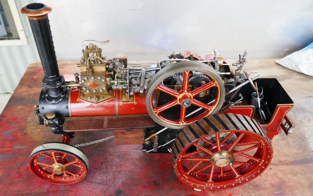

      A member of our club (full size steam engines) has purchased a 1" Minnie traction engine and had trouble raising steam . (The previous owner had only run it on air). We tried a number of different types of wood, pine, old hardwood, BBQ fire lighter tabs, soaked wood in kerosene (parafin) but the fire kept going out.
      Tried elevating the front wheels and extended the chimney to get a better draft. He did not have a blower to create a forced draft, which could solve his problem.
      Does anyone have any experience with fireing a minniature traction engine ?

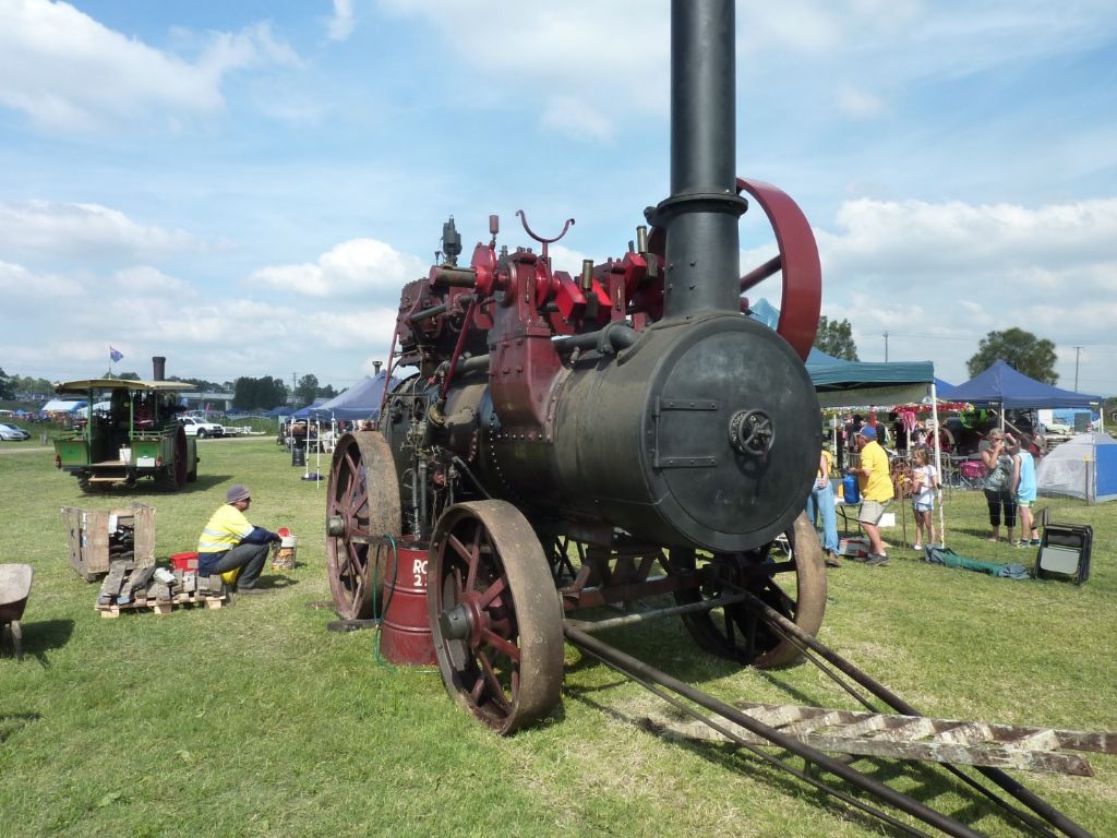

            I have no problem with full size traction engines and my 6" Ruston Proctor. I can fire it with kindling only but normally use an electric blower and have steam in about 40 minutes.

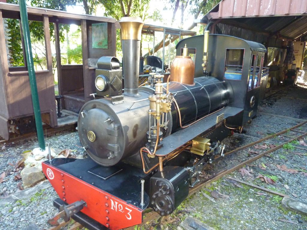

                                    A friend of mine has a home railway with 7-1/4" locos and uses old computer fans to fire the engines. They get covered in soot which has to be shaken off and they have to be replaced on a regular basis.

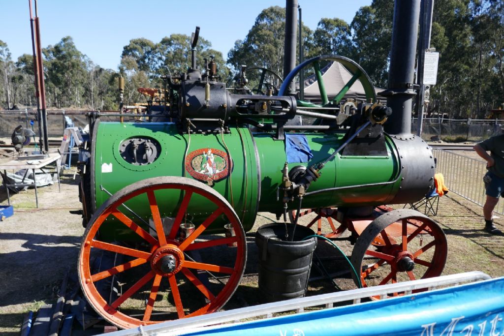

                                    The mechanical water pump is normally driven from the crankshaft or layshaft, which on a traction engine is near the hornplates at the rear end of the boiler but on a portable steam engine, the crankshaft is at the front of the boiler as on this Marshall Britannia at our club.
                                    Mechanical pumps are not affected by hot water and some engines have heat exchangers that use steam to pre-heat the water before it is pumped into the boiler. Others have water tanks mounted on the side of the boiler to capture heat.
