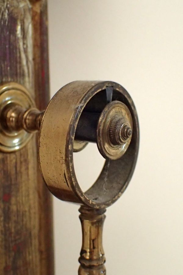

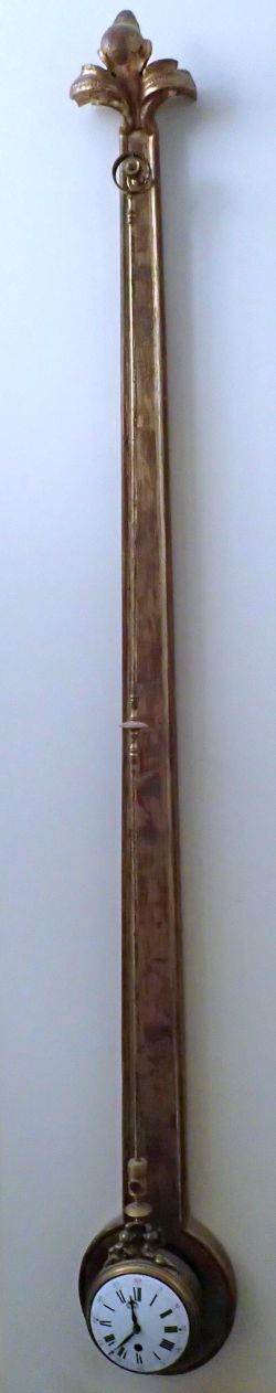

            Peter Cook 6
              @petercook6
              Knife edge suspensions are a bit more common on French clocks, not necessarily precision ones. And they do seem to last fairly well.
              This is a French clock dated to about 1790 which is suspended from a knife edge suspension at the top. The whole clock acts as the pendulum. The suspension is ( I think) steel on steel.
