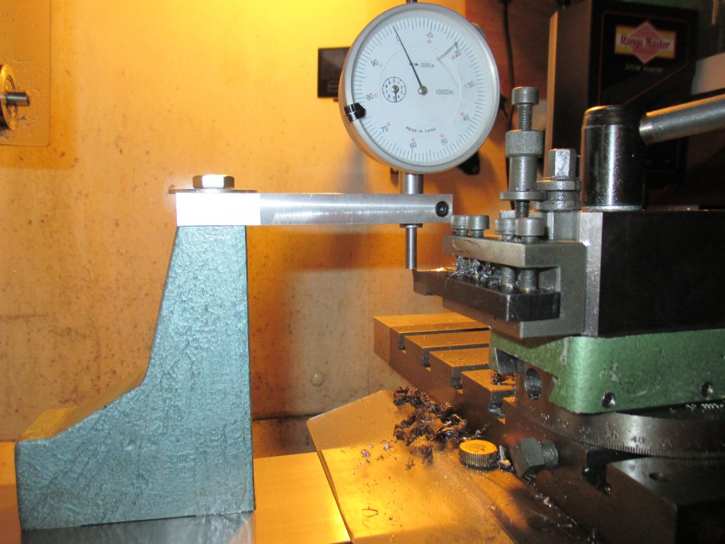

            Douglas Johnston
              @douglasjohnston98463
              img_0474.jpgThis is a device I made some time ago from some bits from the scrap box. The dial gauge is set to the correct height and zeroed and then used to set the correct height for any tool in a quick change toolholder. The plunger on the gauge needs to have a flat foot.

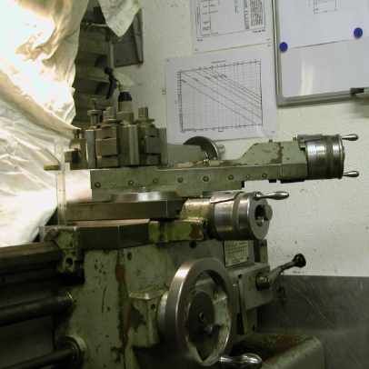

                Clive Foster
                  @clivefoster55965
                  I like the "optical" type of centre height gauge comprising a sheet of decently thick perspex held vertically up right on a suitable base able to sit on the lathe bed and, if the top is flat, cross-slide.
                  Using a sharp centre lines can be scribed on both sides directly on the machine so they must be accurate. Needs a bit of thought to arrange a stepped down bridge across the centre of the bed to slide the base on for marking but its not intrinsically difficult. Keep the bridge because its useful for getting the gauge into more places.
                  With lines bot side of the transparent sheet you can reliably eye up the tool centre height from all sorts of distances. So long as you only see one line you must be looking at it level. Out of level wyou will see two. So if the tool tip alings with one visble line it must be on center.
                  Sitting a mirror behind at 45° allows you to look down rather than across. Or just use it as a plain line gauge by touching the tip of the tool (gently!) to one side.
                  A desigg was published in the early days of MEW. I modified it to suit my machine. Mine has grown several sets of lines to suit two machines but it works very well. Blade is thinner than ideal at 5mm, 10 would have been better, but I used what I had. If I ever luck into a suitable off cut of 10 mm perspex sheet I shall rebuild it.
                  Mine with mirror.
                  Using the mirror.
                  On the S&B 1024.
                  I really should do some better pictures but its hard to photograph transparent things.
                  If I still used a 4 way tollpost with shims to set tool height something like the dial gauge arrangement Douglas uses would be great. Measure the the height with no shims in and select from your carefully sorted set. No reaon you couldn't do the measurements on the bench using a bare tool.
                  Clive

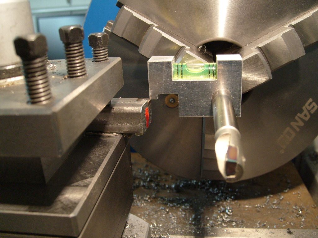

                            Huub
                              @huub
                              I use a level for setting/checking. That gives a centre height within 0.1 mm. After that, I face a bar and check the pip is turned, not broken off.
                              My level:
