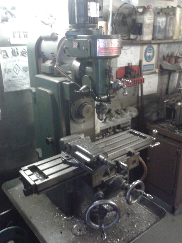

      Today me & a mate went to pick up the dismantled Tom Senior. It took us a couple of hours to put the main parts back together. God it was heavy, or am i getting too old for this, ??
      Another 2 hours refitting the controls & DRO. Runs lovely & i am well pleased with it. It is old but in pretty good condition ,apart from there is quite a bit of back lash on the Y axis screw. I does not matter as with the DRO it isn't a problem.
      But i will at some point strip & see what the problem is. Probably the Nut & Screw. Could be a nice project & some machining to fit ballscrew type. I did some fine cuts on some mild steel & it came out very good.
      Although i have not trammed it in yet. A job for tomorrow.

          Lovely looking machine. Yes if you are talking drill chucks for drilling not milling then it's ok without a drawbar – just like you would in a normal pillar drill.

              My Centec has a captive drawbar; I don't know about your new toy.
              If it is similar, then the bottom end of the drawbar will preclude the use of a plain shanked drill chuck arbor.
              I just set up in the lathe and drilled the ends of my arbors and tapped 3/8" BSW. (Your's of course my be a different thread.)

                Well big it is not really. The whole thing weighs 370kg. The guy in Barnsley that I bought it from has just bought a Bridgeport to replace this one. It was adjacent in the garage.
                The Bridgeport was like the big Daddy bear & this one was baby bear. Really. It is a bit bigger than some of the small Chinese mills for sale admitted. Maybe on a par with a Sieg SX4. Just not as modern.
                I was recommended it by quite a few members on here after I was, just about refused to be allowed to buy a Sieg something SX3.5 twin turbo. When I went to see it I was pretty much blown away.
                A bit like a time machine. As it looked brand new, I could only assume it's previous owners had taken pride in ownership. Expensive. No I do not think it was silly money at £1500. Beautifully made machine, as a few members had already told me about them. Strange that I had never even heard of a Tom Senior & they were made just a stones throw from me. I think the company went bust around 1980. Having traded since the early pre war days. At a place known as the Atlas works in Liversidge near Halifax. Yorkshire. It has the full M-DRO 3 axis. Also it has an expensive Toshiba inverter & 3 phase motor. The DRO kit alone is £540 . The Toshiba inverter is around the £400 mark. So basically got the machine for peanuts. I am looking forward to using it . I need to build the wall in the garage now it is in place. Took some lifting but worth it.

                  Ah thanks for that Bill. I will have a look in the morning, it has a Er collet chuck kit on at the moment with the drawbar. I have not removed it,. So I will make sure the bar comes out. If not then as you say I will have to machine or cut the peg off the MT2 chuck & then drill & tap to accept the bar. Regards.

                    Or just change one of the chuck arbors for one with a hole for a drawbar.

                      You can change the arbour for the drill chucks to work with your draw bar or get an adapter that fits your chuck taper usually a JT to a parallel shank that you can use in your ER collet chuck so you don't need to remove it but it will reduce your z height a lot .

                                You can of course always hold drills in the ER collet chuck, saves keep changing chucks!

                                              It allows you to use the drill chuck for drilling without the tang hitting the captive drawbar that was mentioned. The new internally threaded arbor will be drawn into the taper by the drawbar so won't break and the JT or B taper will hold just the same as any other for drilling.

                                                    Slight drawback with keyless chuck is that you can't use them to hold taps as they come loose when you back the tap up! For everything else they are great and muck easier than the keyed variety.

                                                      If you use standard tanged MT2 drill chucks, then a plain rod of 3/8" diameter can be used to extract using a copper hammer. As for collets, I would recommend an er25 with the MT2 shank. You can easily get a length of 10mm studding and nuts to make a drawbar for it. The er25 holds up to 16mm end mills and slot drills. For shell mills, an arbor of 22mm diameter for MT2 and it is possible to get 40mm shell mills holding four APMT 11 inserts. 50mm shell mills are more common, but may be a bit big for MT2.
