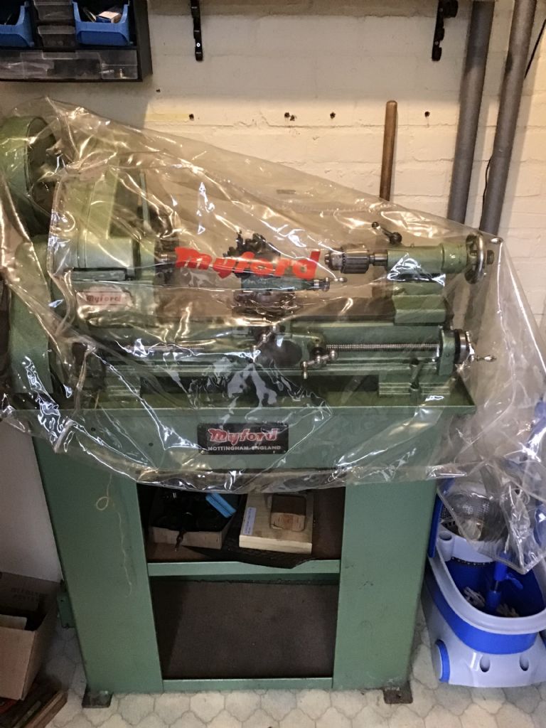

          Collected lathe today, is it heavy or what but got it In it’s cubbyhole, need to level and bolt it down but had enough today, it’s a pain getting old ( or should that be older ), I think the cover is for a larger Myford, I was and am happy with the Pultra but lots of tools I want to make I can’t do on the Pultra.

                    Purchased this collet chuck made by Myford but to take ER 25 collets, just need to get a semi decent set of collets, I know there are literally 100’s out there but for what I do ( clocks ) I can’t justify spending 100’s£ but I don’t want Chinese ones so if anyone has any suggestions it would be much appreciated, I know it’s possible to get Myford collets but they are one size collets whereas ER will hold in between size stock albeit not quite so accurately.
                    Dell66901a15-3aec-4a16-82a3-9c007383b1f8.jpeg87a6f934-613b-453c-90c3-e1a7c9e831a0.jpeg

                              Posted by Dell on 12/02/2023 14:38:44:
                              I can't speak for ER25 – I only use the set I have in Stevenson blocks for work holding. However I have bought ER16 collets from both ARC and CTC tools. My ARC set are quoted as 0.008mm but I only got the standard (0.0015 ) tolerance set from CTC tools, but both sets work well and are more accurate than the specs.
                              I suspect both sets are Chinese (the CTC ones certainly are) , but I would have no quibble with either set. CTC quote their imperial ER25 set as 0.0006" Run-Out Tolerance, and do more precise ones in metric quoting 0.008mm (0.0003"  ).
                              One trick I have used is when trying to hold short lengths of material, is to put a same sized bar in the back of the collet. I often use a suitable drill shank.
                              Edited to remove random smiley!!
                              Edited By Peter Cook 6 on 12/02/2023 18:37:41

                                  I have the identical chuck bought about a year ago and is a revelation compared to my previous one and as far as accuracy is concerned its a damned site better than I am!

                                    Posted by bernard towers on 12/02/2023 18:55:20:
                                    That’s good to know Bernard thanks
                                    sorry Robert I mentioned it to a friend as well and he bought the last one.
                                    someone on another forum mentioned apt they have a set quoting maximum run out of 0.005mm for £80 odd so that seems a good deal because cutwell are saying £185 quoting same.

                                      ER (Extended Range ) collets are useful since one collet can hold Metric or Imperial items of that nominal size.
                                      Concentricity is improved by tightening as much as possible.
                                      Fixed size collets can be damaged if used to grip anything other than the proper size. ER are more flexible, being slit from both ends. Although one size Direct in the Spindle collets can be useful especially in the Mill, if headroom is tight.
                                      I use ER25 most of the time, very occasionally ER32 for a few larger sizes, and ER20 to hold drills for four facet grinding on the cutter grinder.
                                      Made holders for use on a sliding Tailstock Tap holder, and for square and hexagon bases on the mill (About the same time that John Stevenson launched his! )

                                        Received the ER 25 collet chuck checked runout just short 1 thou , tangential tool holders finally arrived from Australia , just waiting for Multifix from PeWe tools now , the QCTP that is on it is next to useless, can’t get the tool on centre although I probably would with 6mm tooling .

                                          Not sure I got the runout correct I said the collet chuck had just short of 1 thou runout ( above ) but that was using my verdict gauge and I just noticed that my other gauge was 1 thou increments and I thought the verdict was the same but it’s not it is 0.0005” I think that’s 1/2 thou if so the runout is just less than 1/2 thou.
                                          please correct me if I am wrong.
