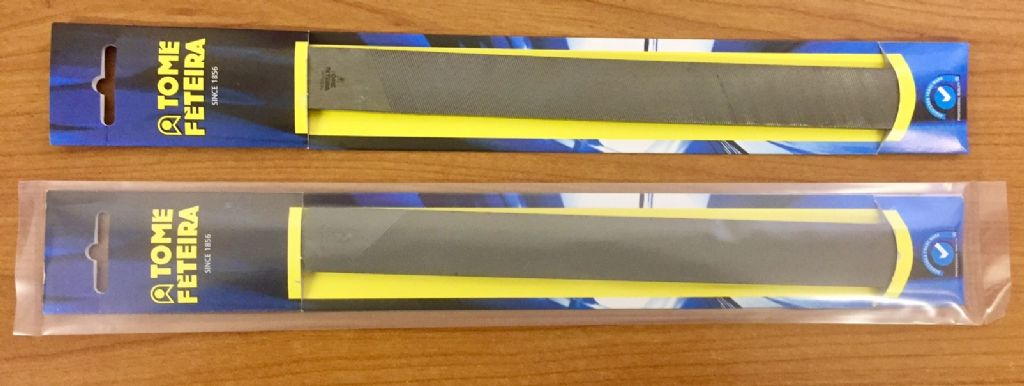

        How were they packed when delivered?
        Hi KWIL,
        We get Tome to pack the standard files – each in a cardboard sleeve. When we get them, we pack them – each in a plastic sleeve (lay flat tube), to try and protect them in transit. Bubble wrap or bubble bag may be added for outer packing as necessary. Picture below:

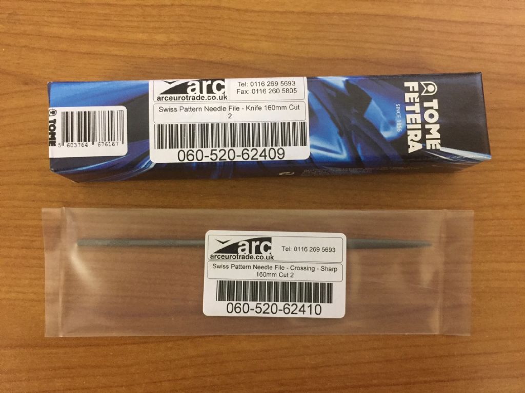

        The swiss pattern needle files come to us in packs of 12 per cut. We remove them and re-pack them, each in a plastic sleeve.:
