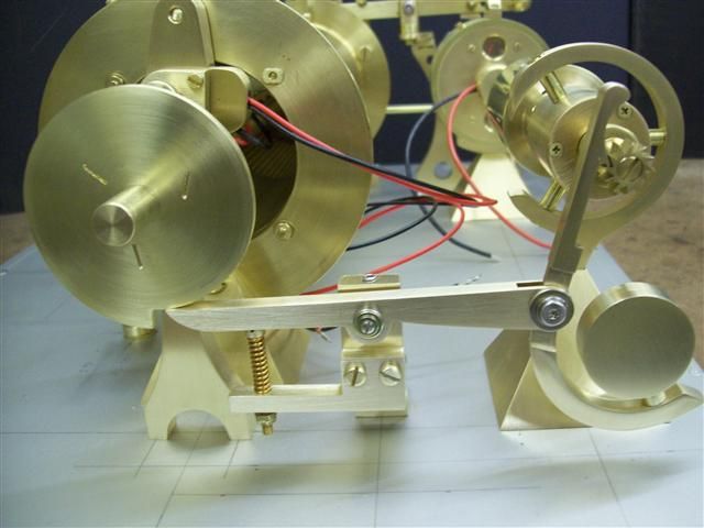

                      There would appear to be a bit of interest so here are the latest bits. The first pic shows that i have now fitted the lever from the motor to the ratchet on the min's cylinder. Motor end of clockThe next one shows the mount for the LED unit.this shows the mount for the LED unit
                      Just to show how it will work
                      Next one has the bar that will hold the fibres with one fibre in place, the other end of the fibre is shown in a piece of black perspex to give some idea of the effect i am trying to achieve.
                      Cheers Derek.

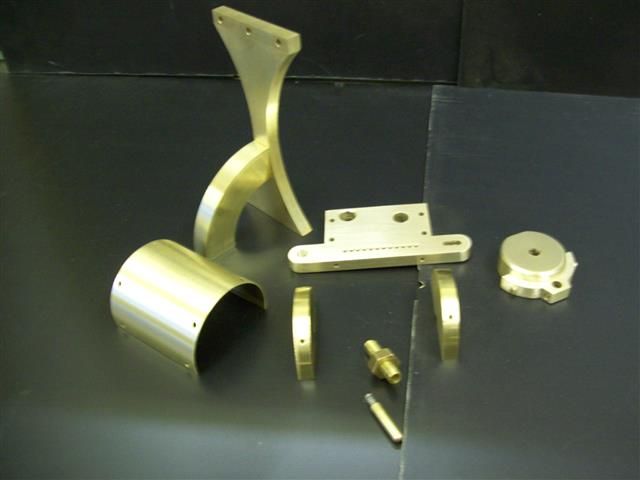

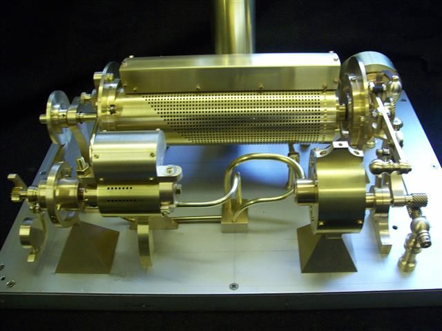

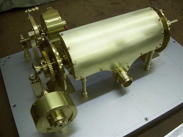

                                  Front viewEnd view.Rear view of mechanismCarrier.Thanks for all the kind comments gents. Weeeell you asked for it !!!! so here are a few more pics of the thing to date.
                                  Sub assy bits
                                  No matter what i try, posts that have pics never come out the way i intended. These are all in the wrong order, still you get the picture ( pun intended ) i suppose.
                                  Cheers Derek.

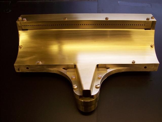

                                                    Top view.Bits for hours unit
                                                    Front view of allmost complete mechanism.
                                                    Hours unit.Got a bit more done at the clock folks so here are a few more pics. The hours unit first in bits, then assembled with a few fibres in to test. The piece of black perspex to the right has a fibre in the top right hand corner to show how they will look when on the clock face, allthough it's not very bright in the pic because LED's are running under voltage. A few pics of the allmost finished mechanism, and one with the face framework in place. This is a very distorted view which seems to show the frame much bigger than it realy is. Hope you like it.
                                                    Cheers Derek.
                                                    With the face frame in place.
                                                    Edited By magpie on 09/03/2013 15:55:38
