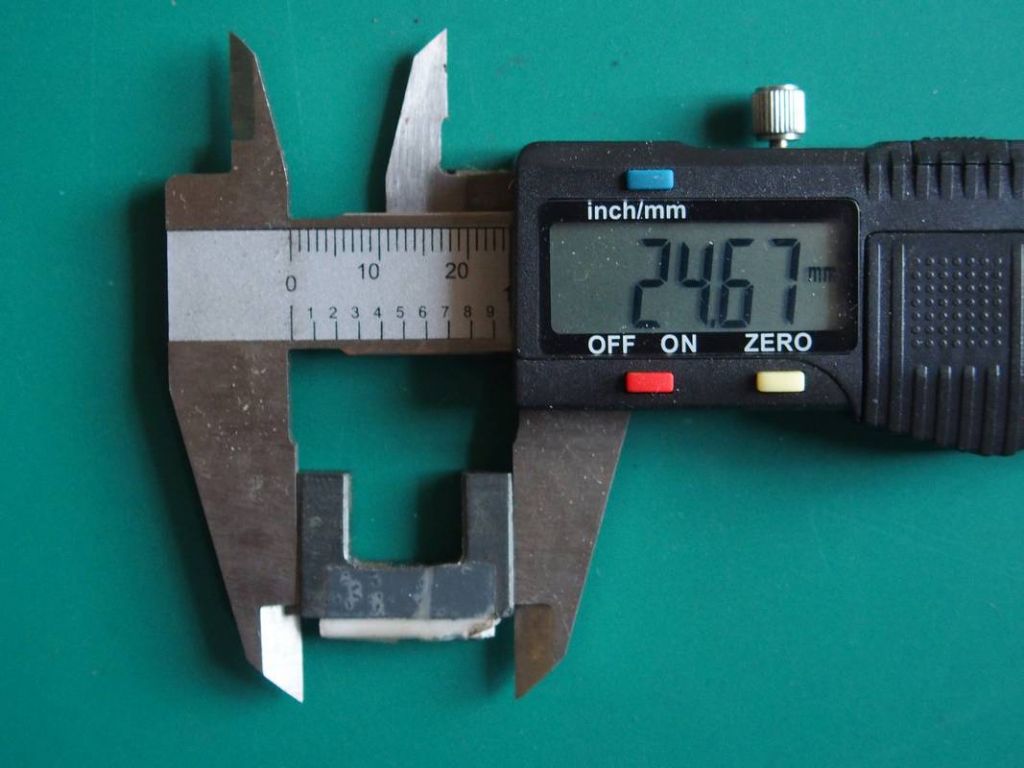

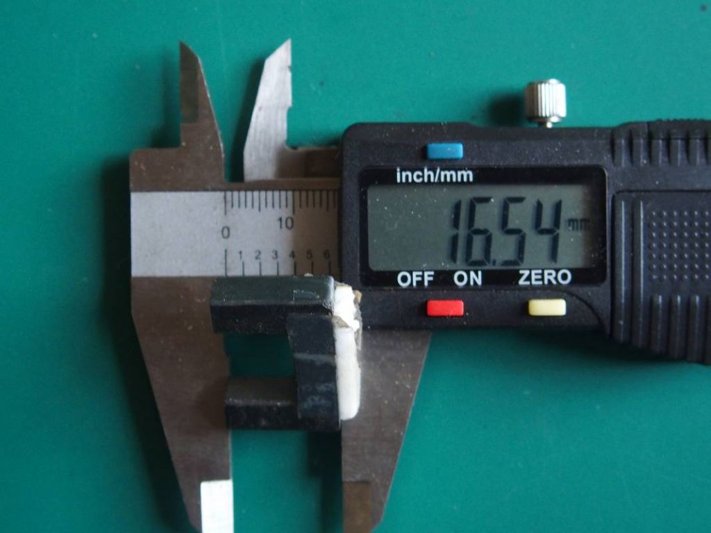

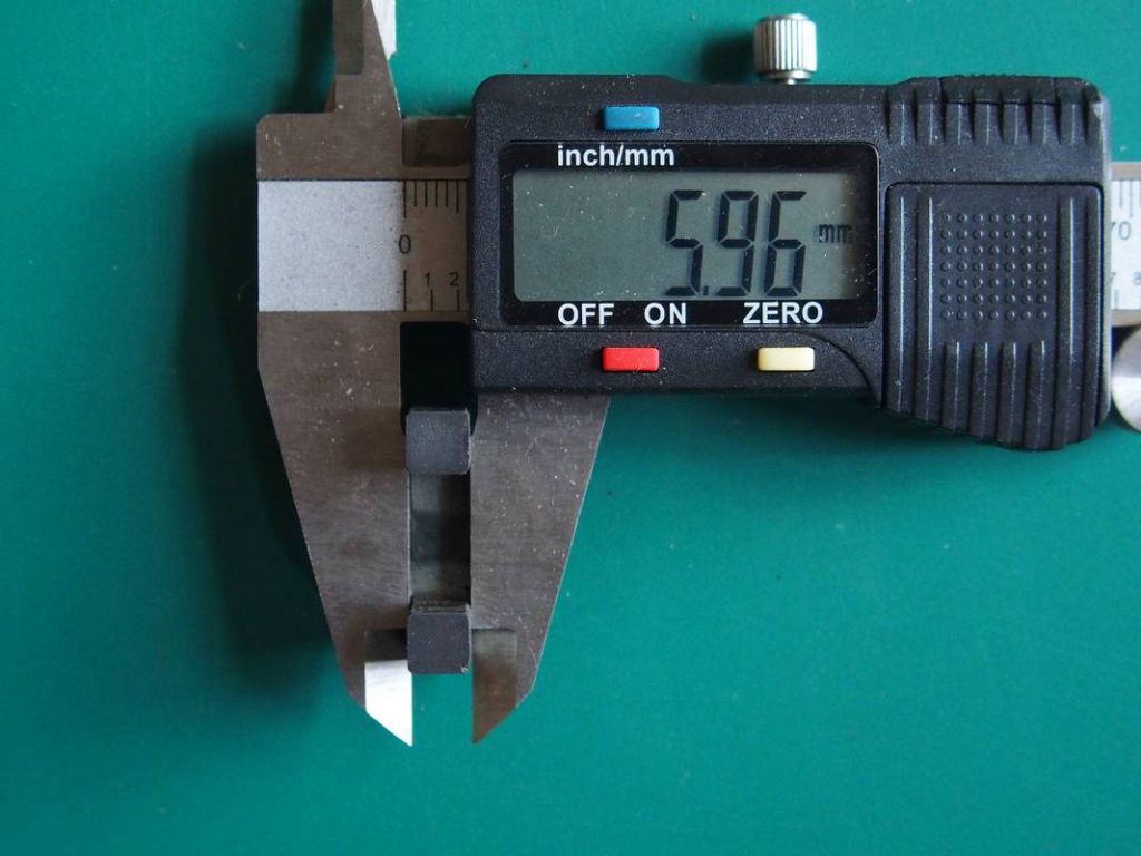

      I have a Gunson Superstrobe timing light for the car, but the ferrite ring on the HT pickup is cracked, so obviously doesn't work any more.
      It's a square U shape and square cross section, as per the attached photos.
      There is a sliding cover with a bar ferrite encapsulated to complete the magnetic circuit, and a coil round one leg of the U. I did try using a slice out of a round ferrite ring, but can't get it to work.
      Anyone any thoughts for a supplier please?
      I did contact Gunson, who put me in touch with their spares supplier, who in turn would only quote for a full replacement lead; Can't remember the exact price, but it was north of £50. surprise
      The U shape is dimensioned as follows;
      i.e. approx 6mm x section, 16.5mm high, & 25mm wide
      Edited By peak4 on 18/03/2016 12:44:03

                  Have you tried gluing the broken one together?
                  I would expect that if the two faces were in good contact (a miniscule glueline) that it would work as well as it originally did.

                      Have you checked that the winding has not been damaged. Check with a meter that it is not open circuit. If the original core is stuck togeter with superglue or a THIN film of araldite I think it should work. I did a search on ebay for "ferrite transformer core U" and found this current transformer that may do the job. When I built one many years ago I just used a ferrite ring and it worked.

                        As suggested, you should just glue it together again. As long as no significant fragments got lost and you don't make a large gap anywhere, it should work just fine. For production, these are generally glued together with cyanoacrylate or epoxy adhesives, the former often with an activator to make it "go off".
                        If you don't want to try that but can find a core of the correct physical dimensions, you shouldn't need to worry too much about the magnetic properties. As long as it's ferrite, rather than eg powder core I'm sure it will work fine.
