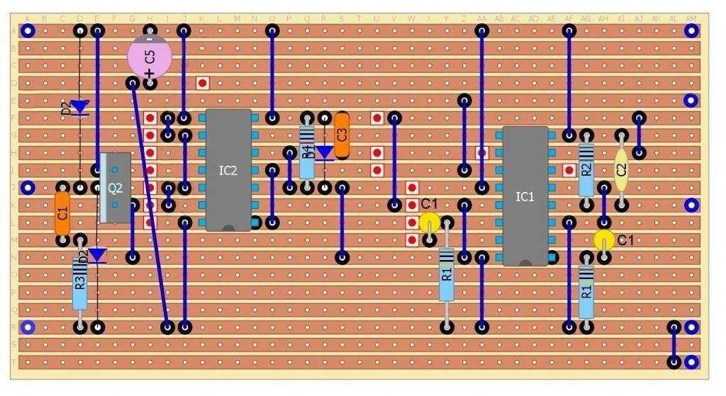

      Electronic Control Board
      I'm having problems comming to grips with the electronics, as I feel some of the hole numbering are conflicting.
      16 pin socket – 31:14, 31:7 & 27:7, 27:7 should this read 32:14. 32:7 & 27:14, 27:7?
      Resistor 10K – 17:6, 17:10 – 17:10 is also the same as a link at 17:10?
      Capacitor 0.01 – 16:6, 16:8 is also the same as a link at 16:8?
      To cut track at 8:11 is also the same as link 8:11 does one cut the track at each side of the hole?
      I would appreciate if anyone can advise me how I should proceed???

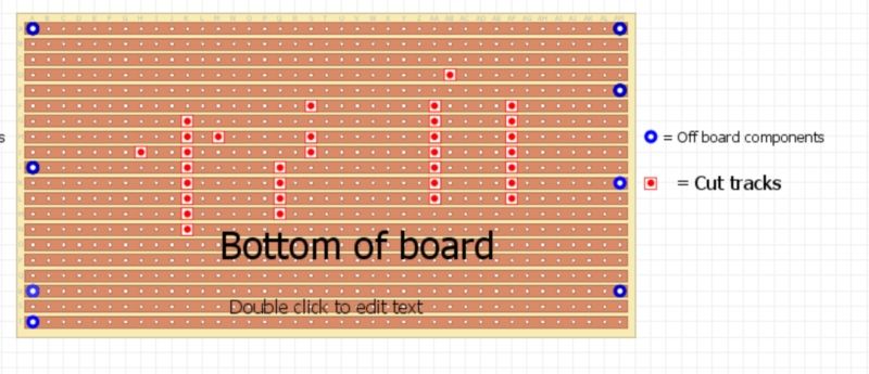

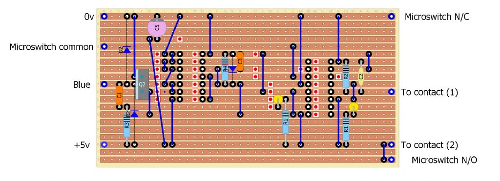

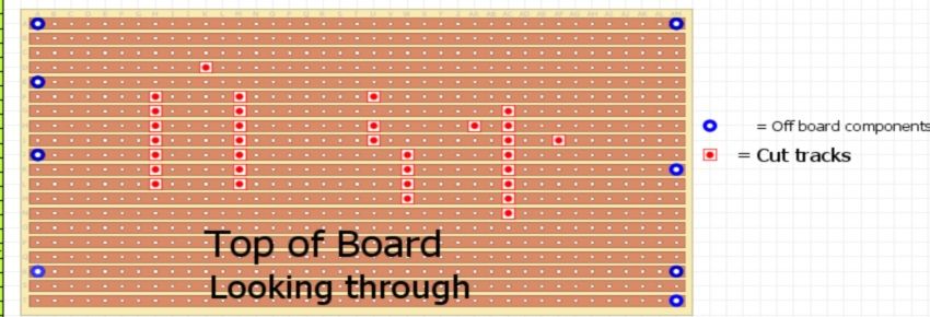

              I had a bit of spare time today so i drew the board up for you i moved a few components to tidy the board up and to avoid the clashes with the hole numbering, if the posted images are not clear enough i can email a pdf of the images which is clearer
              Regards
              Dazz

                Bottom one simply shows component placement
                Second image is with the connections labled
                First image is looking at the bottom of the board where you need to cut tracks
                Third image is as if you were looking through the board from the top
                This circuit was drawn from the articles doiwnloaded from this site (pdf 12) so may need tweaking if its been updated in a later edition
                Regards
                Dazz

                    Hi Neal,
                    after downloading the pdf file12
                    I see the circuit shows the microswitch common terminal connected to +5V
                    instead of the 4528 input pin 11 (as shown the switch will short circuit the 5V supply)
                    another correction I'd make would be to connecting pins 8 , 9 12 & 13 of the 4011
                    to either 0V or +5V as the inputs of the unused Nand gates should not be left "floating" at an undefind logic level

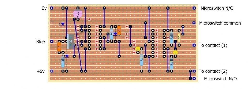

                        Hi Martin email on route
                        added two photos incorporating John Swift's suggestions
                        For those interested the software i used for the layout can be found here **LINK** its free and constrantly being developed
                        Regards
                        Dazz

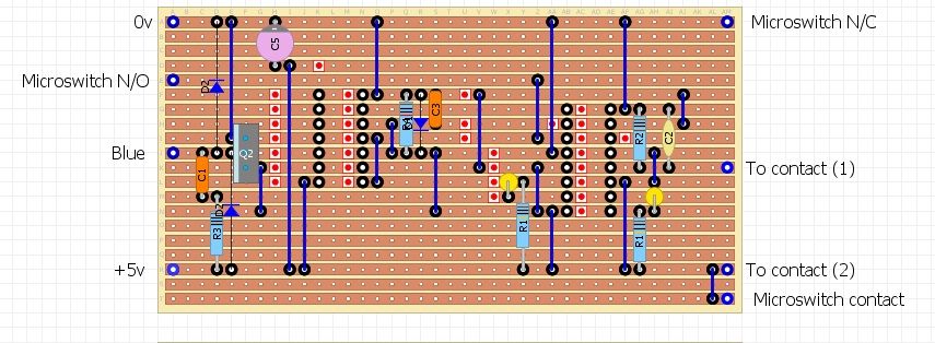

                          Hi Dazz
                          I've made two changes to you diagrams
                          first change to break the connection to the 4011 pin 10 (the output of a unused nand gate)
                          the second change is to connect the cathode of the two SBYV 27 -200 diodes to the positive
                          side of the circuit so they don't short circuit the 5V supply

                            Cheers John
                            i was looking at it and missed that one with the diodes many thanks for the correction
