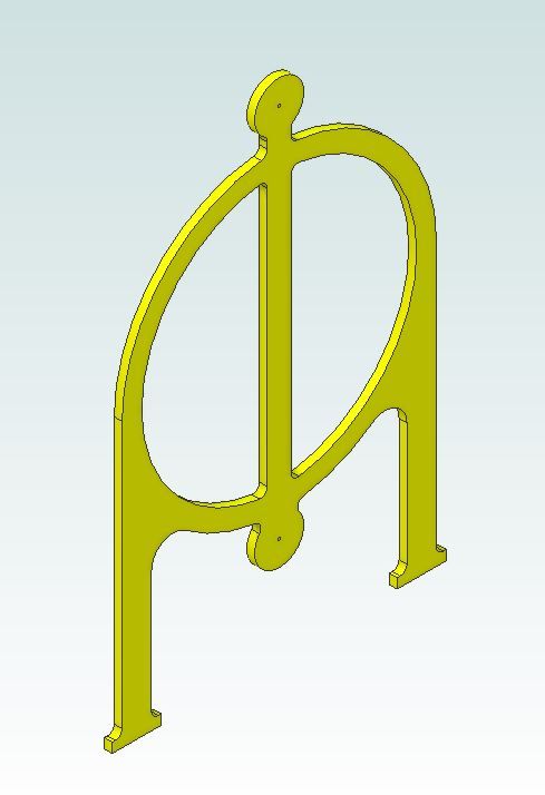

                                            #634719
                                            Mason Green
                                              @masongreen60104
                                              Hello,
                                              Does anyone have the DXF files for this project? Don't see them posted along with the PDF files.
                                              Mason
                                              #634723
                                                2/3rds down the list of pdf files there is a zip file with about 15 DXF files in it.
                                                #634763
                                                Mason Green
                                                  @masongreen60104
                                                  Those DXF files are for the magnetic clock rather than the ferris wheel, if I'm not mistaken.
                                                  Edited By Mason Green on 24/02/2023 13:04:42
                                                  #634775
                                                    Sorry so they are
                                                    Though the drawings are in the articles so not a great hardship to draw out any that you may want a DXF for, this took less than 5mins. Download from my Dropbox
                                                    #635179
                                                    Mason Green
                                                      @masongreen60104
                                                      Posted by JasonB on 24/02/2023 13:29:15:
                                                      Yes, I plan to create a model in Alibre CAD from the magazine drawings. Was hoping for the author's original DXF files to check my work, but no worries. Thank you!
