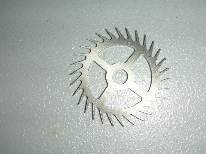

                                        #44744
                                        Martin
                                          @martin
                                          I have just finished machining the escapement wheel on a Chinese CNC mill.
                                          Material is Ti, 1mm dia endmill, 0.2mm cutting depth @ 30mm/min feed rate and lots of WD40 as a coolant media.
                                          I have posted some photo’s in ‘Martin Album’ if these all don’t appear in the post
                                          Martin
                                          #44746
                                          ColH
                                            @colh
                                            Hi Martin
                                            Did you do your own drawings to generate the CNC code or did you get Dick’s files?
                                            Is the finish of the mill good enough or do you need to hand finish?  Are you going to leave the corners round or square them up in the traditional manner?
                                            Col
                                            #44754
                                            Martin
                                              @martin
                                              Hi Col,
                                              Yes, I did the drawing in AutoCad, saved it as a dxf file then converted it to a tap file in BobCad, I run the G codes in Mach3 operating system for the CNC mill, then crossed my fingers and toes,
                                              I took very fine cuts to maintain a good surface finish, but I may cut another one with a higher spindle RPM (3200). I even thought about fixing a higher rpm spindle on the side of the miil to see how much better I can get it, I’m a little concerned about the rise in temparature when machining Ti. at high speed
                                              In regards to the radius corners, if I leave the dimensions as they are I may square them off, however I was considering making the whole thing thinner, if so, I will leave the corners to maintain some strength. Once the drawing is done it is quite simple to change bits as required.
                                              I don’t mind offering the file to anyone who would like it. hower I’m a self tort CNC hobbyist, so the file may not be the best, but it has done the job, also all care but no responsibility!!!
                                              Martin
