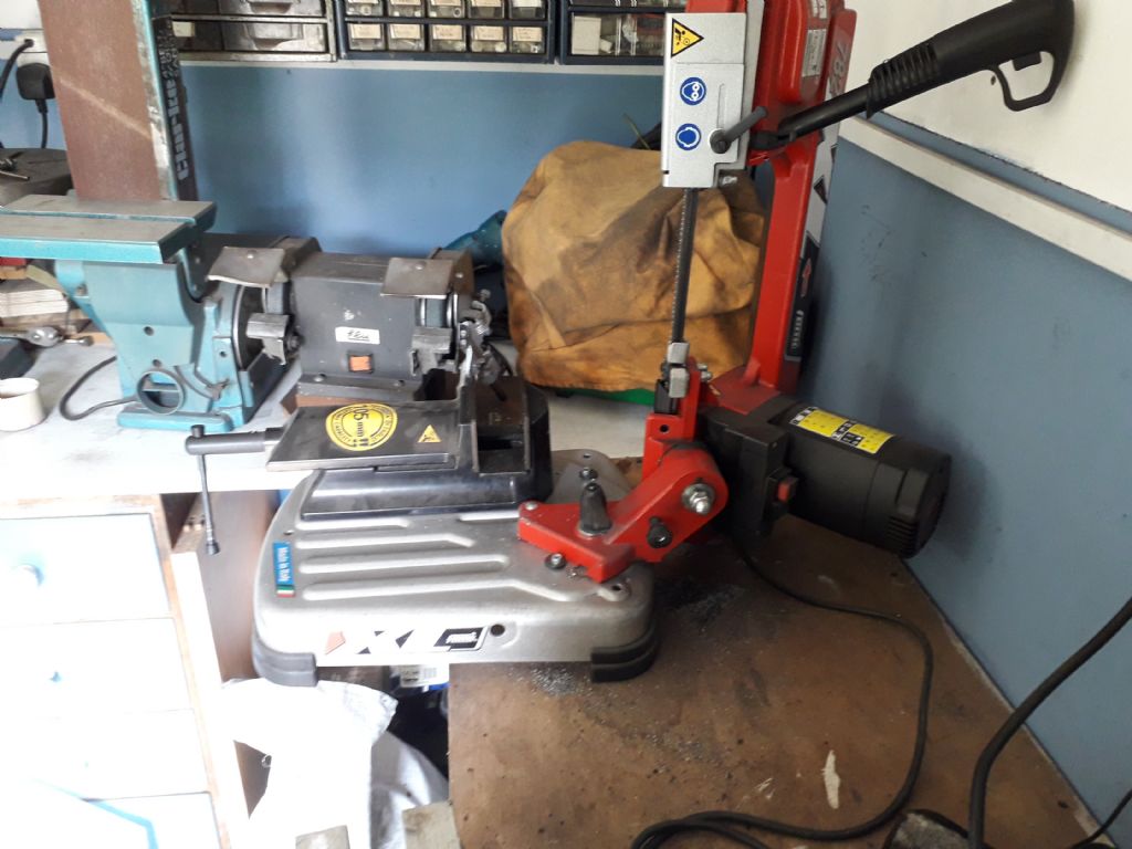

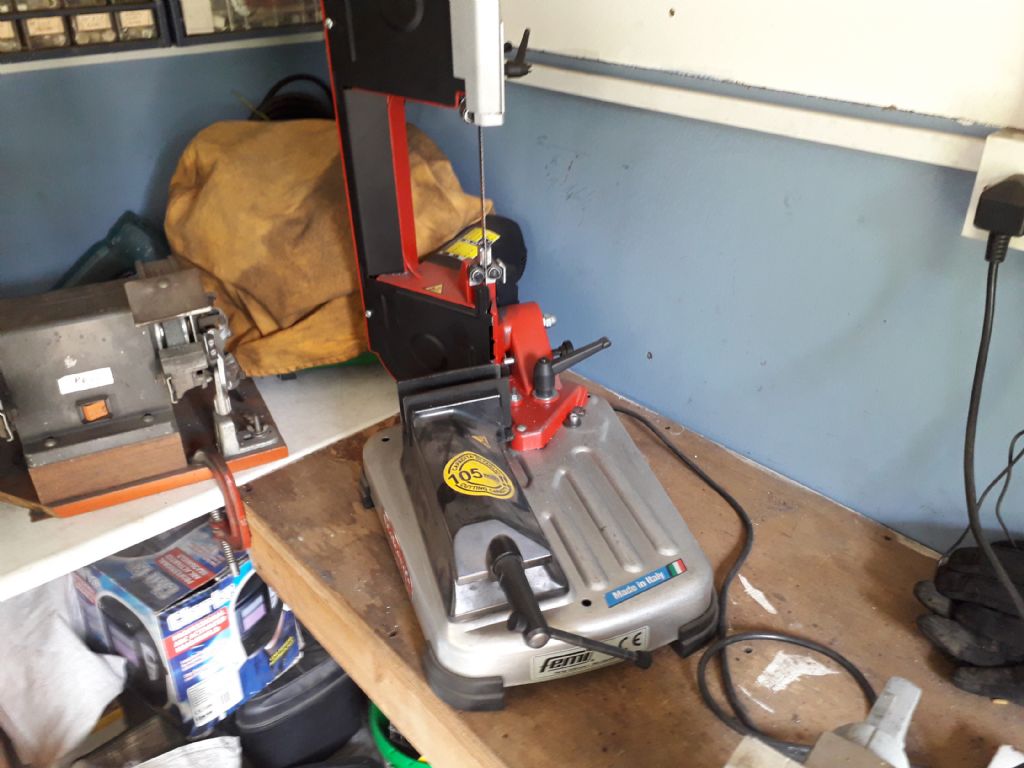

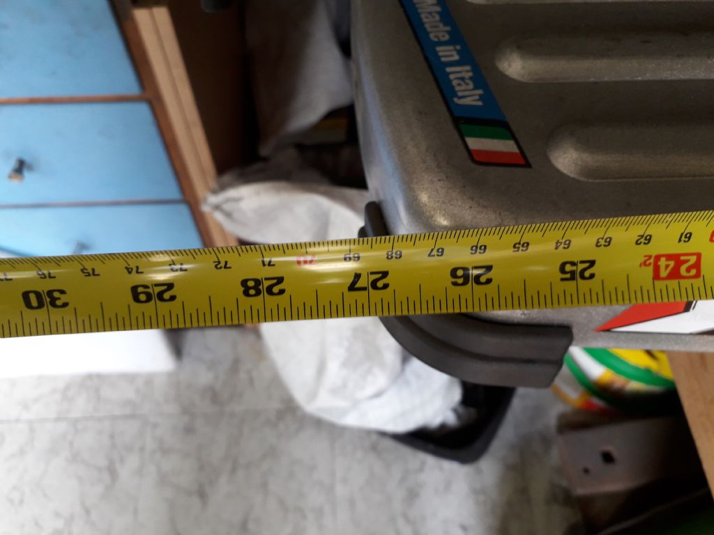

        Hello, I know a couple of people have bought one of these. I'm considering one and it would be useful to know by how much the handle and motor stick out at the rear when the saw is in its vertical position. Please could someone run a rule over it?
        Thanks, John.
        #479267
          If you want it sitting square on to the front of your bench then 690mm is tight, 700mm would be better.
          Mine tends to stay on a 500mm bench set at an angle which does for most things, easy to lift off if I want to cut something longer.

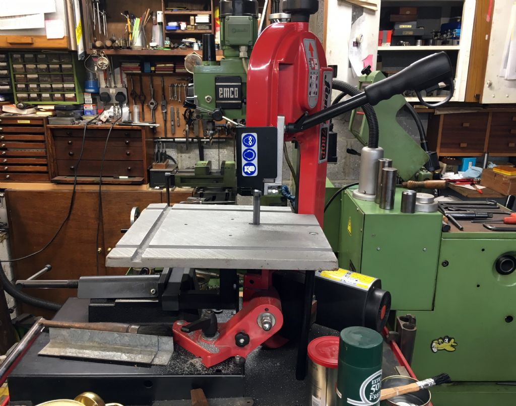

                Peter Ellis 5
                  @peterellis5
                  Brilliant saws and very precise. Recently finished making a horizontal table for it.
                  Digressing slightly, there have been discussions on holding small parts using a second vice clamped in the fitted vice. I made one myself. However, it struck me last week that a fixture plate is much more useful, particularly if you haven´t got a suitable spare vice. I used an 80mm wide piece of 6mm steel and drilled and tapped 6mm holes on it.
                  It can be gripped in the fitted vice, adjusted to suit and all my holding down bits off the mill, including V blocks, fit it. I can also use it on the mill. It seemed so obvious when I thought of it, but I had not seen one used on a bandsaw before.

                    Posted by John Haine on 12/06/2020 12:24:39:
                    Thanks Jason, just the job. Are you pleased with it? Do you have the horizontal table as well?
                    Hi John, here are a couple of photo's of mine and I do have the table, somewhere I have a sketch I did for another member to help them make one. They are quite expensive for what they are and fairly easy to make one, if you want the sketch PM me with your email — isa a pdf doc I think so cannot load it on here.

                        JohnF
                          @johnf59703
                          Hi, I have added some more photos and jpg of the simple hand drawn sketch to assist construction for anyone who is interested — see here Femi Album
