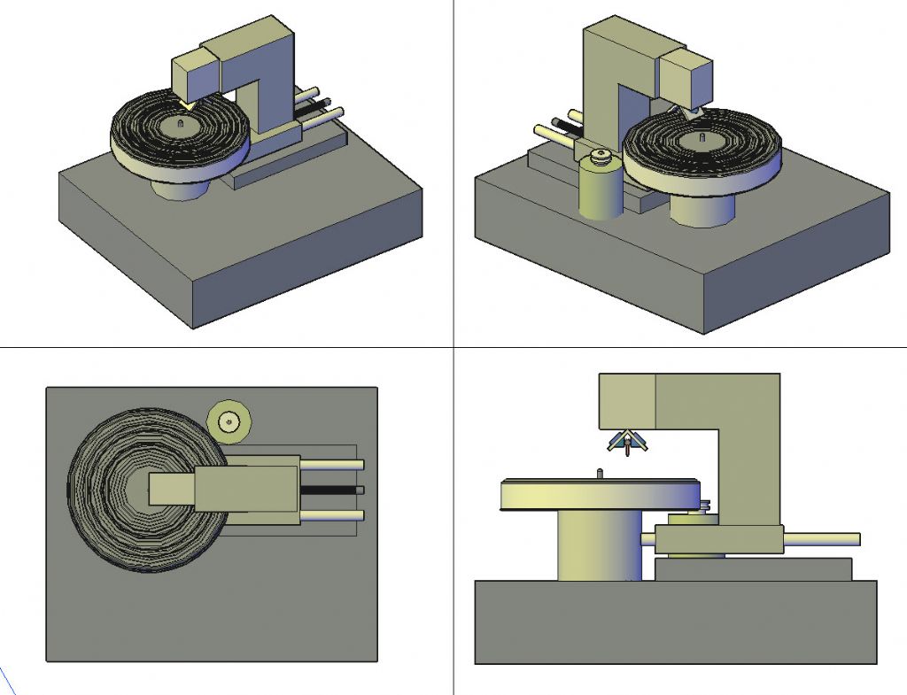

                    I had a play with a concept design for your new lathe. The turntable is 350mm in diameter. I would make the base and the "C" frame carriage from a mineral casting.
                    Cad images are in my Album
                    Regards John

                      Great drawings John! What CAD software do you use? May i ask how long it took to do these? You are obviously familiar with the software.

                          Maybe two hours total time, I did not time myself. The actual drawing would be less than half of the total time spent. The rest would be thinking and analysis. Prior to starting I did browse around the net for Ideas. The design I drew is smaller than the commercial machines I found. Tucking the "C" frame under the turntable does save space, and it will be just as stiff.
                          I Use Autocad 2014. having just installed the latest upgrade pack. I use it for construction as well as mechanical design, so have to keep it updated.
