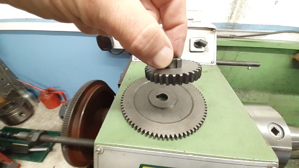

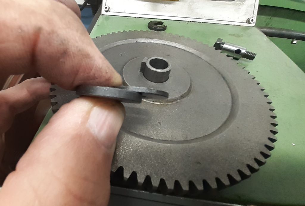

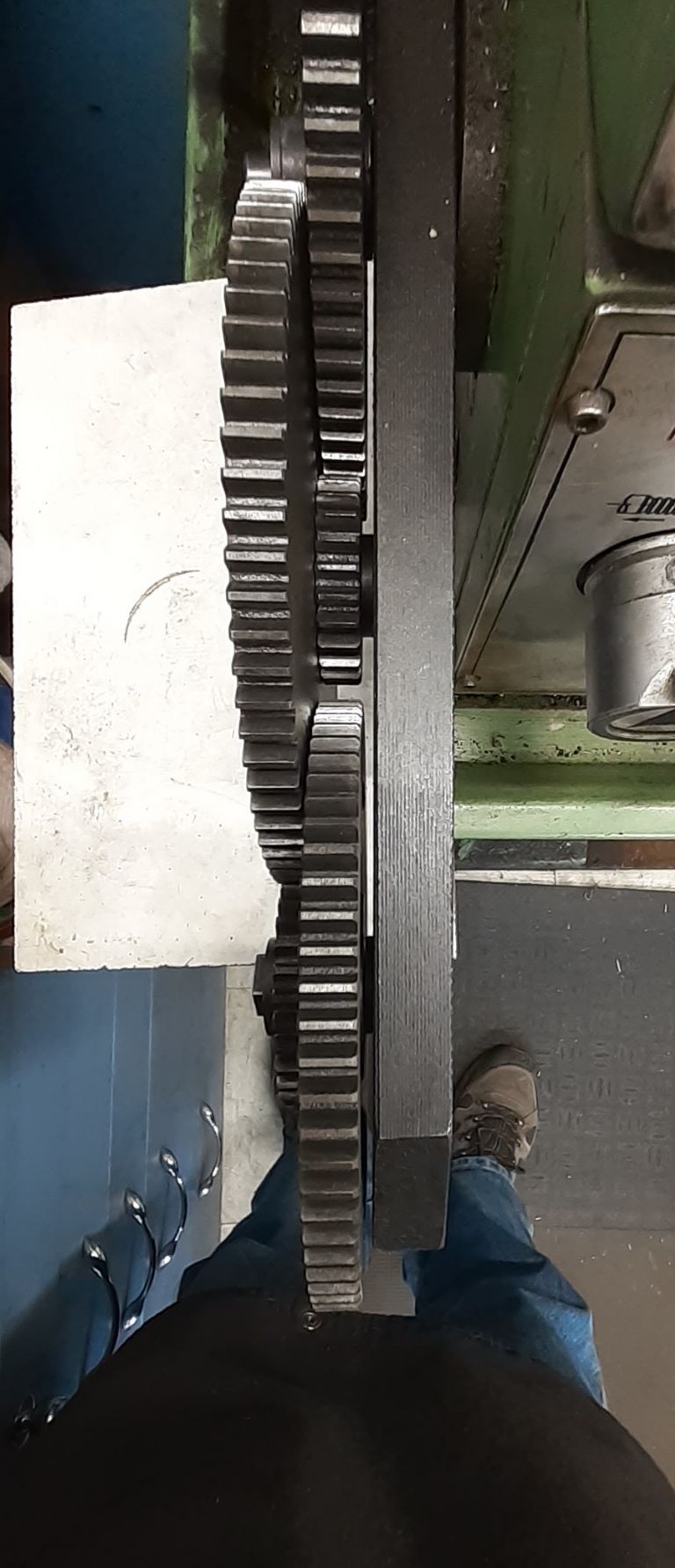

By all means find the gear cover and refit it it, if only for the sake of safety and cleanliness. Those are among the reasons why the manufacturer went to the trouble and expense of providing it!

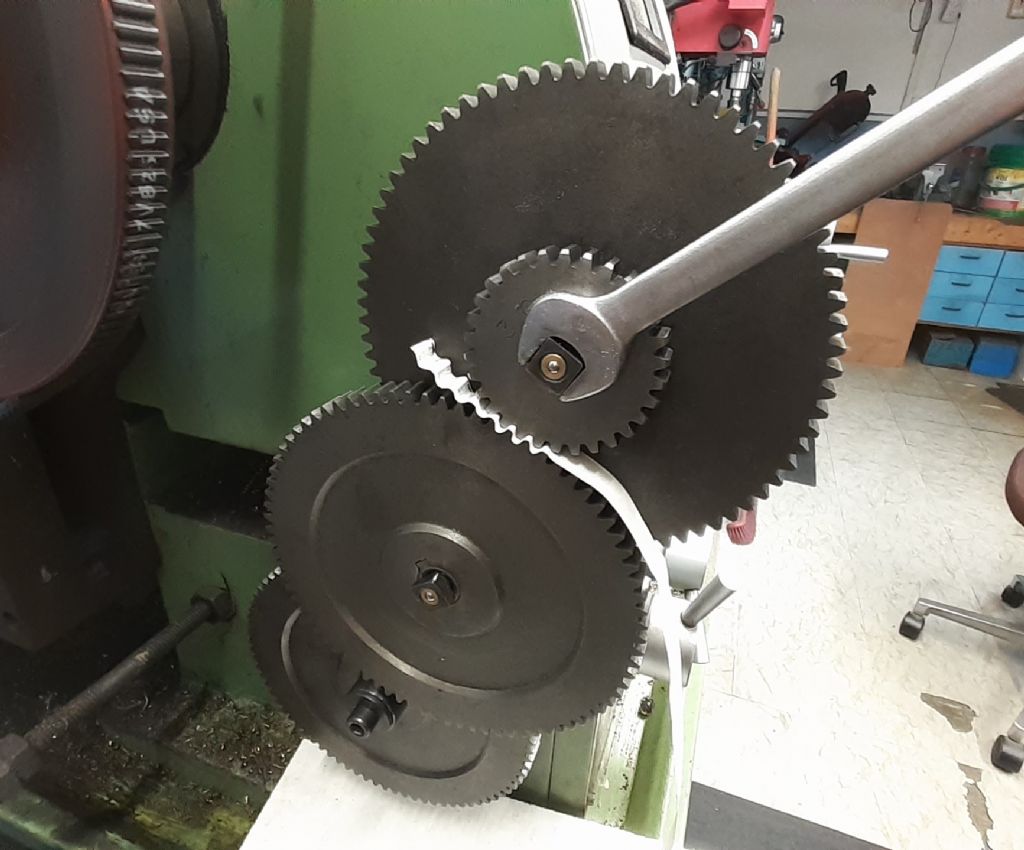

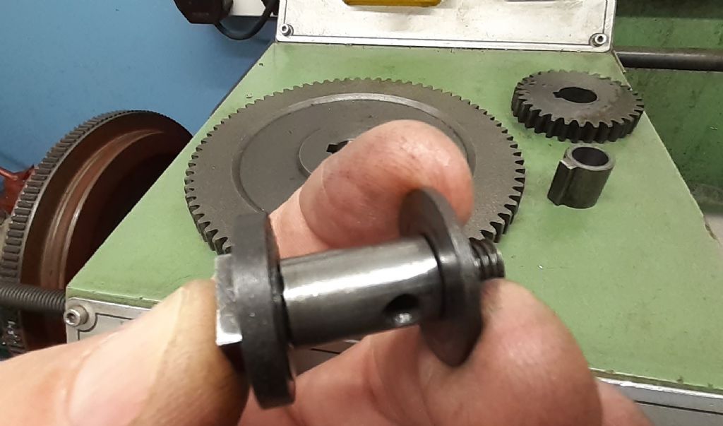

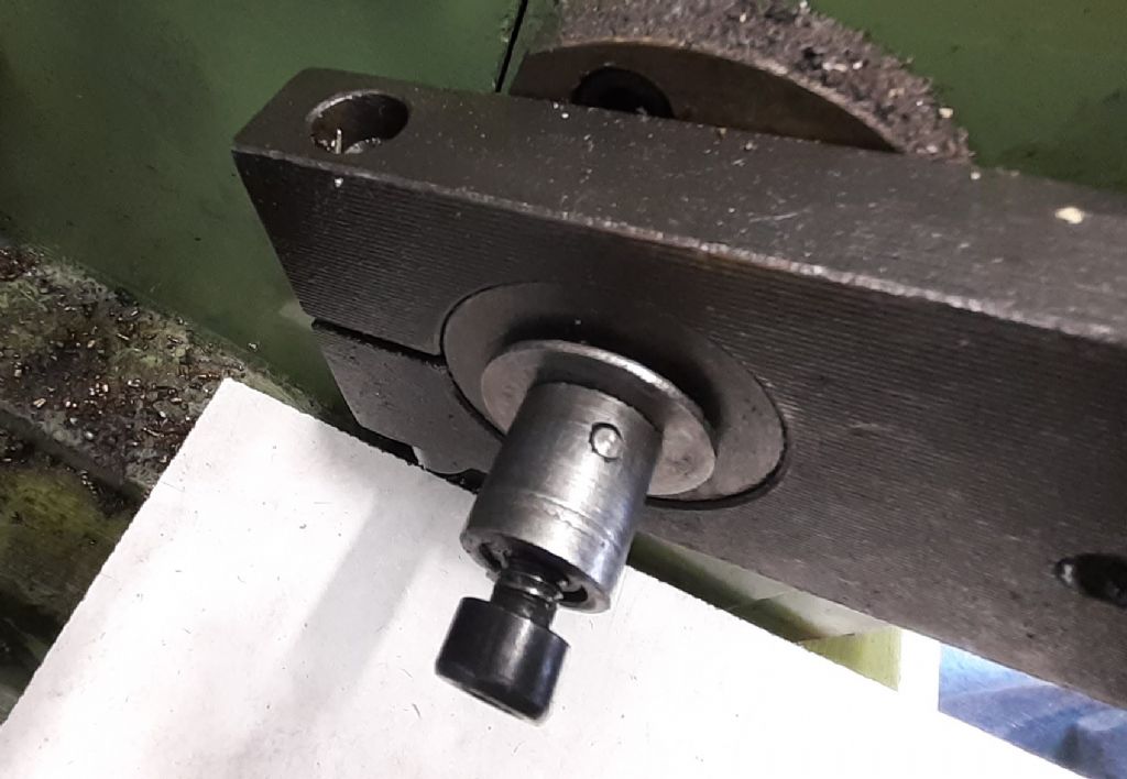

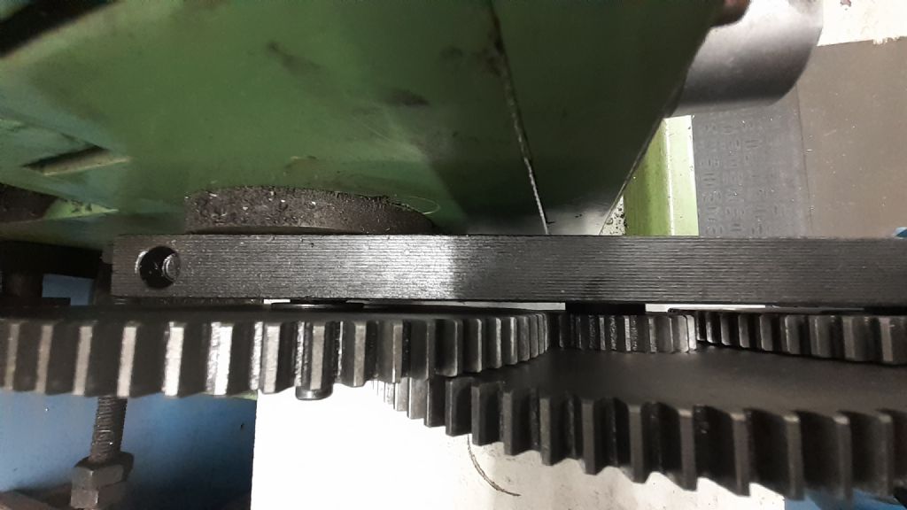

The table will provide details of the gear trains to set for various threads and feed rates. By acquiring extra gears, it will be possible to set up trains for further variants.
(My lathe says that the coarsest pitch that can be cut is 3 mm By replacing the normal 40T input gear to the Norton box with a 30T (supplied with the lathe! ) it was possible to cut a 4 mm pitch thread for a p;articular job..
Similarly, a mini lathe, with a Metric Leadscrew, can cut Imperial threads, (or vice versa ) by including a 63T gear in the train. It is not as precise a using a 127T, but the errors are acceptable for many purposes. .

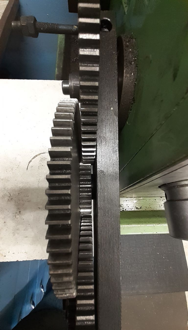

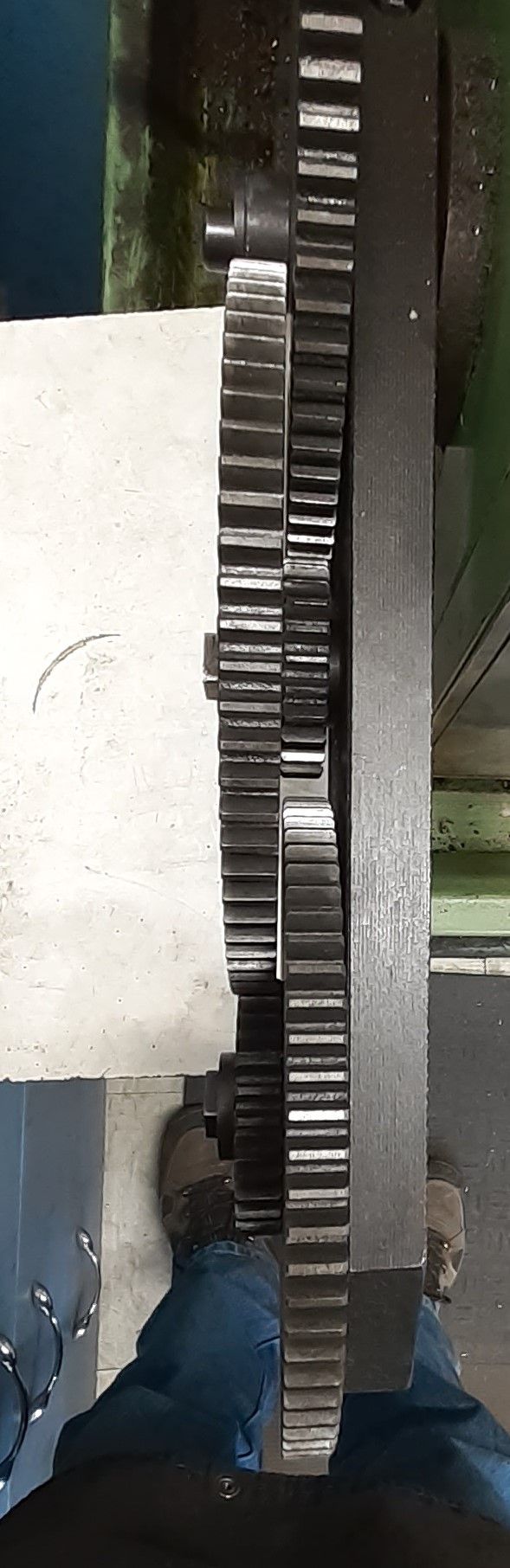

Setting the gears by with a sheet of paper in each mesh will provide acceptable backlash, to drastically reduce noise and wear. Using a thick gear lubricant will further improve matters, and this is where the gear cover comes into it own, in containing any lubricant that is flung from the gears.
