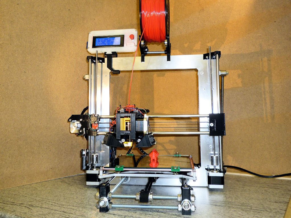

      Well I thought it was about time I joined the party so I bought a kit from Factory 3D. Spent a few days building it and even longer making a few modifications as I went along. This is the final result:
      I am quite pleased and can report that it works, only slight problem was a non-functioning SD card reader but that was quickly sorted by Factory 3D.

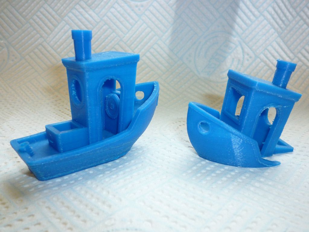

      Just to prove it works a picture of my Benchy, I actually have quite a fleet, some distinctly more seaworthy than others!

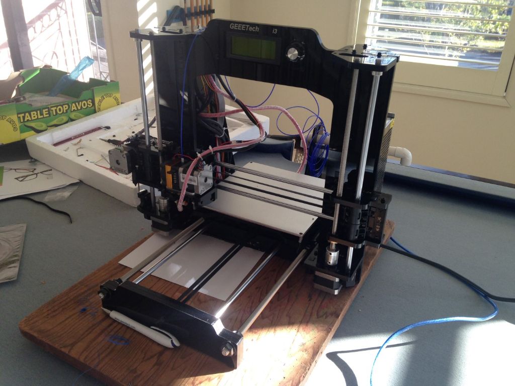

            Looks good John.
            I have just finished the assembly of an I3-X printer. Supposed to be an upgrade on the standard I3. Would have preferred an aluminium frame printer but will see how the acrylic one performs. Everything went together without too many problems (after they sent me the correct, upgraded instructions). Already have a few modifications in mind to improve the design. Now the fun begins.
            Paul.

            #313373
              Well done John!
              A few tips from my experience with the same printer, that probably apply to all Prusa type machines:
              Make sure everything is done up with as little slop as possible (you benchy looks OK, so probably not an issue).
              Add something to keep wires clear of large prints and reduce flex near the hot end.
              Make sure the grub screw that hods the heater secure is done up properly – discovering a heater stirring a puddle of molten PLA is not good as separated from the thermistor it gets quite hot…
              Off the shelf nozzles, hot end tubes, thermistors and heaters for Mk8 hot ends are cheap as chips, stock up in advance then you can swap out.
              Finally, I started getting wonky prints and the extruder mechanism had come a bit loose in its frame, I wedged it in place and saw a big increase in quality, so I suggest checking this from the start.
              Mine is getting almost daily use, it's so useful for little bits and pieces and you can rapidly modify designs.

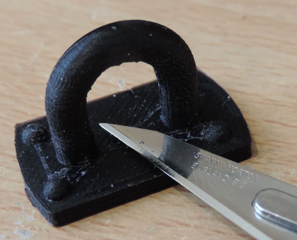

                      After seeing a query about a photo-deposition printer with 0.025mm/1-thou layers I thought i would have a go with the Prusa.
                      There was a lot of combing – you can imagine the amount of filament deposited in each layer was tiny, limiting the amount of retraction. My clumsy scalpel work got rid of this, the white specs are paint off my fingers.
                      The surface finish looks like tiny fish-scales and is comparable to a textured surface injection moulding. In short, the quality is awesome, I'm bowled over by it, but it's incredibly slow.

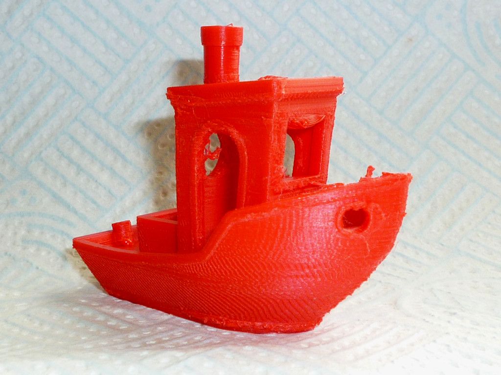

                          Yes the exact size for the bottom layer is very tricky as it is o critically linked to bed levelling and initial z-height, I prefer to allow a little over-extrusion and trim it off as you get a really solid, smooth first layer.
                          A deburring tool works well!
                          Assuming you already have fans on the print head you can get rid of benchy-bow issues with:
                          Thinner layers.
                          Lower temperature.
                          Slower print speed.

                              Well I had a go at Benchy MkXII using some of the things Neil suggested. Results below:-
                              Bed 55 degC Hot-end 190 degC .04mm layer height cut speed down to 50 mm/sec and — total disaster. Still bad near the bed loads of vertical lines which are quite deep, tops of windows not good and bits of spare PLA not whiskers but blobs in places. It took 6 hours! Oh well try, try, again…

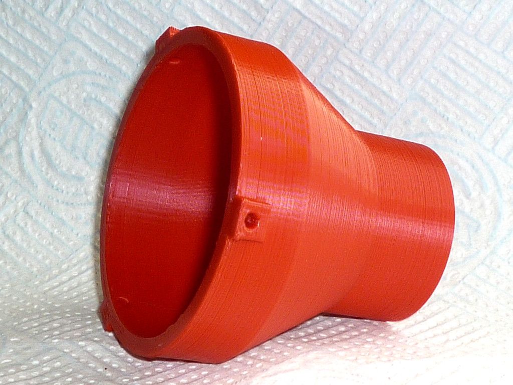

                                Decided it was time to make something useful so printed this:-
                                A connector for the dust extract on my belt sander – 65mm to 35mm to connect to the shop vac. Printed well and fitted, which is a result. Also printed yet another Benchy (sorry if this is boring but this 3D printing lark is all new and interesting to me) used the settings from 3DBenchy.com – yes there really is a web site just for this – and it came out the best so far, I won't bore you with yet another picture though…
