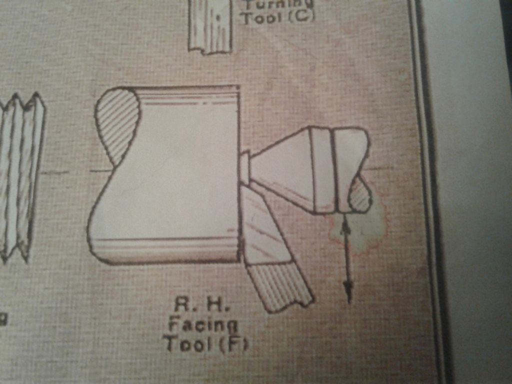

                  Posted by lug lord on 28/11/2017 19:27:56:
                  this is how i have always faced plastic off with the carriage locked so no movement
                  #329649
                    For the one in the drawing above to work as a facing tool it needs the top rake in the opposite direction to the R/H Turning tool you opened the thread with.
                    The carbide tips have rake in both directions that is why you have had good results using the insert in a R/H holder.
                    Edited By JasonB on 28/11/2017 19:32:55
                    #329654
                    lug lord
                      @luglord
                      Posted by JasonB on 28/11/2017 19:31:28:
                      Ahhhhh now i get it

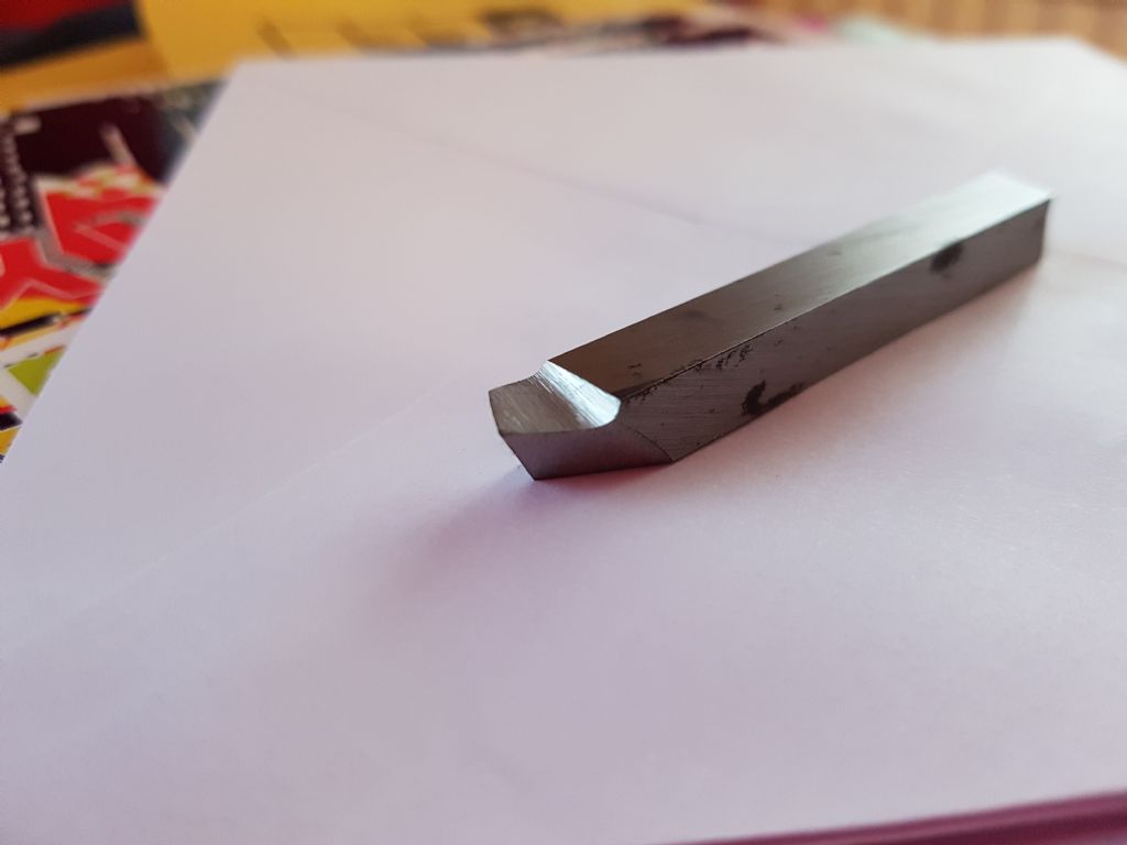

                        #329762
                        lug lord
                          @luglord
                          after a re grind using an eclipse 5/16 hss finally it works a treat now
