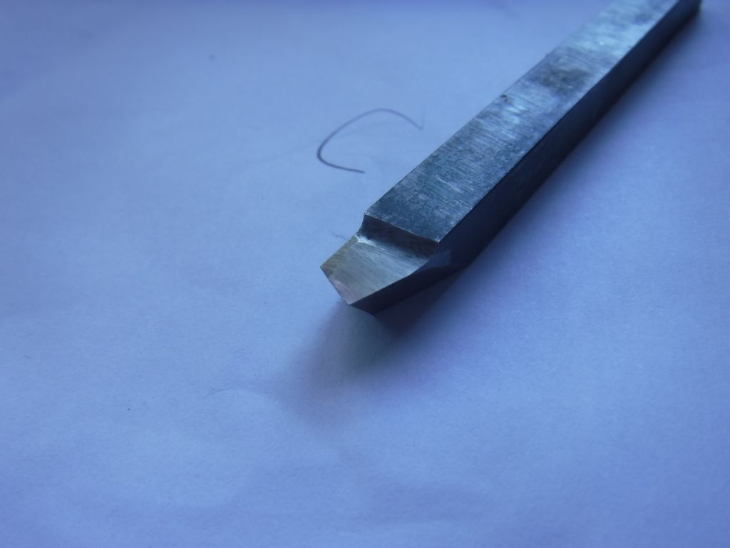

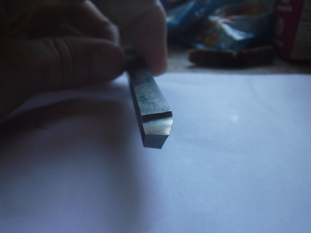

      dscf1196.jpgdscf1195.jpgi made up a hss facing tool i put very sharp angles and a point on the tool but when facing it had a tendency to dig right in and pull the part out of the chuck .
      would i be better rounding the tip on the point,
      I can face it off no problem using a aluminium tippped facing tool but was just plating around grinding my own tools hhs 5/16" on a myford super 7 ill put a pic on of the tool in a bit

            That looks to be completely the opposite geometry to what you need.
            I would call that a right hand tool and they are used for cutting from the right towards the left so ideal for reducing the diameter of a cylinder cutting from end towards the headstock..
            You need what is called a left hand tool which will be the mirror image and the tool is mounted with it's length along the lathe axis and used from the outer dia to the ctr or left to right as you look at the end of the stock
            J

              I put the tool in at an angle so there is a clearance on the end of the plastic piece in the chuck I am pretty sure its a right hand tool i need i been doing this job facing plastic for over 2 years now i just think maybe my tool is too sharp on the angles .
              cutting from the right to the left is what i do

                You haven't got much rake in the direction of cutting when facing with this tool. I use a tangential tool for plastic, rake both ways. Horrible stuf to machine tho' very easy to get entangled in long ribbons of quite tough swarf

                  oh i thought i put fairly extreme slopes on the tool with this plastic you know if it wrong for sure it goes wrong badly.
                  by rake do you mean the slope on the top needs more of an angle
                  #328861
                  duncan webster 1
                    @duncanwebster1
                    From the photo it looks like you've got plenty of rake for turning towards the headstock but for facing it needs to slope back towards the operator as well. Or as Jason says use a facing tool which is a mirror image of what you've got but mounted with the axis of the tool parallel to the spindle.
                    However the photo might lie!
                    #328862
                    Hopper
                      @hopper
                      When facing, you start from the outside and work towards the centre, so your tool is traveling from left to right. So you need a left hand tool like Jason said. And yes, it needs a greater slope on the top surface (rake) for cutting plastic.

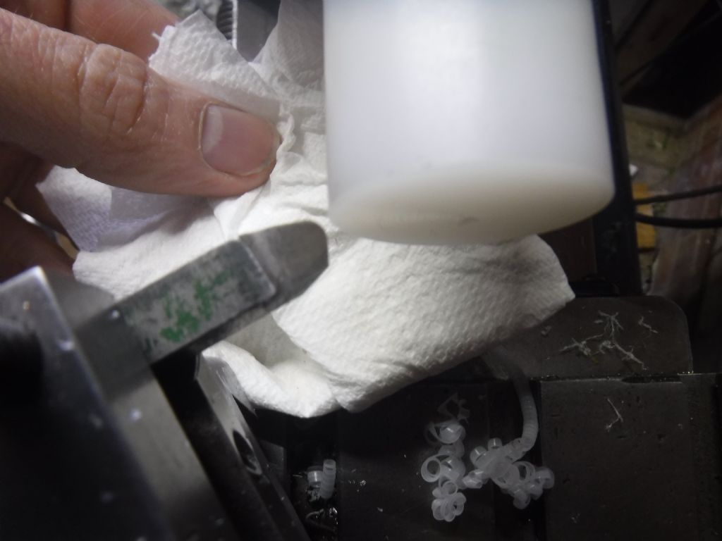

                          i do it like in the pic work from the outside to the centre this seems to work better now i put a nose on the tool instead of a sharp point

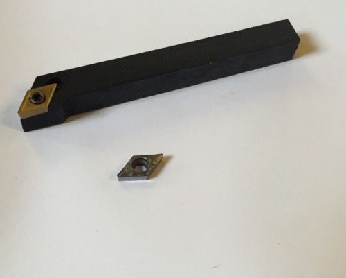

                                  #328904
                                  lug lord
                                    @luglord
                                    the tool above is the one i use with great results with an aluminium insert very sharp but i like to try and grind my own as i am a messer with things

                                        It depends what plastic but assuming Delrin or Nylon, the tipped tool for aluminium above is what I use too. Delrin is a little more forgiving of rake angles than Nylon but both should be OK if you add a small radius to the tip of the tool.

                                                    Luglord, how much material do you have sticking out of the chuck and what sort of dia are you working on, that pic of the white plastic being machined may have too much projection.

                                                      +1 for plastics not being best to learn on. Some are OK, many are horrible.
                                                      That lump of goo may indicate overheating due to your tool rubbing rather than cutting. Try a much sharper tool, more like a knife than the types we use on metal, and/or drastically reduce the spindle speed.
