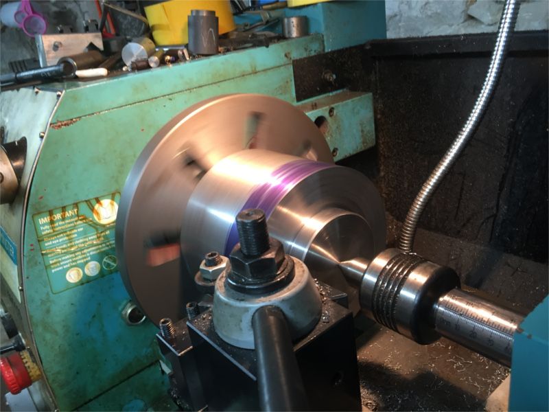

                  Ok a quick calculation. Let's suppose that Robin's part WAS turned between centres and has 1.5 thou taper over 4" – that's 8 tenths off-set for the centres. That would put the end faces off-square by 0.011 degrees, or, nothing in the real world.
                  If you faced the 6" diameter part and didn't relieve the centre you'll have just over half a thou convex or concavity on the end (actually 0.00052&quot over the full face but if you relieved the middle 4" of that 6" face to leave a 1" annular land that 'concavity' is reduced to 0.00013" over the width of the land. In other words it will blue up almost perfectly.
                  Who would argue that a face isn't flat when it blues up on a surface plate?

                      Assuming the part has been fully roughed out and now only needs the finishing cuts, this would be my checklist:
                      1/ Ensure the lathe is facing square & flat:
                      Do a light facing cut on some (scrap maybe?) material mounted in a chuck and place a straight edge over the face to ensure it's been machined flat or slightly hollow. This is desirable to prevent rocking when assembled to the milling machine.
                      2/ Ensure the lathe cuts parallel between centres:
                      Machine the length of some bar (between centres) to see if both ends come out at the same diameter. If not, then adjust the tailstock until they do.
                      Note. If your facing cut gave a slightly humped result, you could compensate this out by setting the tailstock over towards the operator to make the lathe cut a slightly smaller diameter at the tailstock end. Doing this will tend to make facing cuts hollow too.
                      Now the lathe is set up properly, mount the job between centres. Face & turn to diameter (at the tailstock end only), then swap the job end for end and repeat.

                          Graham Meek
                            @grahammeek88282
                            If you look back to the post of the exaggerated tailstock set-over drawing previously. It will be noticed that the previously square base of the cone nearest to the tailstock is now at an angle to the plane of the cross-slide movement.
                            A cut taken across this face will as one poster pointed out produce a conical face. As the tailstock is brought closer to the true lathe centre line this conical face becomes less conical.
                            There comes a position when a point is reached that this face becomes truly flat. Beyond this point and moving the tailstock towards the operator the face will again go conical but in the opposite sense, Concavity.
                            Any one who has had to produce a flat face on a component between centres on a Cylindrical Grinder will be familiar with this technique. I hasten to add that the process is reversed on a Cylindrical Grinder, as the cutting edge in this instance is the edge,or corner of a disc, the grinding wheel.
                            This was the reason for my original advise for doing this job between centres. As the lathes in-ability to face flat can be worked around by altering the tailstock setting. I wrongly made the assumption the Originator knew this. Plus when setting the tailstock up to do such a job, eye balling the centres is not good enough. Time to get out the Verdict clock and make sure, by clocking the taper socket in the tailstock.
                            A Tip, Jubilee Clips make good driving devices for large components where light cuts are being taken, especially when cylindrical grinding. The out of balance can be minimal, and by using two Jubilee clips opposite one another the part can be brought more into balance.

                              Unless I misunderstand the situation, the objective is to produce a riser for a turret mill.
                              In my mind the parallelism of the OD is far less important than having the end faces parallel.
                              If they are not parallel, the now raised column will be at a slight angle, rather than perpendicular, so that any cut made with an End or Face Mill, wlil be slightly concave..
                              Possibly over simplifying things, I would take a very light skim across the Faceplate to ensure that there is a datum surface hopefully square to the lathe axis.
                              Then clamp the work to the face plate, whilst pressed against it by the Tailstock Centre, before taking the lightest possible cut to clean up the one end.
                              Then change the workpiece, end for end and clamp up again, in the same way.
                              Take the lightest possible cut to clean up the second end.
                              This should, in theory, result in both ends being parallel, .
                              You can't keep taking cuts off the ends, or you will finish with a large diameter washer!

                                With the workpiece rotating between centres the lathe tool tip will trace out a surface which can be flat, convex or concave. Swapping the work end for end will produce an identical surface as neither the centres or the lathe settings have been touched.So if you end up with a perfect flat on one end (which is unlikely) you will get flat surface in the other end and in this case and only this case will the two be parallel on the basis that only flat surfaces can be parallel.
                                Moving the saddle down the bed and changing the tool to cut the underside of the first surface will produce the inverse of the first surface. If the first surface was flat the second will be flat (Hoorah, but unlikely). If the first surface was concave the second will be convex.
                                For risers or cylindrical squares we don't need parallel surfaces but two extremely flat coaxial cones tip to tip such that the tip centres are fractionally closer together than the peripheries. As has been mentioned its the peripheries that are parallel not the faces which need to be slightly hollow.
                                Graham has explained the adjustment of the lathe centres to approch flatness from the concave condition. Aim for nearly but not quite flat tending to concave. Swap the work end to end and do the other face.

                                          Looking at Hopper's diagram I see where I went wrong in my thinking – my mental model was that in an ideal world where the cross slide is perfectly perpendicular to the lathe axis it would have to cut a plane perpendicular to the lathe axis. Obviously (now) not true across the diameter – I did say I have problems with 3D visualisation! It's embarrassing as I know full well that the lathe faces slightly concave under the best conditions and understand the how and why of that. I knew there was something suspicious about my reasoning, just couldn't decide what and missed the wood for the trees. I blame the guy who taught me about conic sections!
                                          I finished the riser by bolting to the face plate with M8 studding though the spindle and tailstock support:
                                          I'm happy, in the light of comments, that I got as good as half a thou. On a Far Eastern  lathe!
