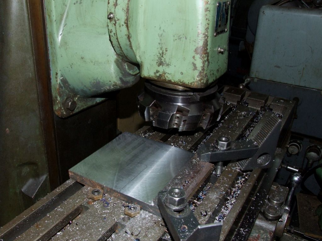

          The eagle has flown, (or being that it's from northern Sweden and extremely heavy, should that be "The walrus has left the beach&quot.
          07-11-22 Face Mill
          Taken just before I packed it up to go…
          #624105

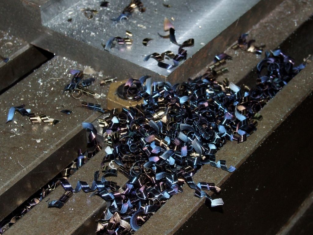

            Andrew kindly took another pass with the 80mm head and took a video which I have put onto YouTube for him. Quite a difference to the SX2.7 mill's rate of metal removal when a powerful and solid machine is driving the cutter. Some nice warm chips judging by the slight blue tone. More details in the video description.

              Posted by JasonB on 08/12/2022 19:13:44:
              …nice warm chips judging by the slight blue tone.
              The chips range from royal blue to a rather pretty gold colour:

                        #628245
                        Anonymous
                          I have finally got around to testing out the 160mm diameter face mill kindly lent to me by Jelly:
                          Material is hot rolled steel. I dropped the spindle speed to 210rpm, about 105m/min surface speed. Width of cut was 150mm. I initially kept the feedrate at 430mm/min for a chip load (10 inserts) of about 0.2mm. However, I got some chatter. This may be because the cutter body is held to the spindle only with 4 1/2" BSW SHCS into the face of the spindle. So, despite my efforts, it is running noticably eccentric with consequent variation in chip load. I am also not sure that the inserts are consistently located in the pockets. I dropped the feedrate to 285mm/min for a chip load of about 0.13mm/min and that cured the chatter. Chip width measures 0.15mm, which is about right, as chips tend to be slightly thicker than the feedrate would suggest.
                          I have sent JasonB two videos which I hope will be posted in due course. The first run was with a depth of cut of 2mm. Changing units that is about 5.38 cubic inches per minute. The mill had no problem with this. I then increased the DOC to 2.5mm (6.72 cubic inches per minute) and stalled the cutter. I think that the squeal towards the end of the video is the motor belts slipping. I did some tidy up passes and have run the mill in a range of speeds and it all seems fine. I'd be pretty niggled if it wasn't. The stall was quite gentle and an industrial machine should be designed to survive that without damage.
                          When I stalled the cutter it chipped one insert so the next task is to order another batch of inserts from Ebay. smile
                          Andrew
                          Edited By JasonB on 08/01/2023 20:10:46

                                  The cutter looks very at home on your A&S Model 2 mill too, despite being designed for machines with slightly more horsepower (which is not something yours lacks!)..
                                  Posted by Andrew Johnston on 08/01/2023 19:57:39:
                                  I realise now you've said that, that I had the exact same issue with eccentricity when I last ran this and had the thought "I should make up an arbour as a locating feature if nothing else" but then forgot by the time I came to lend it to you… Sorry Andrew!
                                  As far as the insert location, I did give the pockets a good clean when I got it and they're all in pretty good shape, so If you were pushing them home as you tightened the wedges I would expect they were consistently located, the way those Dolfamex cutter bodies are made everything should always line up properly when assembled.
                                  That does tie up nicely with the rule of thumb that in mild steel / annealed carbon steels generally you can take about one cubic inch per horsepower.
                                  It really did seem like it was struggling before it stalled on the second pass, you could see the cutter slowing slightly more on the "deep" side where the eccentricity of the mounting was pushing the cutting edge slightly further towards the workpiece.
