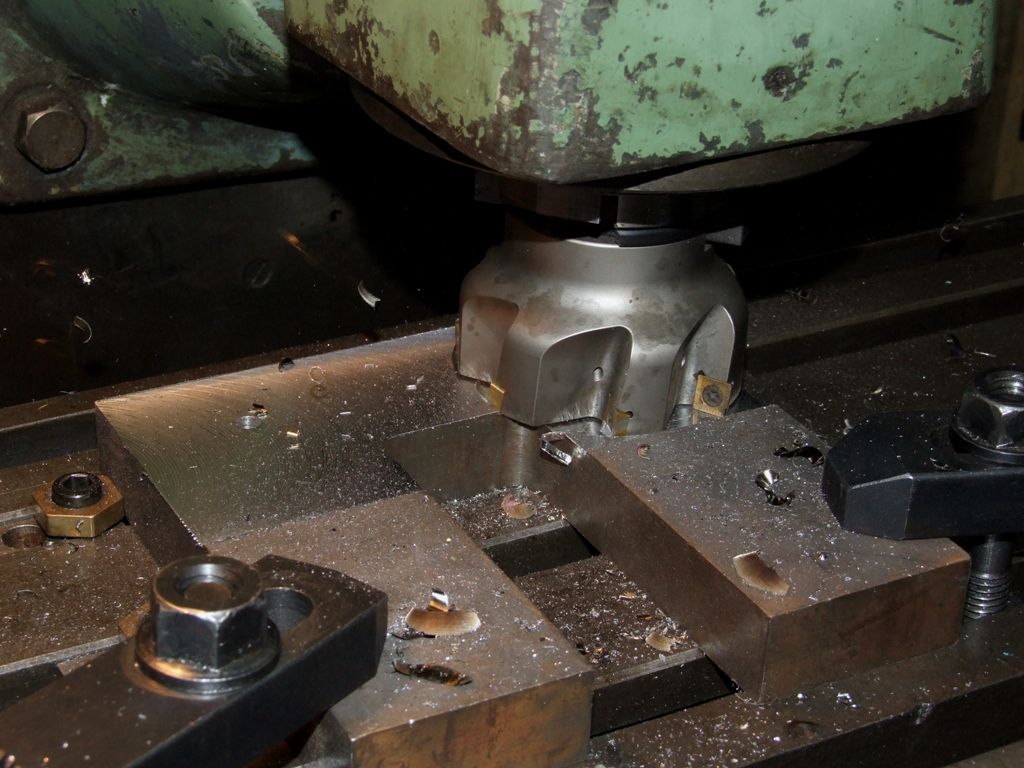

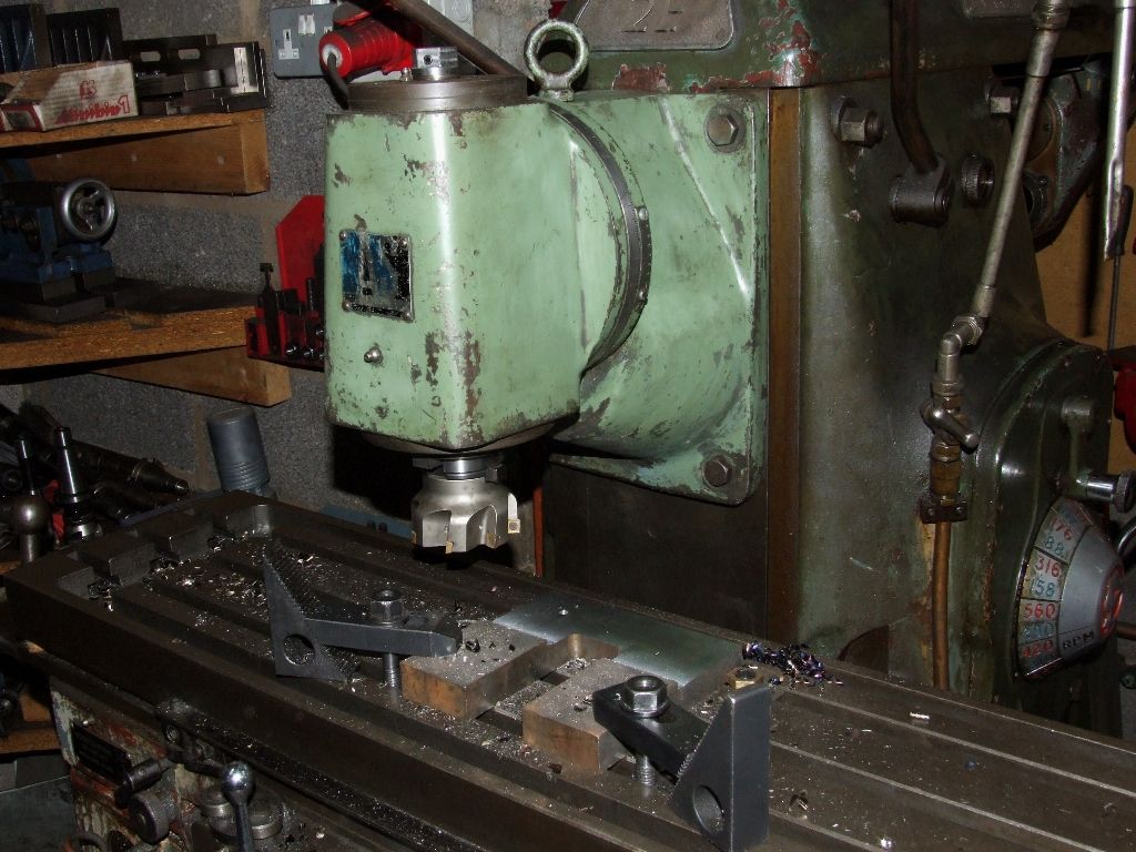

      Following a recent, somewhat intemperate, thread on face milling, and having just got the vertical attachment for my horizontal mill running I thought I'd give a face mill a real run for it's money.
      I used a 7 insert 80mm diameter face mill. Parameters were 420rpm on the spindle and a feedrate of 430mm/min giving a chip load of 6 thou per insert. Width of cut was ~75mm, say 3", and DOC was 2.5mm, say 0.1". The parameters equate to a removal rate of 5 cubic inches per minute. My horizontal mill has a 5hp motor. Cut in progress in some scrap low carbon steel:
      I thought the mill might struggle a bit, but the cutter went through like a knife through butter. I'm at a loss as to what I have to do to make the mill struggle on a cut.

              Thanks Andrew, good to see what is needed to get the inserts to work at around the published chiploads and DOC.

                Thanks; are the Miteebites all there is in terms of a 'stop'?

                  Posted by DiogenesII on 04/12/2022 17:39:13:
                  …are the Miteebites all there is in terms of a 'stop'?
                  The two conventional clamps offer some resistance to twisting, but are there primarily to hold the work down. To reduce the risk of the work twisting I added the offset hexagon clamps. There are two on the left and one (hidden) on the right. The hexagons and offset head screws are commercial items, but the T-nuts they fit into are homemade.
                  Andrew

                                I guess that is the Adcock & Shipley hoizontal with a vertical head? They are a very solid machine.
                                Martin
                                #623705
                                Anonymous
                                  Posted by Martin Johnson 1 on 05/12/2022 12:45:44:
                                  …Adcock & Shipley hoizontal with a vertical head?
                                  Correct, the A&S 2E with vertical attachment:
                                  I bought the vertical attachment many years ago on Ebay for £50 but have only recently cleaned it up and fitted it. I also made a M16 drawbar and new drive dogs as one was missing.
