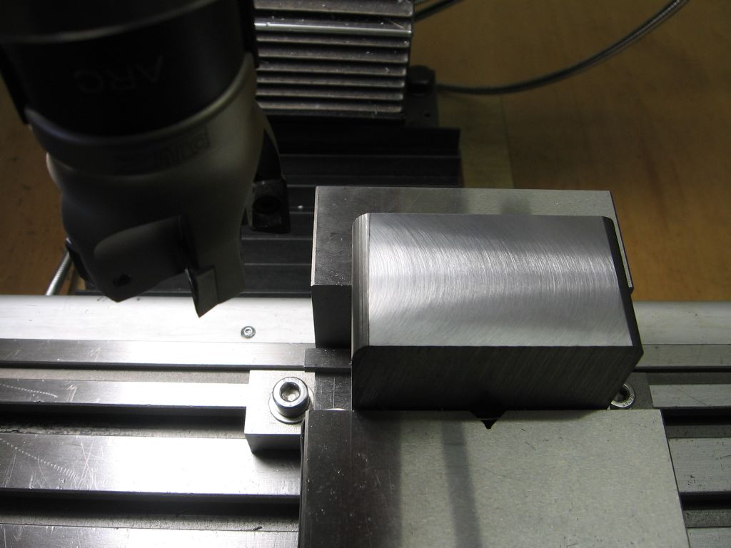

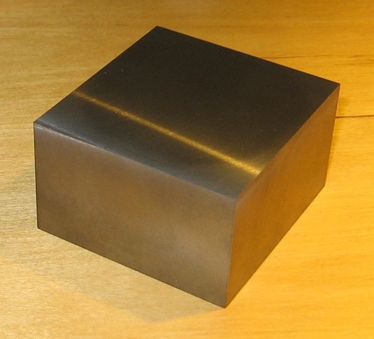

      Don't even have to keep the facemills for large flat areas, squared off this bit of 22mm EN1A at the weekend to 12 x 9 far faster than I could with a milling cutter that would have needed a couple of passes to cover the area and likely left witness marks of each pass compared to the 63mm 5 insert head with non ferrous inserts used on the X3.
      The 0.8mm corner radius of the inserts also helps with getting a nice finish that a standard milling cutters square corners don't. So that's another point in favour of the insert heads.
      Edited By JasonB on 01/12/2022 07:30:35

                    Well I got time to have a little play
                    ARC SX2.7 mill running at 750rpm
                    ARC 80mm six insert shell/face mill & R8 Arbor
                    ARC APTK inserts for non ferrous, used not new.
                    Material GR17 (Grade 250) cast iron 71.5mm width cut
                    Although there is no cutting data published for this type of insert used on iron similar shaped ones have figures of 120-220m/min cutting speed, the combination above is towards the top end of that at 188m/min.
                    With the material mounted skin side up I took two cuts of 0.5mm height, the first removed the high side so did not really give a full width cut but machine was quite happy with me feeding at 80mm/min which equates to a chip load of 0.018mm/tooth. Second similar cut did just get upto full width and machine was still quite happy with that cut. The curls of cast iron swarf show that the inserts are cutting and not rubbing
                    I then took a 1mm high cut and the machine did start to sound as though it was working so I did not push the feed over 60mm/min which equates to a chip load of 0.013mm/tooth. Finish is good considering I'm having to feed one handed as phone is in the other hand which is never going to be the smoothest option.
                    For those that want to know the MRR then the 0.5mm cuts were taking 0.17cu in/min and the 1.0mm cut worked out at 0.26cu in/min.
                    So there you have something to go by as a starting point Martin, if it were me I would stick around the 0.5mm depth, possibly feeding a bit faster say 100mm/min or stay with the 80mm and try a little deeper at 0.75mm. I don't think I would be happy running at the 1mm DOC on that wide a workpiece for an extended time.
                    With no engineering background I give my opinions based on using benchtop machines so don't base things on what has traditionally been done with larger more solid machines equiped with mechanical speed control rather than variable electronic control and suggest what I have found to actually work in practice for me.

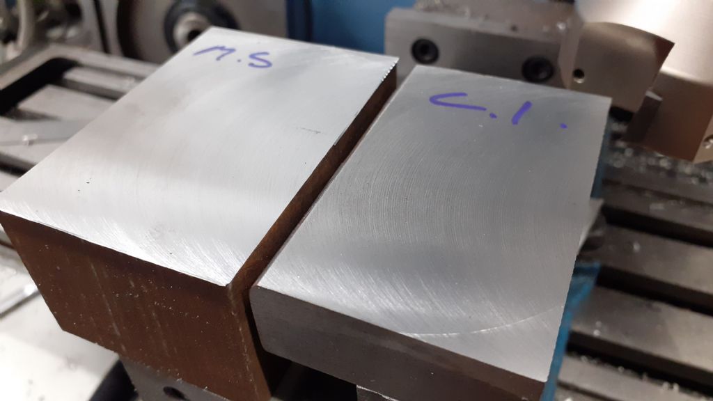

                                    Posted by SillyOldDuffer on 02/12/2022 17:23:16:
                                    Don't forget the material matters! Cast Iron only requires about half the cutting force needed to get through mild-steel. Tool and alloy steels require up to double the force needed to get through mild-steel.
                                    In which case we are in luck because steel generally has a faster cutting speed than Cast Iron so we can wind the pot on out hobby machines up a bit and get that extra power out of the motor as it gets closer to it's sweet spot.
                                    Although Martin's original question was about machining cast iron as Michael said this post can serve as a guide to those thinking of trying these type of cutter on their hobby mill so I have also wasted a bit of steel this morning.
                                    In this case a piece of Dave's favorite "unknown" steel of which I was given a couple of lumps, one of which at 76mm x 51mm will serve a similar comparison to the 71mm piece of iron machined yesterday.
                                    Again the load on the machine can be considerably lightened by using APKT non ferrous inserts in the six tooth 80mm head. This time speed of 850mm was found to give a good result which equates to a machining speed of 210m/min again towards the top end of the suggested speeds for this shape of insert on low carbon steels. Timing the cut gives a feed rate of 86mm/min which equates to a chip load of 0.017mm/tooth. Cut is the full 76mm width of the block and Depth of cut again the same 0.5mm. Machine seemed happy enough and curls of swarf again suggest the inserts were cutting and not rubbing.
                                    I'll not bother to work out what it may have taken with flycutter or milling cutter as I expect results will be pro rata that for the cast iron.
                                    Not too shabby for an underpowered non rigid machinewink 2
