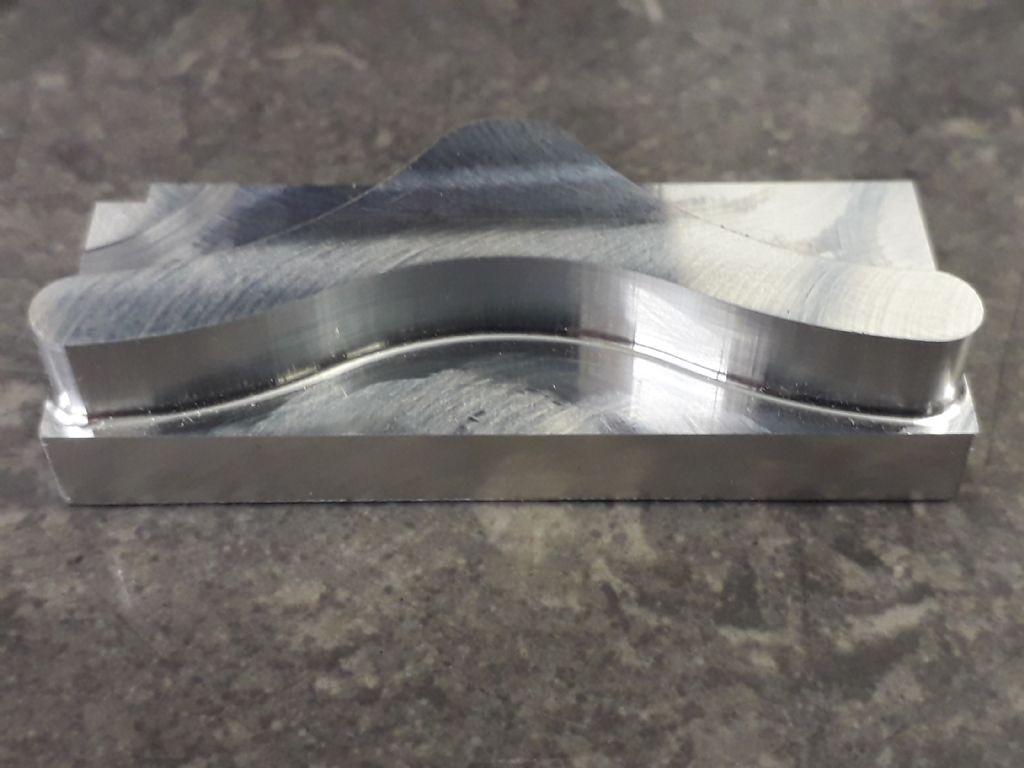

              Vertical and horizontal faces cut with the same 90deg Insert holder, APKT inserts as it was ali, APMT for steel or iron
