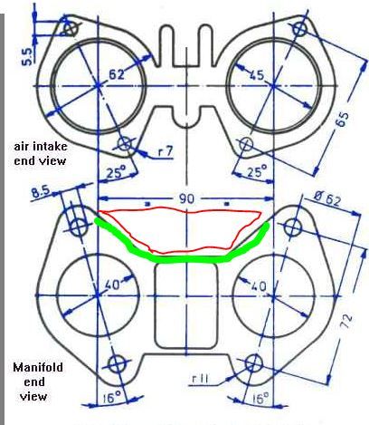

      Hello dear learned colleagues,
      I am planning on fitting a Supercharger to my classic Mini A Series Engine (lots of people
      have done this).
      There are of course complete kits that you can buy but I, like many others, are going to try the DIY route.
      To mount the Weber Carb onto the end of the SC, you need to cut the SC with a bandsaw and weld on a pre fabricated flange like this, as shown in this video at about 11:07.
      Watching the video I have seen that, to reduce the amount of weld filling required, the flange shape needs modifying, as it is too small across the top.
      So here are my options:
      a. Try and draw the flange in 3D package and get it CNC’d or
      b. Try and mill it myself
      Problems, I don’t have any dimensions (I do however have the carburettor which I could use to get them?
      I have a Warco Hobby lathe which I have adapted for milling with a vertical milling slide.

          So a little searching on the Interweb and I found the dimensions, but then also found a CAD engineering file.
          i can register and download it, but not sure what the file format would be to add the infill that I would need?
          https://grabcad.com/library/pinto-weber-dcoe-intake-manifold-1

              Does it even need that much if any machining.
              Two large holes can be done with a holesaw or you could clamp to your vertical slide and bore on the lathe, I'm assuming its too big to swing.
              4 smaller holes are just drilled and tapped.
              Then hacksaw the main shape and file the rounded bits which would be quicker than trying to set it all up on a vertical slide,
              Or Weld a block of aluminium to it where it is too small then dress flush and do the other welding. Something like the bit of plate shown in red with some deep weld prep to the green edges. Clean it all up and then weld it on as one with a lot less heat going into the job

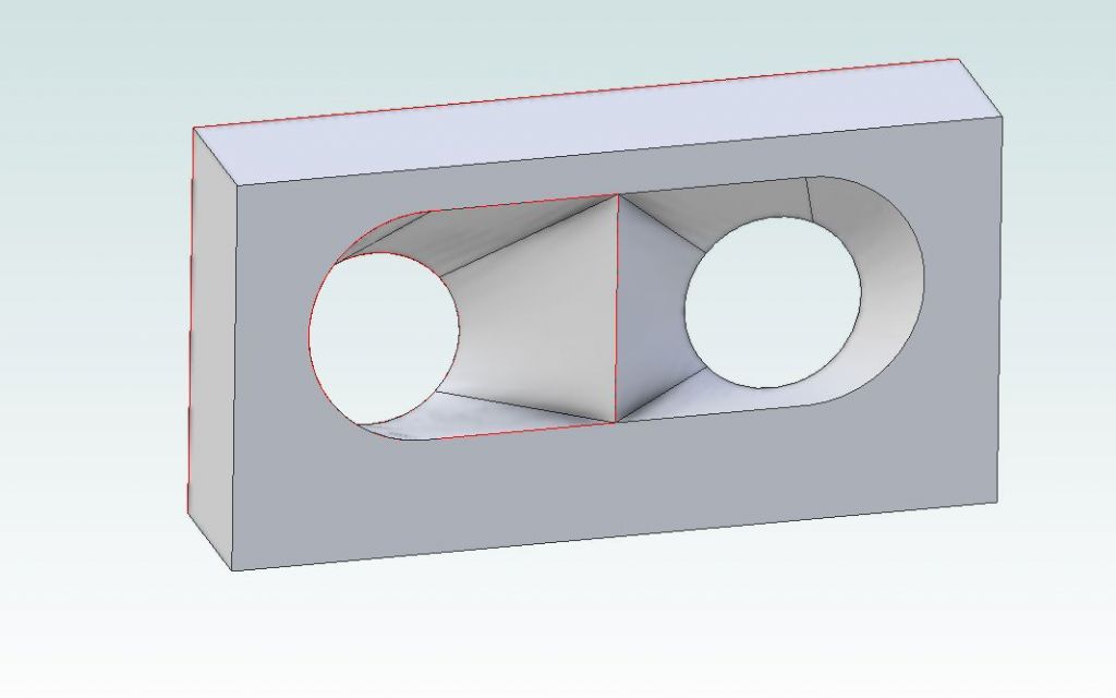

                                      Here's the SC I have. It's an Eaton M65 from a Mercedes SLK.
                                      Here's the Weber (I obviously won't be using the manifold).
                                      So you are suggesting make a wider flange that is angled downwards to (a) mount the carb lower and (b) maximise the port size.
                                      Like this (crude attempt)
                                      Edited By William Harvey 1 on 21/01/2022 14:41:58
                                      #581563
                                        That would certainly give a smoother flow due to the longer transition from the Weber shape to the SC, ideally you would do a lot more shaping of the 40mm block. if you draw each have on either side of the block and then use the loft function of the CAD package that would give an idea. Assuming the extra 30mm does not put the intake end of the carb in the way of anything
                                        Edited By JasonB on 21/01/2022 15:43:56

                                            Posted by JasonB on 21/01/2022 15:33:41:
                                            Sorry which side would go towards the carb?
                                            What’s the loft function?

                                            Dave Halford
                                              @davehalford22513
                                              The two holes are the carb side the oval would match the blower intake shape essentially like your existing manifold only dropping the carb height and except the blower end would be a single oval port.
                                              Can I suggest that as you haven't cut the blower yet and IF there's room, that you try fit an 90deg elbow on the pipe flange (and a blanking plate on the other hole if it fits) your existing SU will do for size.
                                              The reason is SU's are known to work well on blowers and there's a lot less trouble with jetting (you can get a Gunson Colortune to check the mixture is in the ballpark. Some of them even had electric heaters to combat the icing.
