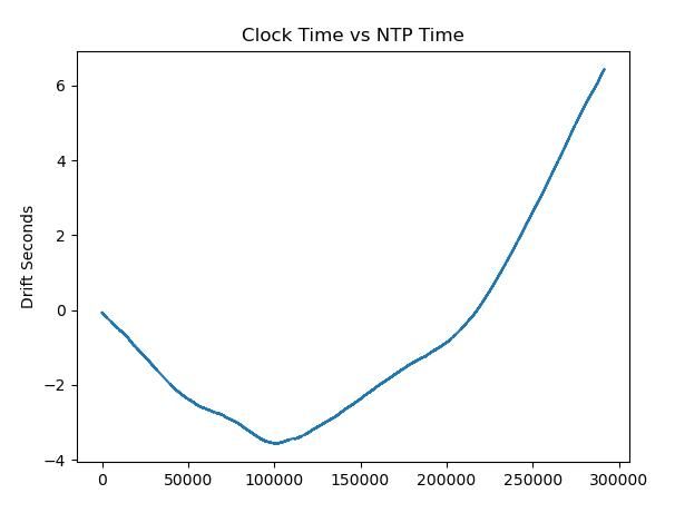

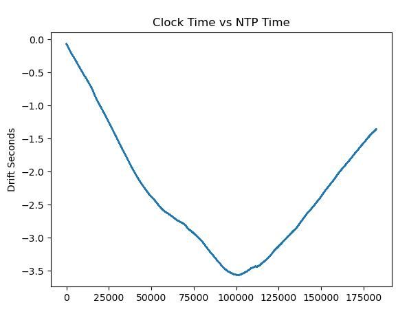

Today's clock results are encouraging, but there's a new mystery!
The clock was adjusted to count 'nominal' on the previous run's average period, and I reduced the impulse again. The bob now gets kicked 80% of the time, which reduces circular error.
Result – after nearly 42 hours the clock, still uncompensated, is wrong by -0.174s:
ClockRun = 1 day, 17:45:16.825680 (150316.82568s)
ActualRun = 1 day, 17:45:17 (150317.0s)
Difference = -0.174s -0.000116% (-1.2ppm)
Nominal period vs Actual Error=-0.000121%
Tick Data
Nominal=823320us Real=0:00:00.823321s Mean=0.823321
However, I've added a new graph showing how the clock drifts relative to NTP time, which shows it's wandering!
So, the clock might be only -0.174s slow at the moment, but it slowed steadily for the first 100,000 beats down to -3.5s, not good, and then covered up the error by picking up speed again. Be interesting to see what it does next. I was going to tweak the impulse amplitude threshold, and reduce the impulse slightly, but I won't disturb it.

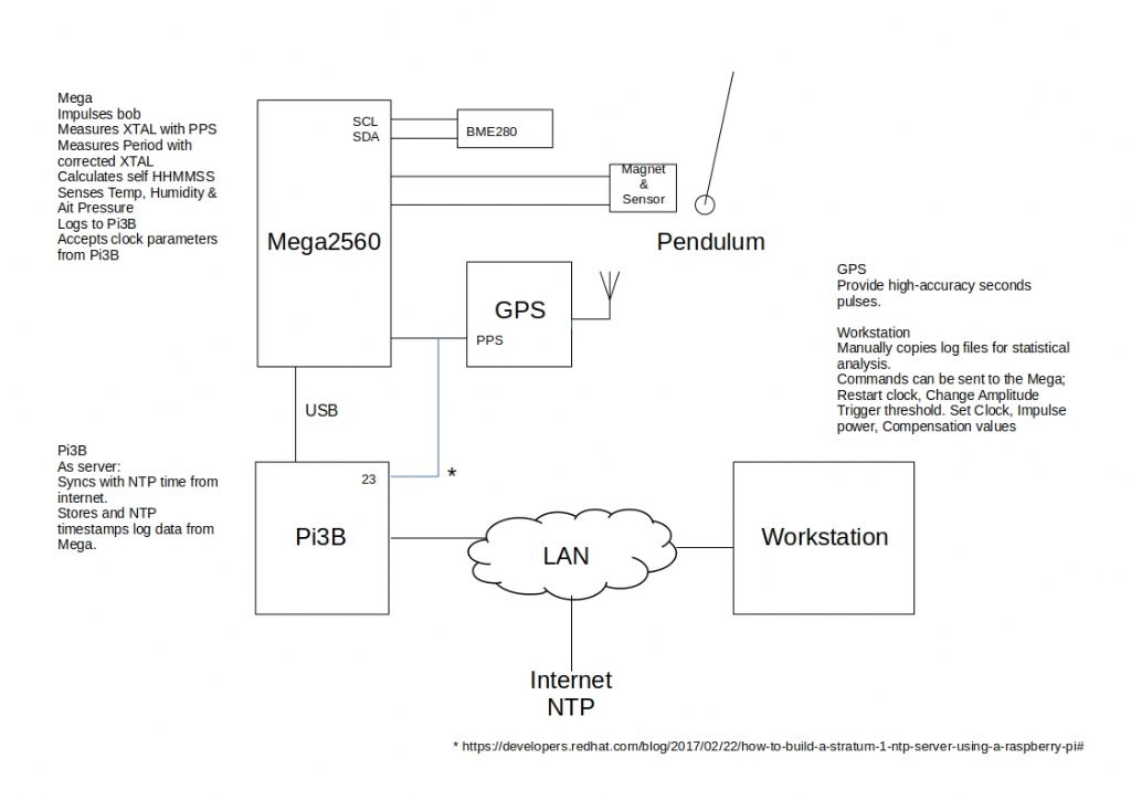

Whilst waiting for components to arrive, I've decided to improve how the clock is measured. At present, period is measured by a hardware counter; it's how many 16MHz crystal pulses are counted between events caused by the bob breaking the IR beam. This OK except Arduino crystals aren't particularly stable. The existing arrangement mixes pendulum temperature effects with temperature effecting the crystal, which could confuse the results.
So I've decided to upgrade from an Arduino Leonardo to an Arduino ATmega 2560. The 2560 has more hardware counters, making it possible to measure the crystal with GPS as well as the pendulum with the crystal. Knowing the crystals actual frequency eliminates temperature effects and significantly improves accuracy of pendulum measurements.
The upgraded set-up will be this:
Another potential improvement is to upgrade the Raspberry Pi3B to be an NTP Stratum 1 server. These use GPS second pulses to correct NTP.

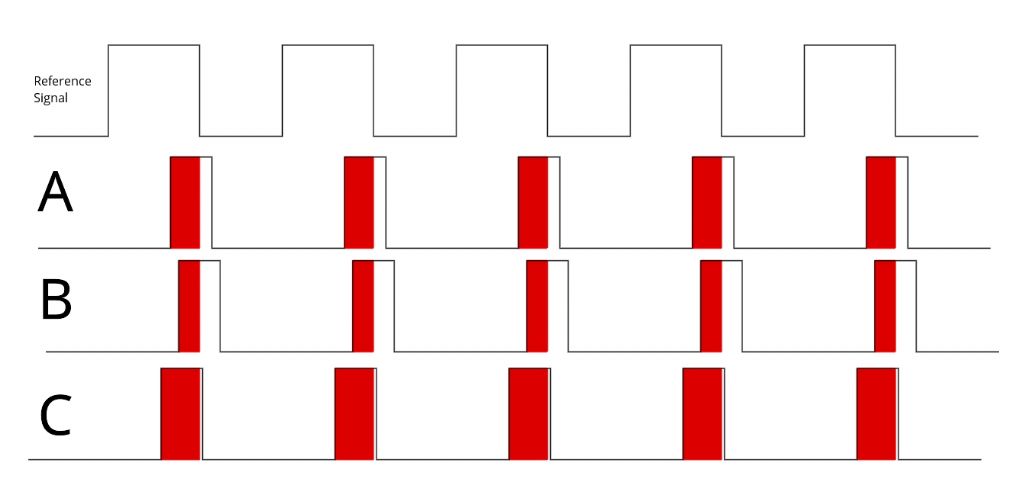

Dave, for your next project. Now that you have a highly accurate GPS reference signal, and a switching mechanism to deliver a power pulse to the pendulum, rather than complex (PID) math to adjust the pulse timing have you considered using the lack of isochronism in the pendulum as an inherent feedback mechanism.
I assume the pendulum characteristics are such that as the power increases, the amplitude increases, and the rate slows (slightly).
The diagram illustrates the idea in a somewhat exaggerated form. The top line is the highly accurate signal used to deliver a square wave pulse exactly at the pendulum’s ideal rate.
The next three lines show the drive pulses from your sensing/switching mechanism under various scenarios.
A illustrates the ideal position. On each swing, the reference signal goes high before the switching mechanism applies power to the pendulum. The switching mechanism then activates and applies power which is turned off by the reference signal going low. The red area represents the power supplied.
B is the situation when the clock gets a little slow. The pendulum switching will occur slightly later relative to the reference signal. That results in a lower power delivery to the pendulum. Therefore, the amplitude decreases, and the clock speeds up a bit. The feedback continues to increase the rate until we get back to A.
C illustrates the clock gaining slightly. The pendulum switching then occurs slightly earlier relative to the reference signal. The power delivered increases, as does the amplitude and the clock slows down again until position A is re-established.
If it all works as it should, the pendulum rate will inherently lock to the falling edge of the reference signal*.
This is the mechanism, based on an idea from Derek Roberts, which Bryan Mumford developed into his Governor product for Eureka, Bulle and other antique battery clocks. Frank Roetsky makes a similar device.
PS* If the pendulum characteristic is the other way round – increased power increases the rate, and Bryan suggests there are Eurekas that do this, then the mechanism still works except the the pendulum locks to the rising edge of the reference signal.
The method does work well. I have one of Bryan’s units and one of Frank’s on a couple of Eureka clocks and both keep time to within seconds per year.

Ran slow for 100000 ticks, since when it's been running fast, and the rate is getting worse, cause unknown. I've decided to let it run for a few days to see what it does next in hope of identifying the issue.
