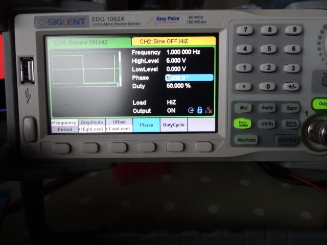

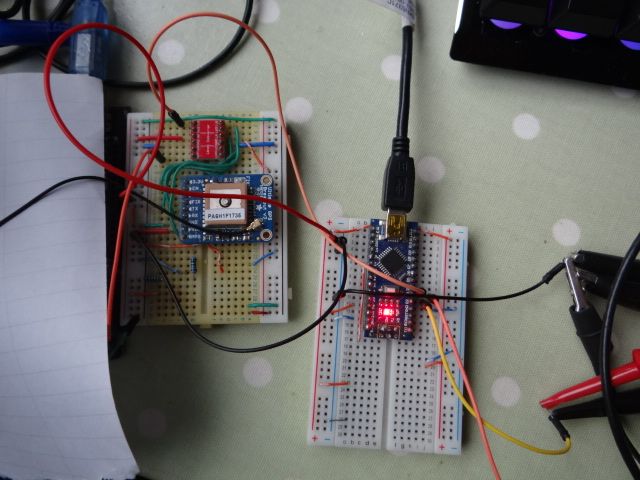

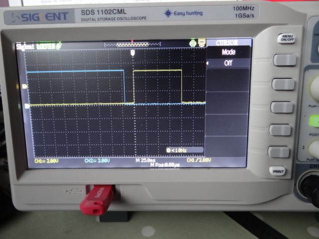

                                        Had a go at what happens when an Arduino Nano gets two interrupts at the same time.
                                        Up to 5kHz, the Interrupt on Pin 3 is reliably detected, and that on Pin 2 is ignored.
                                        Dave I think there is a problem with both your code and your understanding of the interrupts. If I read the Arduino documentation correctly, if two interrupts arrive simultaneously, then they are processed in priority order. Pin 2 has a higher priority than pin 3, so in your test Interrupt 2 should get processed first which sets Value equal to 1, when that ISR is finished the interrupt on pin 3 is executed, which sets Value equal to 2 — overwriting the bit set by interrupt 2 and making it seem as if the pin 2 interrupt is being ignored.
                                        I also think that the problems you are seeing at over 5khz are the result of the serial print process being interrupted. 115,200 baud is about 10,000 chars/second max. You are sending 15 – 20 chars per print. Once the serial print buffer fills Serial Print waits until there is room in the buffer – so once the buffer fills each serial print will be taking 100 microseconds per character printed. At 10khz interrupt rate you are almost guaranteed to get the print process interrupted and the data corrupted.
                                        A more valid test would be to have each ISR increment a separate counter each time it is executed, then in the main loop simply compare the two counters.
                                        If both interrupts are being serviced properly the two counters should remain in step. When they differ, you have found the limits.
                                        PS if an interrupt on 2 arrives while the interrupt on 3 is being serviced, then it simply gets queued until the one on 3 has completed.

                                          We're on the same page, I think. Priority is why pin 3 is detected more often in my code than pin 2. When there's time, pin 3 is counted and pin 2 has no apparent effect. Which works until the cpu isn't fast enough to process the interrupt 1 function and the interrupt 2 function, and the Serial connection in loop(). I'm not very good at explaining it
                                          When there's time value contains either one or two, but my code shows there are times when it's neither: something horrible happened.
                                          I'll try your way and see where it breaks!
                                          Developing interrupt code is challenging because what happens is time sensitive. All is good up to a certain interrupt rate, and then chaos.
                                          #625275

                                                      A report on the ChronovaEngineering program, which I won't judge because the output isn't what I expected, suggesting I don't understand it. An example looks like:
                                                      418788v412468
                                                      417004v410684
                                                      415224v408908
                                                      413452v407136
                                                      411668v405352
                                                      409892v403576
                                                      408112v401796
                                                      406336v400020
                                                      404552v398236
                                                      402772v396456
                                                      400992v394676
                                                      399216v392900
                                                      397440v391128
                                                      395656v389344
                                                      393880v387568
                                                      392108v385796
                                                      390324v384012
                                                      388548v382236
                                                      386768v380456
                                                      384988v378676
                                                      The test set up is a Ultimate GPS Breakout Board sending super-accurate second pulses to a Nano:
                                                      The Nano is also fed not so good second pulses from a Siglent Function Generator substituting for a real pendulum. Note the generator allows me to alter the phase of the output, delaying or advancing when the pulse starts:
                                                      The GPS and pendulum signals are compared with an oscilloscope. On a slower scale the two signals appear to be aligned, but zooming in shows they're actually about 5mS apart:
                                                      Then I altered the sig gen phase to sweep the pendulum pulse over the GPS pulse and logged what happens to the Nano's output numbers. They jump:
                                                      402836v388744
                                                      401088v395336
                                                      399336v399140
                                                      397592v1008
                                                      395836v1012
                                                      394088v393892
                                                      392344v392148
                                                      390592v390396
                                                      388844v388648
                                                      387096v386904
                                                      385344v385148
                                                      383596v1012
                                                      381852v1012
                                                      380104v379908
                                                      378352v372600
                                                      376604v368076
                                                      374860v374664
                                                      373112v1012
                                                      371356v1012
                                                      369608v1012
                                                      367864v1012
                                                      366108v1012
                                                      No idea if that's good or bad!
