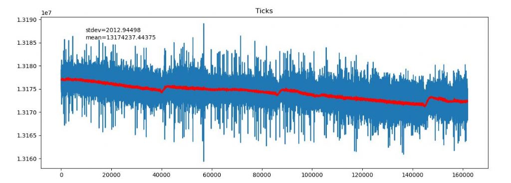

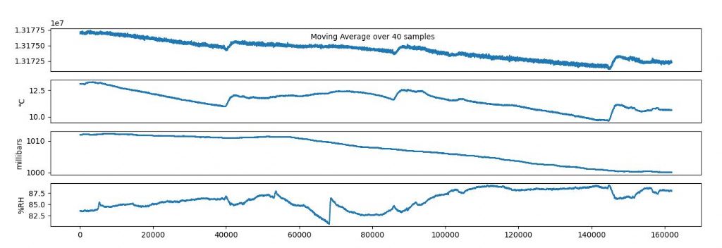

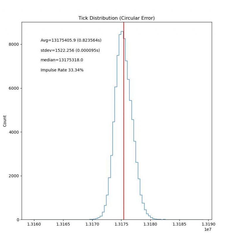

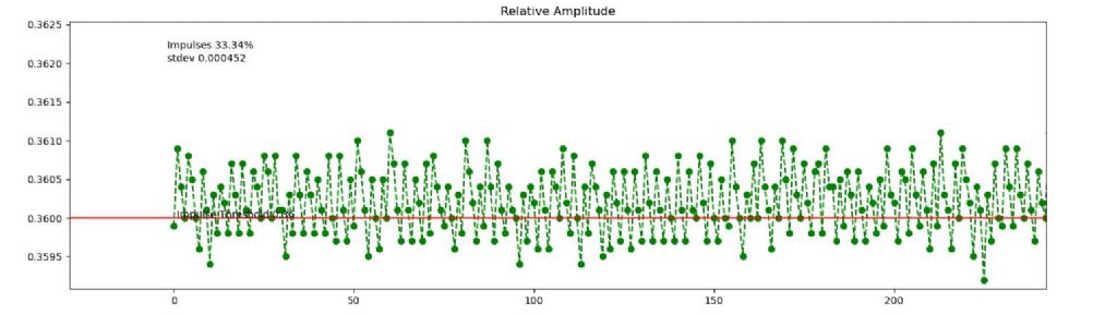

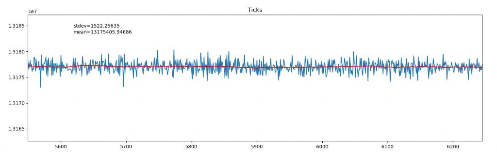

                    Even though still running on the old suspension. today's results are encouraging. The clock gained 10.36s in 19:33 hours, an error of 147 parts per million. Some way to go! In comparison:
                    • Ordinary quartz crystal about 100ppm (error 8.46s/day)
                    • Temperature compensated crystal about 20ppm (1.73s/day)
                    • Shortt Clock, about 1mS per day
                    • Oven Controlled Crystal, about 1 part per billion (84.6 microseconds per day)
                    • Ordinary Atomic Clock, about 0.001 ppb (84.6 nanoseconds per day)
                    • Atomic Clock Standard. 0.0001ppb (8.46nS/day)
                    What I believe the graphs are telling me:
                    There is no obvious sign in the tick timings that the controversial side impulse causes the pendulum's period to vary. The impulse is magnet ON for about 320uS, causing about 1 swing in 3 to be impulsed, effect of Relative Amplitude below
                    The relative amplitude has a small jitter that could probably be improved by making the impulse even shorter.
                    Circular Error has improved by a factor of about 10, but the distribution is slightly skewed, slow ticks predominating. Reason unknown.
                    The comparative graphs strongly suggest a correlation between temperature and ticks aka period. The temperature and tick moving average curves are very similar, including a bump when my central heating comes on. The moving average shows the clock tending to speed up over time, cause unknown.
                    The clock's performance may be better than 147ppm, which is an error 0.014714%. Apart from not being temperature compensated, the clock times on the assumption that the pendulum's period is 0.823685s. Not so: it's NPT measured average period is 0.823564s, introducing an error of 0.014692% Not going to claim anything because it may be a coincidence, but if the figures are trustworthy the clock's actual error might be only 0.000022%. Too good to be true I feel!

                        Now that I've realised that Dave impulses his pendulum at the centre even tho his electromagnet is at the end my reservations have evaporated
                        #624021
                          Posted by duncan webster on 08/12/2022 00:52:06:
                          The original clock had rather complicated software that fired the pulse 'n' microseconds after the bob broke the beam. As it was fiddly to set-up, I changed the code ages ago to fire the pulse immediately the beam is broken. Sorry if that wasn't made clear at the time.
                          However, because the beam is offset from the bob the impulse isn't applied conventionally when the bob is travelling at maximum speed, but nor is it applied when the bob is moving very slowly.
                          Period is measured as the time between beam breaks.
                          Relative amplitude is measured as the length of time the beam is broken.
                          The magnet is pulsed when relative amplitude falls below a threshold. At the moment, the threshold is a guess, and the pulse length tweaked manually after inspecting the graphs. I'm trying to find the combination of impulse power and threshold that keeps the pendulum swinging reliably at constant amplitude.
                          The clock can be told to alter the threshold and pulse length whilst it's running, so it might be possible for the remote program doing the statistics to home in on the combination, if there is one, that produces the most regular pendulum movements.
                          Mustn't get too carried away. There are mechanical improvements on the to do list. Most urgently I want to make a suspension as described by John, fitted with a longer thinner spring as suggested by Michael.

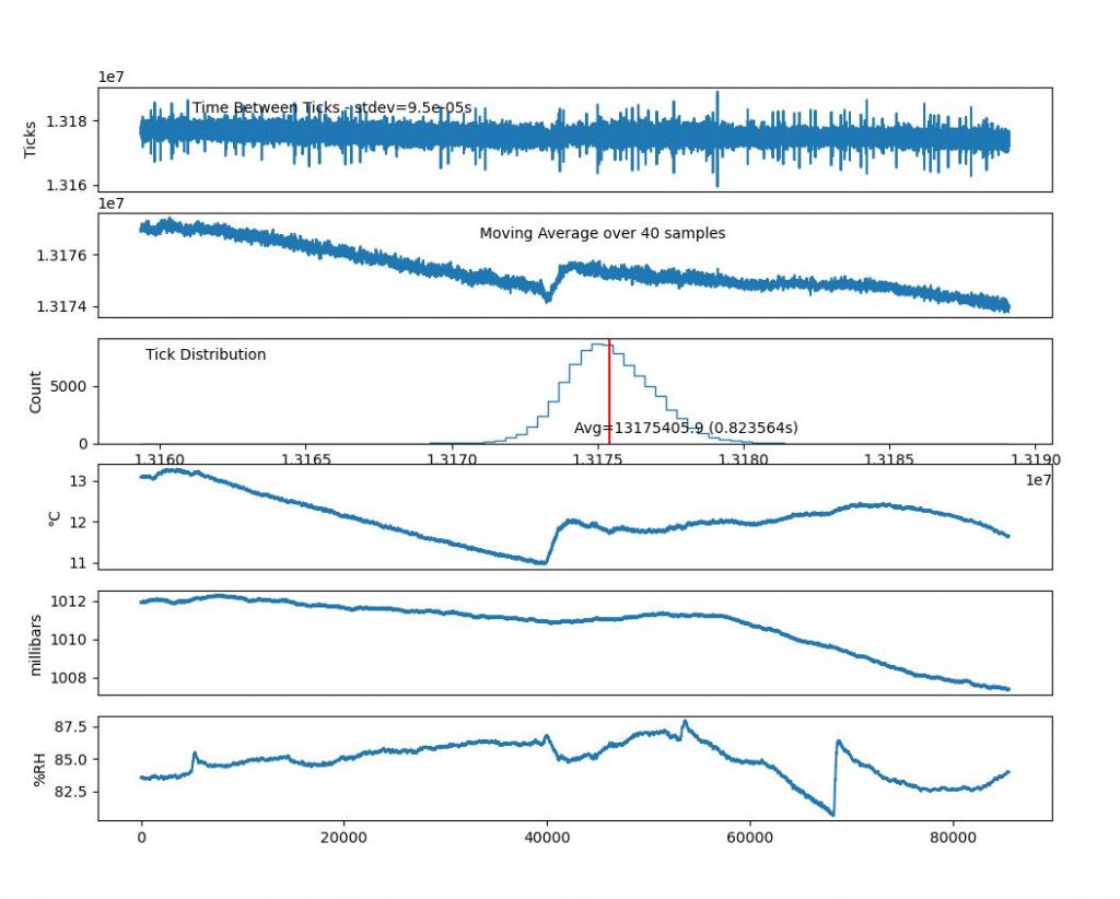

                          This morning's graph shows the need for temperature compensation: the red line is the moving average, smoothed over 40 samples, and jumps caused by the central heating coming on are obvious.
                          The graph also shows the pendulum is slowing down overall. I don't know why: the effect doesn't seem to relate to temperature or humidity, but it might be air pressure. Good news if the pendulum is responding to pressure, but I'm not confident my construction is good enough. Other possibilities are the pendulum lengthening due to the super-glue giving way, or the suspension spring pulling out of the clamps.

                              Posted by SillyOldDuffer on 08/12/2022 10:28:42:
                              I am intrigued by the pendulum’s apparently rapid response to the switching of the Central Heating, Dave
                              … I would have expected more latency, due to thermal inertia of the components, and to [presumed] insulation by an enclosure.
                              Perhaps I am mis-interpreting the graph

                                  Posted by Michael Gilligan on 08/12/2022 10:49:43:
                                  Well, the scale exaggerates the size of the bump. Zooming in makes it less obvious:
                                  On this scale the far less obvious bump extends over roughly 2050 beats. As each beat averages 0.823491s, that's about 30 minutes. Doesn't seem unreasonable to me, but I know very little about real pendulum clocks.
                                  The clock isn't in it's enclosure and it's fairly close to the radiator.

                                    Posted by SillyOldDuffer on 08/12/2022 11:37:29:
                                    Thanks for the clarification, Dave yes
                                    I confess that scaling the plot to accommodate the combination of ‘about 30 minutes’ and ‘seconds to six places of decimals’ befuddled the old brain a little.

                                      Confused…. The graph is of time for one tick, and ticks are getting shorter. This means it is gradually speeding up. The central heating warms it up and so makes the pendulum longer and makes tick time longer as I'd expect. I can't think of an explanation apart from senility on my part

                                          Posted by duncan webster on 08/12/2022 12:26:12:
                                          How about senility on my part, blush?
                                          The ticks are getting faster and the pendulum is speeding up. Duncan's right, I got it the wrong way round. Also, checking the graphs again, there's a clear correspondence between period and temperature! Duncan's right about that too.
                                          Interesting because the Mk1 pendulum was almost entirely carbon fibre and had a low temperature correlation. Now the rod has a brass and steel spring suspension, the correlation is stronger. So, back to the statistics to establish the correlation factor with a regression test, and then correct the tick count by applying a formula in the clock's software. This has always been part of the plan: analysing the log reveals the size of any correlation between temperature, air pressure and humidity, and. because the microcontroller measures them, the period can be corrected by the clock numerically.

                                            Looks like the combined effect of temperature and humidity. According to this the expansion coefficient of carbon fibre composite is 0.74 e-6 per degree C, which is very small indeed. Brass is 19 e-6 and steel is ~12 e-6. Aluminium is 23, so if you fit an aluminium sleeve of the correct length under the bob so it pushes the bob up as temperature rises it should be possible to tune out the temperature effect. Make the sums easier by having the interface twixt ally and bob at half the bob height. Come to think of it the bob expands as well, so having the support from the rod at the right height might just do it without ally sleeve. To a clanky this feels a lot more satisfying than measuring temperature and compensating for it
                                            Compensating for humidity needs a material which changes its size with humidity in a predictable way, and that material will also have a temperature effect. Once you've got the outer sleeve in place humidity variation should be much smaller, especially if you arrange some silica gel inside the enclosure and change it periodically
                                            #624135

                                                Oops, read the scales wrong, barometric pressure looks like the culprit, not humidity

                                                      I know that CF is supposed to be sensitive to humidity but I doubt that this is particularly a problem in a clock. The polymer matrix may change its size, but with a decent weight bob the load will be taken by the fibres not the matrix and the fibres are not affected by humidity AFAIK. My first clock had a 7kg weight on a 10mm dia 1mm wall tube, the new one has 5kg on a 6mm tube. Water is taken up by the matrix, but the change in mass according to something on the NAWCC website if at most 0.3% w/w, and if you take into account the very light weight of CF compared to the bob the effect on timekeeping is minimal. However such measurements as I have done do not include humidity, the next system will have a humidity sensor as well…
