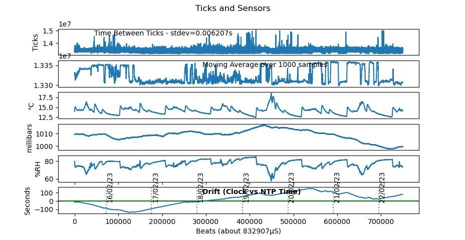

              #634739
                This morning's graph shows both good and behaviour at the same time, which is bad:
                When the log was downloaded, the clock was running close to the green horizontal line on the bottom graph ('Drift&#39. It's done particularly well over the last 14 hours, where it's kept good time (green ellipse). And overall, there's comfort in the whole trace not veering to one side of the line: on average it's not fast or slow.
                The top graph, period measured in 62,5nS ticks, tells a different story. It shows the clock is currently experiencing a bout of bad behaviour, which the log shows is due to an outbreak beam sensor misreads, about 1% count one beat twice.
                I urgently need to fix the mechanical clock! Would have started yesterday, except I've been diverted by unexpected Oven Controlled Crystal Oscillator (OCXO) problems, another tale of woe.

                  #635279
                    Final report on the clock before it's rebuilt! This afternoon's drift graph shows the pendulum has been losing time for four days, and is now 407 seconds slow after 12 days 9 hours (1,284,846 beats). Hardly a precision clock!
                    So I'm going to dismantle the clock next to my computer screen whilst I redesign the Mk 2. Although I have a partial CAD design of the original in F360, I'm going to start again with Solid Edge using the existing build to double check dimensions. The new version will fit into the same footprint unless I'm bent over a barrel and forced to make it bigger! I hope to re-use some of the bits.
                    Priorities are the suspension, the beam break system, and an adjustable carriage to support the sensors and electromagnet.
                    My statistics program and logging strategy need attention too. The current log is 165Mb, and processing it and producing the graphs consumes over a gigabyte of RAM, more than I expected. Not a problem yet, but a log covering a couple of months would be.
                    Performance isn't an issue: only 15 seconds from starting the program to printing all the statistics after crunching 15,418,152 floating point numbers. The graphs take a few seconds each. Anyone who fancies doing the same sums with paper and pencil is welcome to try!
