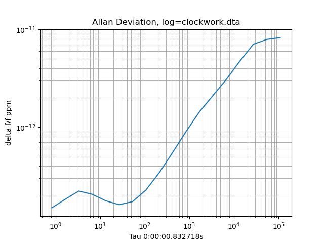

            This is the Allan Deviation for my clock, taken just now. It covers 460999 beats, (or 4 days, 10hours, 38minutes in real money.)
            Rawlings provides a table to help interpret the graph
            Gradient Cause
            -1.0 ……. Errors of observation
            -0.5 ……. White Noise (the ideal)
            0.0 ……. Normal Rate Fluctuation
            +0.5 …… Random Shifts in system parameters
            +1.0 …… Progressive change in system parameters
            My questions are:
            • Is my clock good or bad, and why
            • Why is the Y scale in the 10⁻¹² region, and what does it mean
            Please be gentle with me, my next project is a Dunce Cap.

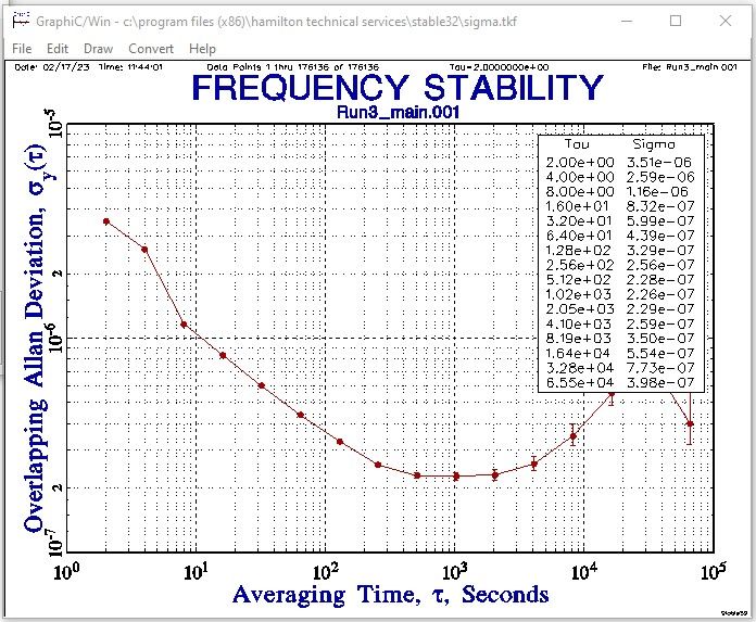

                  Here's one for a Shortt-Synchronome:
                  Be grateful If anyone can explain to this poor student how to read Allan variance.
                  embarrassed

                    How did you compute the AV Dave? I'm just getting to grips with it myself using Stable32 and TimeLab to analyse and plot. But your curve looks upside down compared to most I have seen.
                    This was the first respectable-looking plot I got from my clock, from about 3 days of data.

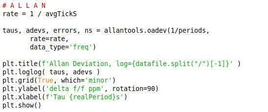

                      I'm using the Python 'allantools' module, described here:
                      The code, most of which is to draw the graph, is:
                      Could be calling the wrong function with the wrong data.

                              Glib answers at about 05:30 [not asleep but not really awake]
                              1. see [2]
                              2. either because your clock is much better than the Shortt, or because there is something ‘unusual’ about your data-set
                              #634279

                                    Not really noise analysis, although you can derive noise performance, phase performance, and other factors from the graphs.
                                    Allan Variance is however a prime measure of stability, NOT accuracy. The frequency being 'measured' can be inaccurate, but if it is STABLE, the graph will show it – A good double oven OCXO – 10 minus 12, Maser, 10 minus 16 @ tau 10 days… or better..
                                    Sheesh – I need to get a life..
                                    #634283
                                    Joseph Noci 1
                                      @josephnoci1
                                      Posted by SillyOldDuffer on 19/02/2023 18:26:28:
                                      My questions are:
                                      • Is my clock good or bad, and why NO IDEA! the data is incorrect – the graph is mirrored to start, cannot start with good AV and become poorer. Assuming the data set is reverse order, it is still meaningless – A mechanical pendulum with near 10 minus 13 AV would make you a miracle of the next coming…
                                      Please be gentle with me( NO CHANCE – you wanted to join Time Nuts..), my next project is a Dunce Cap.
                                      blush

                                          That's very helpful Joe! It means the problem is due to me not understanding how to use the software, and I can tackle that given time. The Python Allantools module provides several options, each of which has to be fed appropriate data, and I'm guessing.
                                          Garbage In, Garbage Out…
                                          I've probably got the same problem with FFT

                                            Dave, I got a quick intro to using ADEV from Tom VB. What I do is this (basically what I am told).
                                            • I measured the periods of the pendulum to get a long time series
                                            • Then subtracted from these a mean period computed from (another, previous) long time series (but could be the same one)
                                            • This gives an equally long series of period differences
                                            • Then do a running sum of these to get the phase (i.e. time) deviation from a uniform tick
                                            • Run the ADEV tool on these as phase data – I think this is the same as the "minimal demo" mentioned
                                            You could try Stabe32 and/or TimeLab as well – both are free and widely used by time nuts I think.
                                                    Thanks for the Allan hints, not what I've been doing! I'll give them a try. …
                                                    I was doing OK until bullet 4: 'Then do a running sum of these to get the phase (i.e. time) deviation from a uniform tick'
                                                    Could you give an example please showing how the operation would effect a vector of period differences?
                                                    What I have so far is an array (vector) of period values called 'ticks':
                                                    [13302951. 13296366. 13300221. … 13295832. 13303944. 13284340.] Each number is a period measured in units of 62.5nS
                                                    ( Only the first and last 3 elements of the vector are printed. The vector contains 531679 elements.)
                                                    np.mean(ticks) gives the average which is 13320548.098758837
                                                    ticks – np.mean(ticks) subtracts the mean from every element in the vector. Doing so gives:
                                                    array([-17597.09875884, -24182.09875884, -20327.09875884, …,
                                                    -24716.09875884, -16604.09875884, -36208.09875884])
                                                    I think of this operation as normalising the data, that is making each value relative to zero. Is that right?
                                                    By a running sum do you mean subtract each element in turn from the one in front, thus:
                                                    -17597.09875884 – -24182.09875884 = 6585,
                                                    -24182.09875884 – -20327.09875884 = -3855
                                                    -20327.09875884 – … =
                                                    which is, in python numpy:
                                                    normals = ticks – np.mean(ticks)
                                                    diffs = normals[0:-2] – normals[1:-1] # subtract each element from the one before
                                                    print(diffs)
                                                    [6585., -3855., -92042., …, 2044., -7831., -8112.]
                                                    Hope I'm on the right track, ta,
