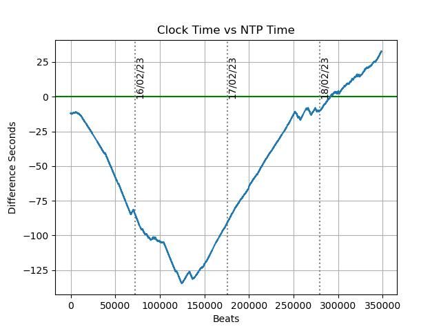

                                        Whilst busy playing with the M8Q GPS oscillator, I've let the clock run just to see what it does. Seems to be zigzagging:
                                        No idea why!

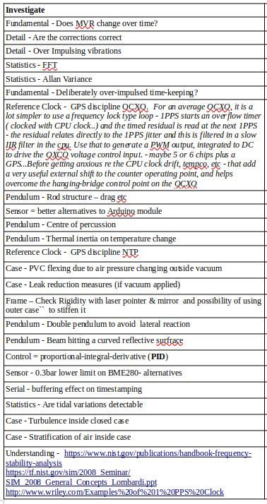

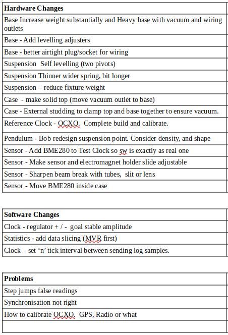

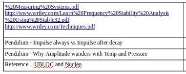

                                        Also wrote up my TO DO list:
                                        Too much!
