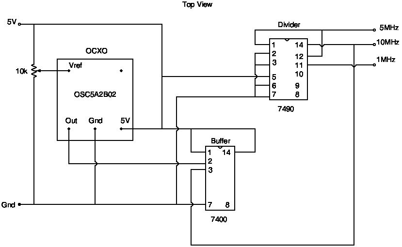

                    The replacement 7490 chip arrived so I plugged it, thanking the deity I'd used a socket, and it worked. This circuit:
                    So have a box that outputs accurate 10MHz and 5MHz signals. (1MHz also available if I take the lid off and move a jumper.)
                    Next problem is to tune it as close to 10MHz as I can get. It's not far off, but I'd like it to be good to a couple of parts per 10,000,000.
                    No luck so far finding an affordable and available Ublox GPS breakout board with access to both TP and TP2 pins.
                    And my clock is still misbehaving badly, drifting nearly a minute in 12hours. Crystal clear I need to get on and make a decent suspension.

                        Posted by SillyOldDuffer on 15/02/2023 19:09:51:
                        Do you not like power supply decoupling capacitor Dave.
                        Only asking but you will potentially get some noise from the NAND gates switching on the 5V you use to derive your Voltage Reference.
                        regards Martin

                          Oops. Missing from the diagram, but fitted to the real one. There's 100uF across the supply plus a 0.1uF decoupling pin 14 of the 7400 to ground, and another from pin 5 of the 7490 to ground, both short leads.
                          Well spotted!

                              Ah, thought that might be it. I really only commented ‘pour l’education des autres’ or whatever it is in French.
                              regards Martin

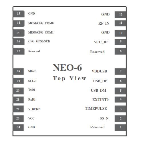

                                Disaster if 5MHz has jitter, but will it? 5MHz is 10MHz ÷2. It's the 1MHz signal I'd expect to jitter, due to ÷5.
                                There are various cheap NEO boards in the UK, but I'm not sure they're fit for purpose. This ebay example has no PPS breakout, and this one has PPS, but no TP2
                                The datasheet suggests no TP2 on the chip either:
                                Anyway, I've been reading the clear as mud ublox M8 Receiver Description page 270 and wonder if the UBX-CFG-TP5 message, with payload, allows TP2 to be soft swapped with TP1 when only one timepulse pin is available? So it might allow pps or a user frequency. Wishful thinking I expect.

                                      There is no TP2 pin on any of the GPS's – I have misread all data sheets and spoken C..p!
                                      There is only 1 pin, called timepulse, and it can be set to 1PPS ( mostly the default on all GPS's) or to anything else by means of the UBX-CFG-TP5 message as you describe – ON SOME, not ALL GPS's – so you have to dig deeper in the data sheet to see if its possible..If is indicates that the default is 1pps, but to refer to the RX description for more info, it can do it.
                                      All -7 and -8 series seems to be able to do it. Only the 6T seems able, so my neo-6 suggestion is useless.
                                      The easy way to set the TP5 message is to use the U-center SW tool. If the chosen GPS has FLASH, you can program it in hard and from next power on it is always there…
