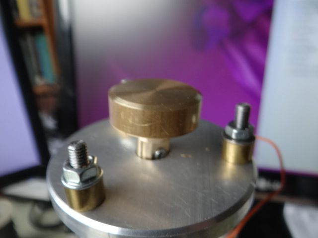

      After yesterday's power cut I moved the clock downstairs to make adjustments and noticed the top-cap wasn't seated correctly on the support tubes. (They sit in sockets.) So the top plate wasn't straight, embarrassingly visible in this earlier photo: dsc06651.jpg
      Correcting the assembly error dropped the bob so it just touches the base, so I made a new suspension piece lift it a few millimetres.
      Dismantling, I dropped the screw and the clamp on the floor, both bounced and took an age to find. On discovering the head of the clamp screw fouls the mounting hole, I got fed up, watched 'Jackass the Movie' instead and thought about taking up knitting!
      This morning the central heating failed to come on, fingers crossed I've fixed it.
      I had a quick look at the code to see if Peter's miscounting hypothesis holds water. The jury's still out. I found code dealing with both 'tick' and 'tock', but the 'tock' function seems to be about measuring how fast the pendulum is moving. Although it works, I don't remember how or why! More importantly I haven't confirmed my pendulum detect logic is correct, so Peter might be right.
      Anyway, what I need to do next is fix the mechanical problems and run the clock again for at least a day. Whilst doing that I shall look at all the posts. I've also been reading what Rawlings says about pendulums and suspensions in "The Science of Clocks and Watches'. I see I've been naive: it's another job requiring a wet-towel wrapped around my head!

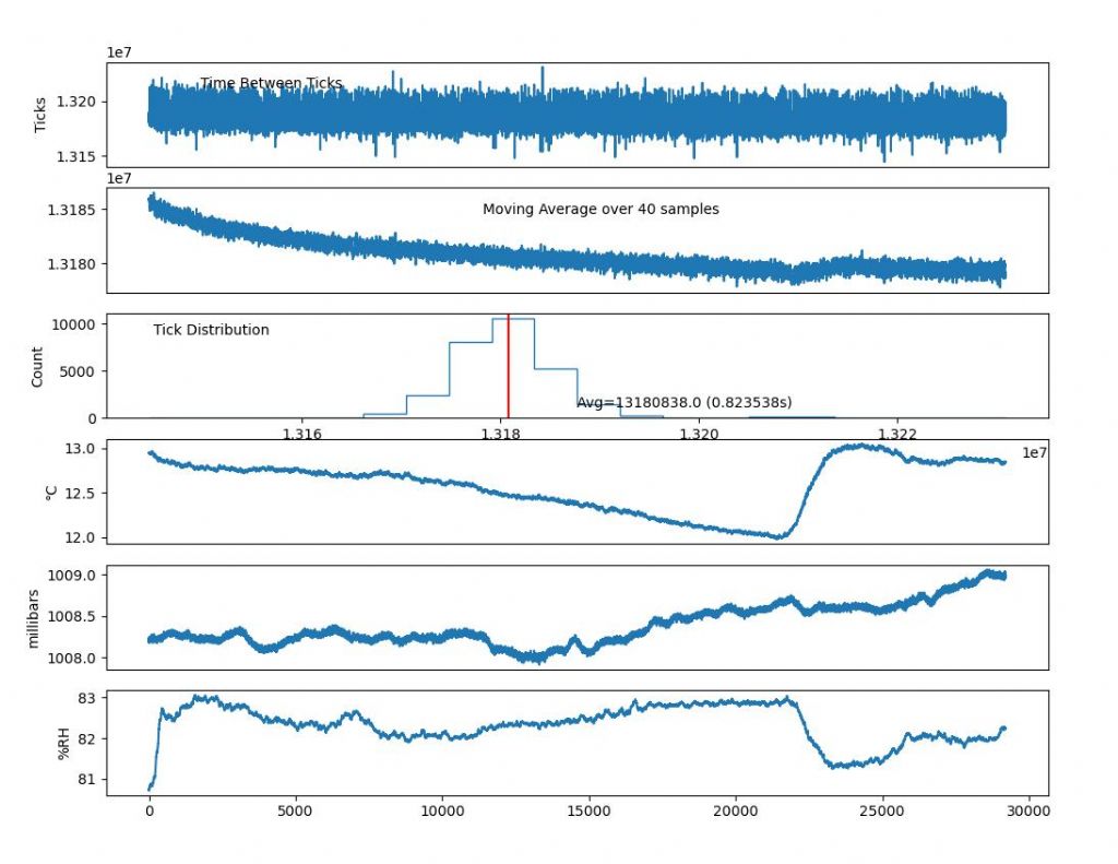

        Well, the clock is running again, and fixing the top to the columns properly seems to have fixed the strange double hump effect. The latest graph shows swing times peak at the average and fall off either side as they should.
        The adjusted pendulum is also swinging over a much smaller arc, and is only being impulsed once every 65 swings or so. Previously it was impulsed every 22 swings, implying Q is better now. It moves over such a small angle I'm worried it won't keep going!
        Possibly the double hump was caused by the suspension spring being lopsidedly loaded when the top was at an angle. Dunno.

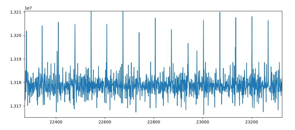

                    These graphs confirm I think what's being said.
                    Zooming in on the ticks shows the impulse causes a significant disturbance:

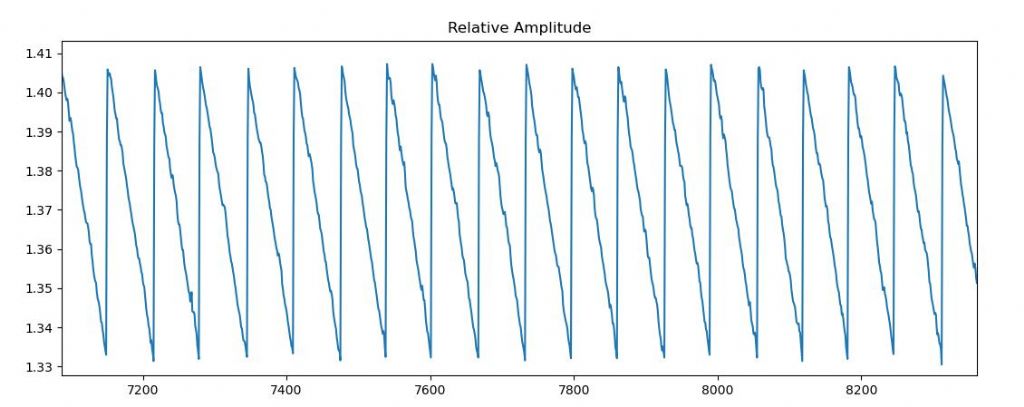

                    The same effect can be seen on the relative amplitude, which decays until kicked by the impulse, creating a saw-tooth:

                    So next step is to tell the software to reduce impulse length. It's set to 8uS*200 at the moment, 1.6mS, and I'll try halving it.
                    I think Peter's explanation of the earlier double hump distribution was correct. The pendulum rod is only 0.8mm in diameter, deliberately chosen in the Mk1 clock to be whippy. In line with John's comment that variation doesn't matter much as long as it's consistent, I hope the pendulum will keep eventually keep good time even though it's probably bending a little.
                    The amplitude data shows the impulse fires unnecessarily once in every 2000 beats or so. I suspect the software. One of the nice things about this clock is it has hardly anything mechanical for me to mess up; unfortunately I'm perfectly capable of getting the software wrong too! A quick fix might be to impulse only after relative amplitude has fallen below trigger point twice in succession.

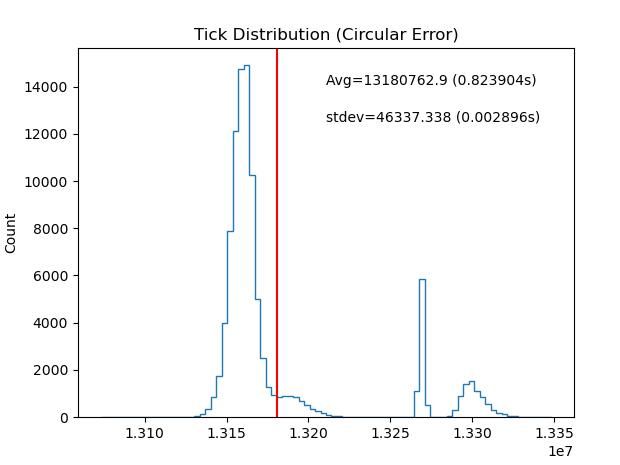

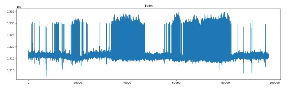

                                    This morning's results are disappointing even though the time-keeping was closer to reality: 36 seconds slow after 22 hours. The run was intended to test reduced impulses, 0.48mS rather than 1.6mS.
                                    Sadly the Tick Time graph shows bursts of wild pendulum behaviour. Not good.
                                    And the Tick distribution shows three modes, which skew the average well away from the mode, and a high standard deviation of nearly 3mS, yuk:
                                    I think the fault is due to moving the clock physically to apply software upgrades. Not much stops the bob bouncing about in any direction. As already pointed out my suspension design is flawed, and I think mechanical issues are more likely to explain major misbehaviour than me tweaking the software:

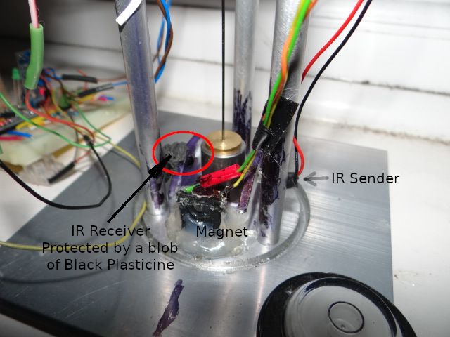

                                      How are you sensing Dave? I have seen some wild behaviour using opto interrupters due to ambient light.
                                        Here's a photo:
                                        The black and blue felt-tip pen ink marks are the remains of colouring in to reduce reflections off the steel bob, aluminium frame and shiny white plastic innards. I dropped the current to the IR sender with a 68 ohm resistor for the same reason.
                                        To protect the IR receiver from ambient light, the back of the sensor is embedded in black plasticine. Strong ambient light alters the sensitivity of the sensor unless it's protected.
                                        I didn't think ambient light was likely because the weather here is a foggy gloom, and much of the run was after dark. However, taking the photo did me a favour! Moving in for a close up I heard a tiny click, caused by the bob hitting the magnet. No wonder the tick timings are bad.
                                        I'm going to restart the clock with a smaller impulse. Luckily, I reprogrammed the microcontroller last time to take commands that reset the nominal period, impulse threshold and impulse length without physically touching the clock: moving it is definitely bad.
                                        The way I measure 'amplitude' is under review. Period is the time between beam blocked events. I also measure the time taken by the bob to overfly the beam – how long the beam is blocked – and use the ratio "Beam Blocked" to Period to indicate relative amplitude. Looking at the code after Peter's comments I'm not sure the way I implemented this is correct.

                                                    Mixed result this morning, With reduced impulse, the pendulum is still being bumped:
                                                    But the tick distribution is better:
                                                    Despite the impulse bumps, this is the best run yet: my clock is 0.792secs fast after 12 hours 21 minutes.
                                                    Gut feel is the impulse is much too strong, so I'll reduce it. Fingers crossed, the circular error will fall again.

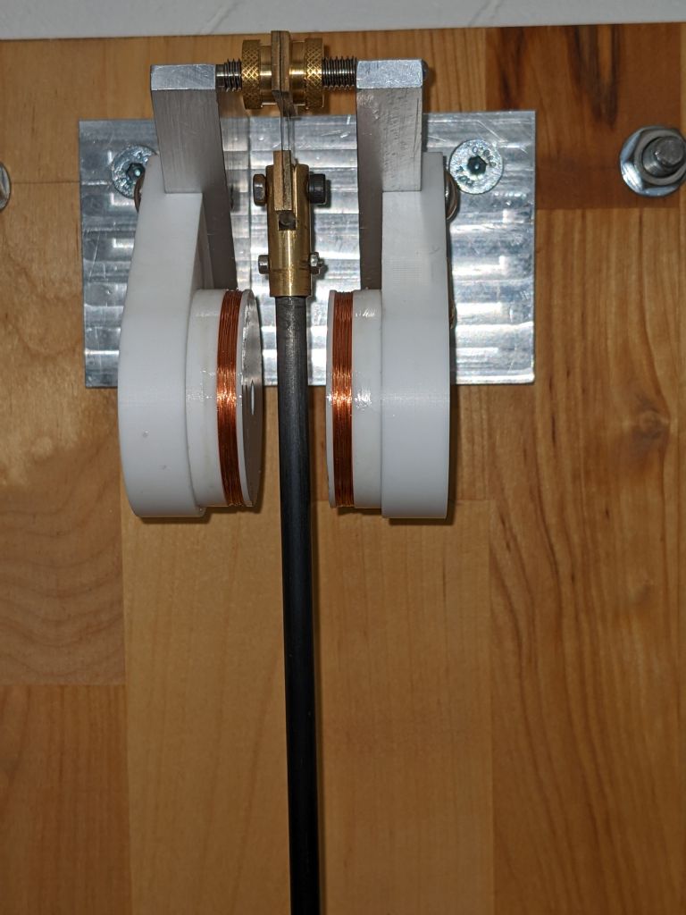

                                                      Hiding inside the 6mm CF tube which forms the rod is a 13 x 3mm neodymium bar magnet which is transverse coaxial with the Helmholtz coils either side of it. When the coils are driven the magnet tries to line up with the field, exerting a torque on the pendulum. Sensing is by a slotted vane on the bottom of the bob. The pendulum should be startable by sending alternating current pulses to the coils at 0.5Hz. The scheme certainly works with the bob removed, but the Q is such that it will take nearly 2 hours to reach working amplitude with it attached! This scheme made possible by using carbon fibre tube, it wouldn't work with a steel rod.
