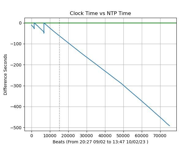

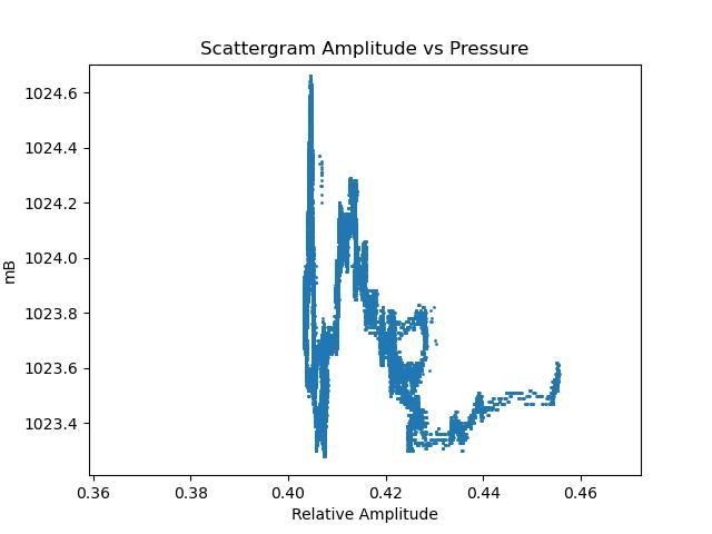

            Bit the bullet, and as expected my clock is a suitable case for treatment!
            Glad tidings first: no bad sensor readings and drift looks constant (ie. easy to compensate), though there may be a knee at beat 50000:
            Next the headaches!

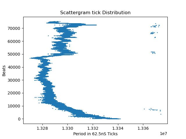

            Tick distribution shows low Q and a wide double spike. This is characteristic of over-impulsing:
            Same problem with the tick scattergram, showing period is seriously unstable over time. The standard deviation is about 5mS, about 500 times too high:
            The obvious next step is to reduce Impulse power, but I'm thinking it's time to rebuild the clock to profit from lessons learned. I'll type up the improvement list later for comment.
            Duncan asked about Amplitude vs Pressure, and whilst they correlate, it's not as I expected:
            Like Amplitude vs Temperature the relationship wanders. Although at a given time seems Amplitude & Pressure map consistently to a given X,Y coordinate, at other times they map somewhere else! Can anyone explain it? My best guess is another independent variable is skewing the relationship.
            I'm a little disheartened. Attempting to improve the clock has made it worse. AGAIN!

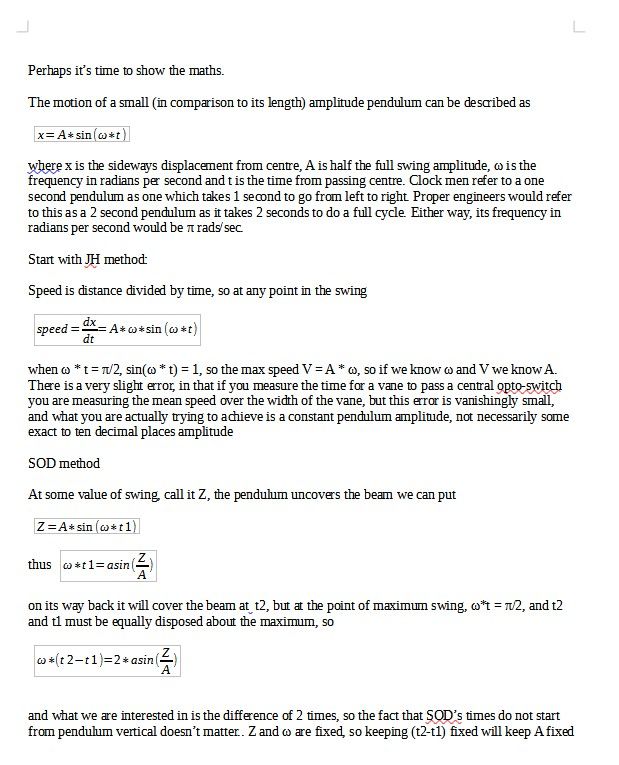

                        Do you want to sit squinting through an eyepiece 24 hours a day noting down values of amplitude every 2 seconds? Even then HJ only measures at the end of travel, he is not measuring magnitude, he is noting difference. I suppose he could have mounted his microscope on a long micrometer affair, but even then he'd struggle for 10ths of inches. The half amplitude of a 1m pendulum is ~52mm if it is swinging +- 4 degrees, so measuring to 1/00 mm as in the link is one part in 5200. The electronic flag method can get times to one part in 16 million. I'm pleased to see that even back in the 40s, sensible people were talking in metric.
                        For those sad enough to want to see my sums see below
                        Edited By duncan webster on 10/02/2023 17:02:25
                        Edited By duncan webster on 10/02/2023 17:12:35

                          #632941
                            Well, Duncan … I have read it, and at least we are in agreement on “what you are actually trying to achieve”
                            i.e. a constant pendulum amplitude, not necessarily some exact to ten decimal places amplitude
                            That sums it up nicely ^^^
                            But what I still fail to understand is why, therefore, everyone wants to derive something which can be physically measured.
                            On the reasonable assumption that any system producing amplitudes substantially greater or less than our target can be disqualified [because it renders the pendulum not fit for purpose] all we need is to detect ‘delta’ variations from the target value, and I suspect that even a 640 pixel wide sensor would easily suffice for that. … Ideally, every swing would shade the same pixel and, as I suggested before, scaling such that 635 pixels saw 1/4” we could have a central target line with +/- 317 pixels for detection of over-swing/under-swing [other scaling values are readily available]
                            I have no axe to grind … I just don’t understand why it is considered better/easier to do these calculations.

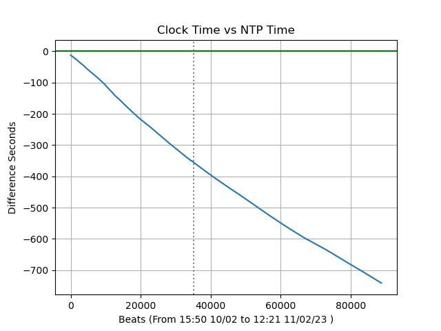

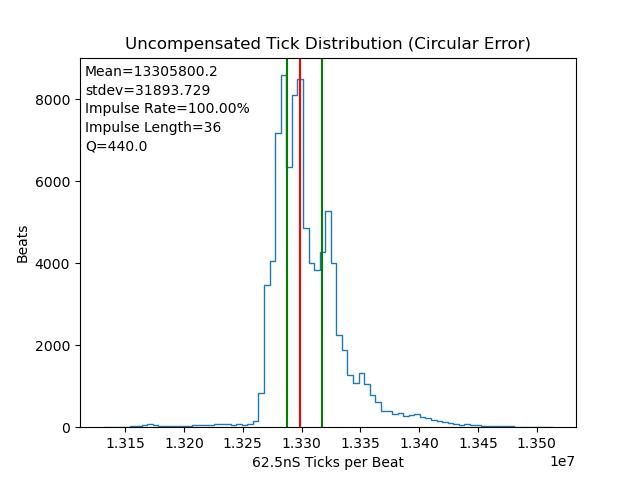

                                              Today's graphs show yesterday's Impulse reduction wasn't enough. Though sharper (Q=440), the distribution is still skewed and has 3 peaks. (Ideally only one, same slope on both sides, with a narrow base, Q=10000-ish) Not like this:
                                              The log shows changing impulse caused an outbreak of wild swings that nook nearly 3 hours to settle:
                                              Not sure why, except I happened to change impulse just as the central heating came on, so two changes at once, three if relative humidity counts. (Don't believe it does.)
                                              Otherwise good news: clock vs NTP (drift) is pretty constant, with no time jumps due to the beam not being broken cleanly.
                                              An observation: despite being out of adjustment and behaving badly, my clock still keeps mildly good time on average. I've noticed this effect before and believe other pendulum clocks probably behave the same way. However, it may not matter! If a mechanical escapement causes impulse strength to vary and the effect averages out, it's not easy to see the error. Individual second beats can be obviously wrong, making the clock an untrustworthy sub-second timekeeper, but there's a good chance the 'going' mechanism will average them out so the clock performs well over days, weeks and months. Especially well if it has no seconds hand!
                                              Moving on I've reduced impulse again and have to wait several hours to see what happens next. It's like watching paint dry!

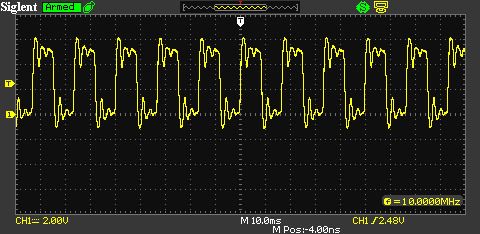

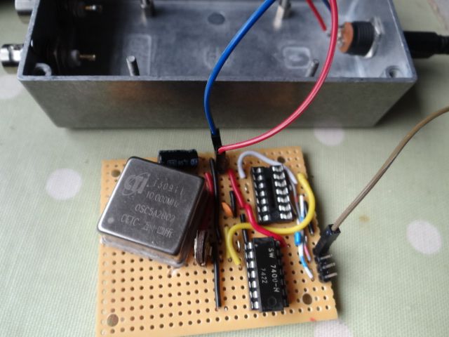

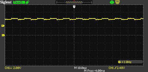

                                                Diverted this morning into rebuilding my OCXO, after wiring the divider IC mirror image in the the first version. The new one doesn't work! Note that the divider chip isn't plugged in, and can't be to blame.
                                                The part of the circuit that's not working is the easy bit! I buffer the OCXO output into a NAND gate, to increase the fan out:
                                                Input to the NAND gate from the OCXO:
                                                And then it all goes wrong, output from the NAND gate:
                                                My electronics, never brilliant, is also rusty. I believe HCMOS should be able to drive a single TTL gate, and also that I can leave the inputs and outputs of the other 3 gates on the 7400 floating.
                                                The mark one version worked OK, the only difference being I wired the other gate input HIGH, rather than LOW in this one, simply because the ground rail is adjacent. Surely this wouldn't stop the gate working?
                                                Have to go out this afternoon so I'm hoping a clever member can tell me what I'm doing wrong.
                                                Thanks in anticipation,
                                                #633127
                                                Joseph Noci 1
                                                  @josephnoci1
                                                  Yep, it will….
                                                  An AND needs both in's to be high for the out to be high, else the out stays low forever…NAND just inverts the state is all…So high on one, then the O/P toggles in sync with the 2nd in.
                                                  #633142
                                                    Posted by Joseph Noci 1 on 12/02/2023 13:18:28:
                                                    Yep, it will….
                                                    Aargh, of course it will. Now I feel REALLY stoopid! I might never have twigged due to becoming engrossed in unlikely explanations. If only I'd drawn a truth table…
                                                    Many thanks,
                                                    blush
                                                    #633145
