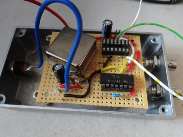

                          A heartbreaking mistake in the OCXO:
                          Someone has wired the empty socket back to front. He remains nameless to spare his embarrassment. The mistake is so serious I can't bear to think about it. Probably have to make another board from scratch. Started badly and finished worse. Works perfectly apart from the divider chip, where all the pins are wrong.

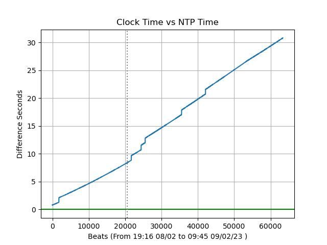

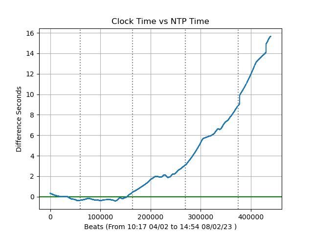

                          Meanwhile the clock is drifting even more badly:

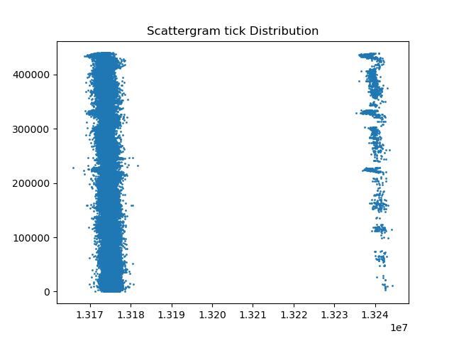

                          I think the problem is over impulsing, probably because the suspension is coming loose! The scattergram below shows two modes of oscillation, the dominant one centred near at 13175000 ticks per beat, the weaker near 13240000 ticks per beat. In the past the effect has been caused by over impulsing:
                          The weaker mode is getting stronger with time. As the impulse is accurately constant and nothing else has changed. I think the drift is due to a mechanical problem in the suspension.

                            Good job I didn't rip the clock apart – it was over impulsing because the wrong impulse value was loaded. Four days wasted, try again…

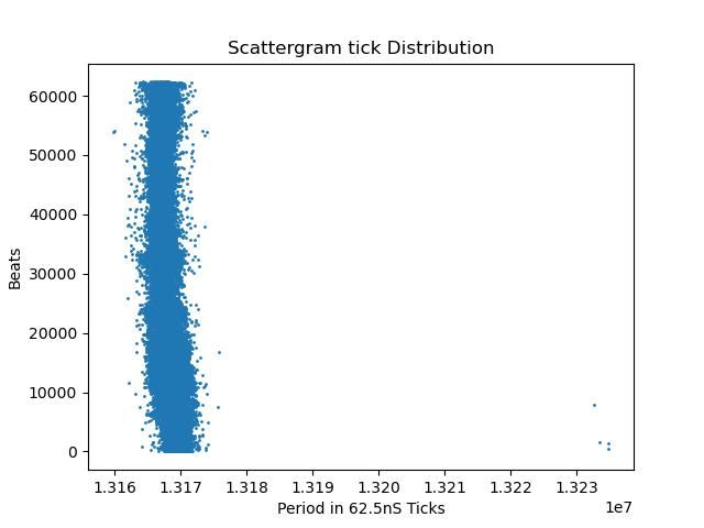

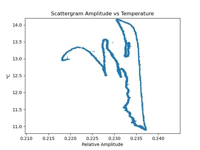

                                      This morning's results are revealing. Last night I restarted the clock after finding it was being over impulsed, reducing impulse from 28 to 24.
                                      The second mode of oscillation has almost disappeared, with 4 examples far right bottom when the clock starts.
                                      Some off-centre vibration is expected because the clock auto-starts by applying a 2 second pulse to the electromagnet. The pulse is powerful enough to pull and hold the bob on the pole. When the start pulse ends, the bob swings violently for about 10 minutes, stays somewhat disturbed for about an hour, after which it swings up to the design amplitude, which is small. Or rather that's what I mean the bob to do! (In a an earlier version I attempted to start the clock gently by pulsing the electromagnet weakly at the pendulum's resonant frequency. Worked unreliably when I had to physically move the clock to make software changes. Ought to have another go now the clock doesn't have to be touched, otherwise I have to ignore the first 5000 statistics after a restart.)
                                      Looking at the drift graph shows another problem – steps are back:
                                      The vertical dotted grey line marks midnight.
                                      Steps are caused by the bob not quite breaking the beam reliably. They're caused by the impulse being slightly too weak to pull the bob fully across the beam 100% of the time. Bit of a quandary: increasing impulse causes the amplitude to rise excessively, whilst reduced impulses cause unreliable beam breaking!

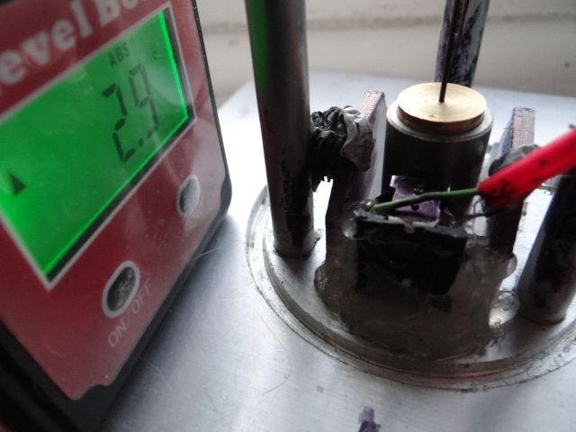

                                      What to do about it? Ideas so far:
                                      • Sharpen the beam so the bob breaks it earlier.
                                      • Provide a method of moving the beam sensor so the bob breaks it earlier.
                                      • Go back to governing amplitude, so the bob isn't impulsed above a certain threshold. The code for this already exists, turned off after I discovered my pendulum keeps better time when impulsed lightly on every beat, rather than more powerfully after 'n' beats. I probably need to be more sophisticated, by always impulsing below a minimum threshold, and never impulsing over a certain maximum.
                                      • Tilt the clock slightly so the bob hangs a little closer to the sensor at BDC.
                                      Other suggestions welcome!
                                      Looking at the earlier strange Amplitude vs Temperature graphs showed the Possum look is due to a succession of rounding errors causing the graph software to struggle with a narrow range of quantised data. However, something odd is going on:
                                      The graph above, scaled to hide rounding striping, shows there a weird relationship between temperature and amplitude. The two correlate in a non-linear way. Although amplitude obviously follows temperature, the path is inconsistent. For example, six amplitudes correlate with 13°C.
                                      The effect of temperature on amplitude can also be seen on the next graph, green line:
                                      What fun!
                                      As it's easiest to do, I'm going to tilt the clock slightly.
                                      Edited By SillyOldDuffer on 09/02/2023 11:40:50
                                      #632757
                                        Tilting the clock didn't help, so I took it apart and masked half the IR sender and receiver with Bluetack.
                                        Now the clock doesn't run at all…
