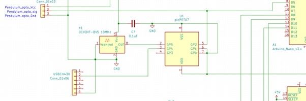

According to leapsecond.com you can drive a picpet with 20 Mhz, no intention of going back to pics, they made my head hurt, and that was 10 years ago at least

After publishing the link I noticed the code was configured to use an external clock, which needs an oscillator connected to Pin D5. Line 37:
#define EXTERNAL_CLOCK
This is an advanced option, and the default should be to use the internal 16MHz oscillator. So I changed Line 37 to:
#define NO_EXTERNAL_CLOCK
This is the latest download link. John probably downloaded the EXTERNAL_CLOCK version before I changed it.

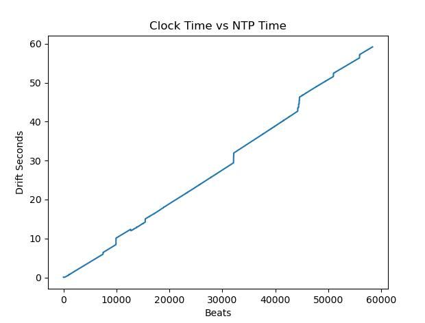

Woe, woe and thrice woe! The step problem is still unfixed:
A straight line rising diagonally from 0,0 is fine, because steady drift at the same rate is easy to fix. Step jumps are unacceptable, and in my case they are all associated with mangled data:
12735 13240093 0.2605 0.3600 28 981.84 0.00 9.74 824447 1674000470 843515 1674000458 800457 0.006643000000000399
15457 5079547 0.0000 0.3600 28 982.08 0.00 9.33 824446 1674002714 987039 1674002700 289264 -0.5089489999999994
15458 8170408 0.0000 0.3600 28 982.08 0.00 9.33 824446 1674002715 811485 1674002700 798200 -0.31550999999999974
Beat number 12735 has been reported as bad because it's over 5mS different from the previous tick. But it's not corrupt: a period of 13240093 isn't too far off the average 13206989, and an amplitude of 0.2605 is OK too.
However, beats 15457 and 15458 are both obviously wrong and they cause gross reporting delays of -0.5089s and -0.3155s. A jump of nearly 1 second. Interestingly the clock reports the time correctly, and the step occurs because the report takes tenths of seconds to get from Arduino to RaspberryPi. The data corruption and delay are both clues!

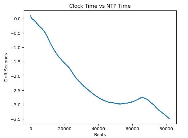

Last night I gave up on the stepping problem, whereby every so often my clock apparently jumps compared with Network Protocol Time:
It doesn't really jump – the problem is something wrong in the logging software, written by me. Wasted days trying to fix it with no success. Anyway, noticing that apart from the steps the graph line shows my clock drifts fast compared to NTP by a more-or-less constant rate, I decided to fix that.
The clock software already compensates (imperfectly) for temperature and pressure, so I added the code necessary to compensate for constant drift, recompiled, and restarted a new log, resulting in:
Though still not right, this is much better. The clock is now slow by 3.5 seconds (in 19 hours) rather than 65 seconds fast. However, whilst the drift compensated graph is nearly straight, it bumps upwards at about 65000 beats. This I think correlates to a drop in air pressure followed by a rapid rise in temperature, see below:
Not worried much because I already know the way I compensate for temperature and pressure combined is flawed. Although the maths in the clock is better than not bothering, the clock is still obviously sensitive to temperature and pressure change. (Obviously sensitive to statistical analysis, not the human eye!) Thanks to John H, I have the analytical method needed to produce the numbers required to improve the clock's compensation, fingers crossed.

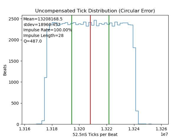

Two new mysteries! Although I only made a simple addition to the code, with no obvious relationship to the stepping problem, last night's run was perfect – there are no incorrect steps in the log. Good news except I don't like problems that fix themselves by magic. Probably still lurking in the undergrowth waiting to bite me again.
Also odd is the Q measurement and underlying tick distribution. Normally I get a spike graph like this example:
Not so, last night the Q apparently fell from about 9500 to 487, due to the period measured in ticks falling almost equally across a range, an unnatural distribution:
Might be another software problem. Has to be investigated. More work!!!

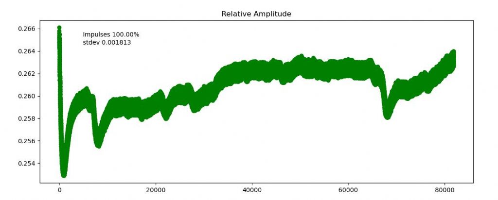

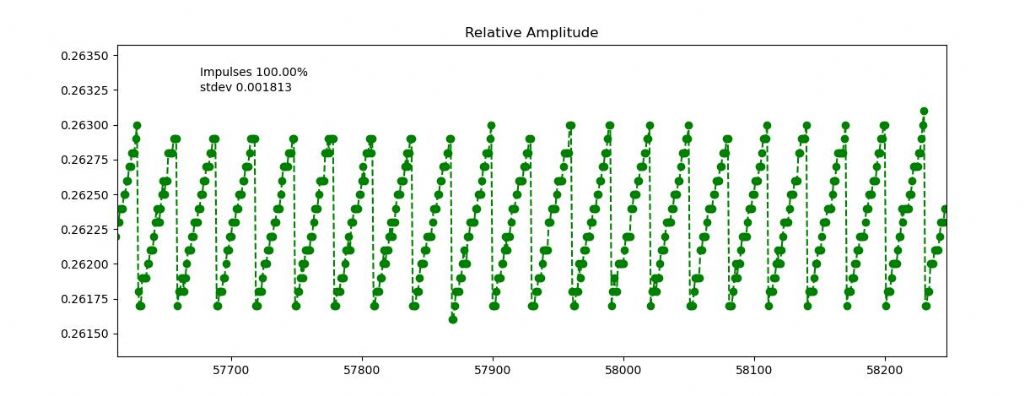

Another mystery from last night's run. Amplitude varies predictably even though there's a constant impulse on every beat. Zooming in:
Relative amplitude appears to rise from about 26.175% to about 26.28% in 22 consistent steps and then drop back. Given the pendulum is getting an accurate constant impulse I would expected amplitude to vary randomly about the mean. I've no idea what would cause a zigzag, yet there it is! Almost as if amplitude builds up until something gives way and releases the energy with a bump. Most odd.
Relative Amplitude varies strangely over the long run too. Not by much, less than 1 part per thousand, but the graph shows something effects it. Possibly temperature. Dunno.
Why is nothing ever easy?

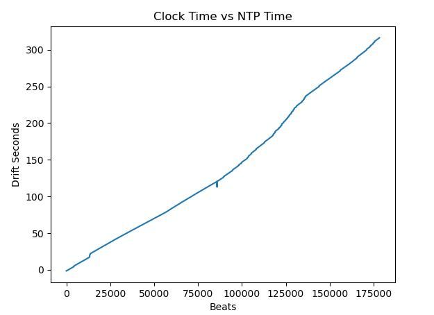

I left the clock logging overnight without making any changes:
Whatever was causing step jumps has stopped. There's only one jump, circled in red, and checking the log shows it's different. The step jump errors that caused so much grief were obvious data corruptions associated with malfunction of the serial data link. Something truly nasty. The single example in last night's run is consistent with a sensor error. The step is due to the clock reporting two beats, when there was only one. The Arduino counter-timer reported a period lasting 3587640 cpu ticks, followed by a second period of 9708108 ticks. These add up to 13295748 which though high suggests a normal tick was miscounted, cause unknown.
Looking at the Drift graph (Clock vs Network Protocol Time), the line confirms a constant drift amounting to a little under 37 microseconds per beat, which I can correct without stopping the clock. (If the new code works properly!)
The bumps in the line, highlighted in the Green boxes above, look to be associated with temperature change. The relationship isn't obvious because air pressure and temperature both effect pendulum period and can compensate or reinforce each other. But the biggest bump (leftmost green box, around beat 63000), aligns with temperature and pressure rising together.
That my compensation is wonky is fairly obvious from the graphs. Although Compensated Period is mostly temperature corrected, it follows air-pressure changes almost exactly. The maths is wrong, so that's the next job. Whilst rewriting the software, I'll let the clock run with a further 37uS drift correction to see how close it stays to NTP time.
Just to be clear, the clock is running independently. The pendulum isn't being time corrected by the Arduino quartz crystal or GPS. Instead it counts average period in microseconds compensated for temperature and air pressure, albeit imperfectly. That causes a new problem! Counting in microseconds is flawed because it limits average period precision to ±1uS. Will switch to counting in tenths of uS or Nanoseconds later, if the pendulum performs well enough to justify improved counting.

If I were you, I'd stop thinking of your measurements as "amplitude" and just call it what it is: "period." Yes, I know it's related, but you aren't actually computing the amplitude (e.g. in degrees) from period, are you? You are just measuring and plotting the period.
I still think there's some beat-type situation going on. I can totally see ~22 x ~3ns errors adding up to 64 ns and then starting over somewhere in your system.
In reverse order, I've been through the logic looking for an integer rounding effect. I'm using binary arithmetic for efficiency and 'relative amplitude' is calculated in micros(), an Arduino time function that increments in 4uS steps. No joy with that so far. I'm about to try altering the impulse power, ie pulse length, to see if it changes the waveform. Might prove it's a beat effect.
I'm calling it 'relative amplitude' because, though derived from period, it's not period. And I'm already using period to name the real one measured in 62.5nS ticks. 'relative amplitude' is a comparator rather than a accurate measurement, just a way of indicating is rising or falling. A bit of maths acts (I hope!) as a kind of digital filter because period measured in 62.5nS ticks is rather noisy, making it difficult to reliably detect decay directly. At the moment the measurement isn't used for anything because the impulse was set manually. It becomes important if I go back to actively governing impulses.

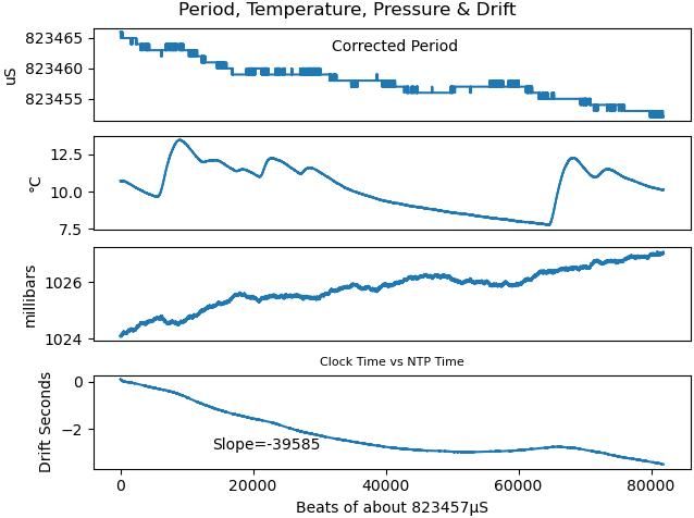

Last night's run was "quite interesting".
The clock is keeping it's own time, whilst logging actual period, clock-time, temperature and air pressure to a raspberryPi that timestamps each log entry.

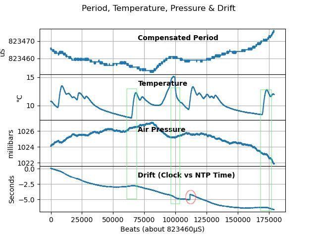

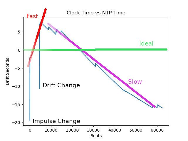

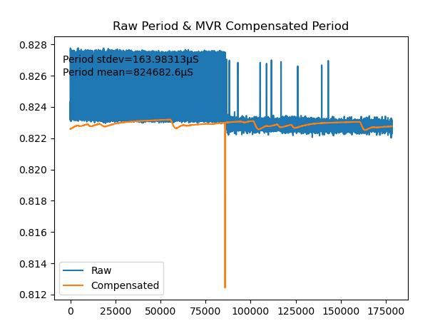

Yesterday's log showed clear evidence of over impulsing, and a steady drift. So at beat 86380, I sent the commands needed to reduce impulse from '28' to '20', and to compensate for the steady drift.
Result this morning:
On the left, period in blue shows many spikes (actually about 1 in 30). On the right, after impulse power was dropped, the number of spikes is much lower. Conclusion: over impulsing was disturbing the pendulum, and might be good to drop the impulse a little lower.
The orange line is period corrected by the clock compensating for temperature and pressure using values obtained by applying multivariable regression to previous statistical data. Not quite right because the line visibly bumps when my central heating comes on morning and evening. The error is partly because the regression was applied to only 18 hours of data, when it should be at least a week's worth, ideally more, and partly because changing impulse changed period, so the earlier period/temp/pressure relationships are skewed.
Reducing impulse had an obvious effect on Q too:
Three peaks! The first and third (at 1.324) are from the strong impulse, the second from the weaker. Changing impulse power altered the pendulum's period, or, in old-fashioned parlance, 'the pendulum was dominating the clock', not good. Impulsing too powerfully shifts the period slightly, reduces Q, and – in this clock – creates a second mode of oscillation at about 13240000 ticks per beat.
Improved Q is visible in the second reduced impulse peak, because it'is taller and sharper than the first. Overall Q has dropped to 1790 on the graph because the data covers a shift in frequency. Earlier runs showed Q approaching 10000, which is good for an ordinary pendulum, but on my clock only if the pendulum isn't over impulsed, and it's sensitive. The effect of over impulsing is probably worse in my pendulum because the bob is very light. Less than 30g, compared with the usual few kilograms in pendulum bobs.
Annoying mistake, I got drift correction wrong by entering the correct number with the wrong sign, making drift worse:
Slightly worrying is drift appears to have become less constant after reducing impulse. More to do.
Edited By SillyOldDuffer on 29/01/2023 12:34:49

Couple of blunders yesterday:
So restarted last night with a little more impulse oomph, and after realising the drift correction unit was wrong, put in a better number. A step in the right direction – the code is working:
The graph shows shortly after the clock started, I increased the impulse, first down spike. The clock then ran fast – red line – compared with Network Protocol Time until I changed the drift compensation at about beat 5000, after which the clock runs slow – purple line.
Still not correct – the target is a flat horizontal line on zero – the green line
Just now, the statistics told me error overnight was 208.24uS per beat, so I have to tell the clock to compensate by +3332 ticks of about 62.5nS each. I shall issue the necessary command now and see what happens.

Meanwhile, I've identified another problem with my statistical strategy; the weather!
Previously, weather's been delightfully changeable with plenty of big temperature and air-pressure swings. Lots of change are just what's needed to identify correlations, whilst settled weather doesn't provide good data. The statistics have nothing to work on unless temperature and air pressure in the dataset change significantly. It means I have to collect a lot more beat data at he moment before trusting an analysis intended to identify the perfect compensation between drift, temperature and air-pressure.
