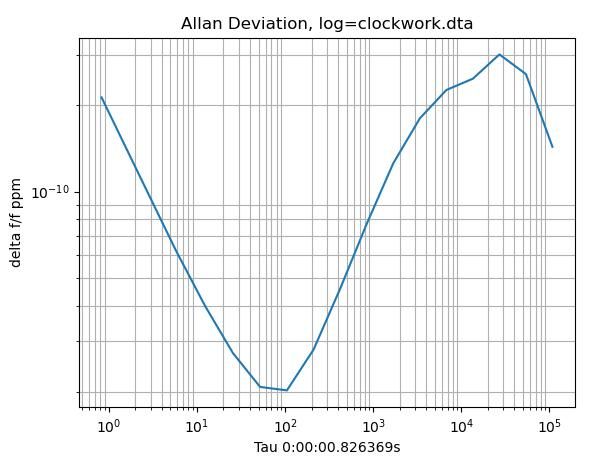

                        Re Allan, I'm measuring short term pendulum with timings with a 16MHz crystal, whilst the crystal is measured with a GPS pps reference. This mostly compensates for crystal instability, mostly due to temperature. Long term performance is measured relative to ordinary NTP, but I'm not using that with Allan.
                        The latest graph:
                        The tau value looks OK, and is in the right range 10⁰ to 10⁵
                        Not sure about 'delta f/f ppm' because the range 10-¹⁰ is tiny. The curve might be right, but what does it mean.
                        What it's displaying is 'Pendulum Period Time, measured in ticks with a 16MHz crystal, that's been compensated relative to a GPS pps tick, where the tick has been converted and rounded to microseconds by diciding by the crystals average frequency'. Feel free to say if this is bonkers, I don't really understand what I'm doing!
                        Thanks

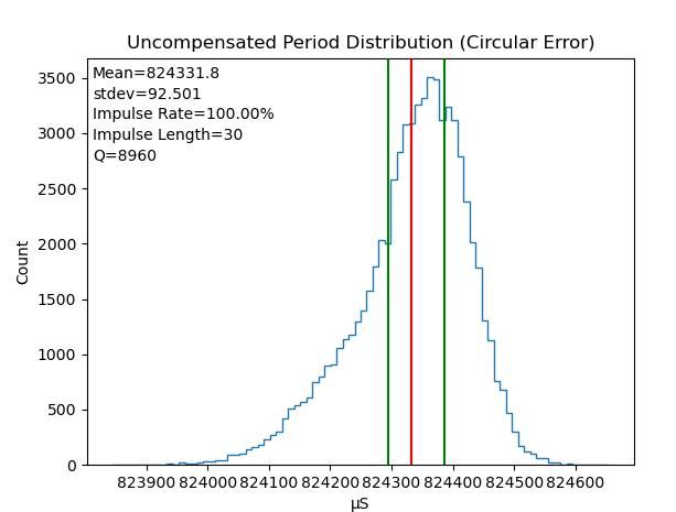

                                  Today's results are good despite me messing up fitting the cover yesterday by bashing the clock. After resetting I had to increase the impulse to get reliable running. May have overdone it, because the distribution is biased towards fast beats, rather than centred around the mean.
                                  Q is improved to 8960. Possibly this is because re-levelling the clock de-stressed the suspension, but no doubt the bob being draughtproofed helps too.
                                  Time keeping is OK: 0.32s slow after 16 hours uncompensated, 0.06s fast after compensation.
                                  Next job is to compensate in the clock. Looks good in theory, but making stuff work in practice isn't so easy.

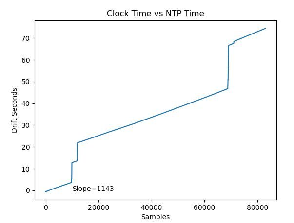

                                      Yesterday I modified the clock to keep it's own time corrected for temperature and pressure. The result depends only on the pendulum and isn't influenced by GPS or any other external time reference. They're only used to measure performance.
                                      After only 19 hours, the clock is 75 seconds fast, a cruel disappointment.
                                      Still hope because the graphs and data log show I still have software problems. Clock vs actual time (NTP) shows the biggest error is due to three step jumps:
                                      The log shows these jumps are always associated with corrupt data. This example shows beat number 69071 jumps 0.744 seconds and all the data values are correct apart from the tick count, which is 1271824 when it should be close to 13174874.
                                      69071 1271824 0.4136 0.3600 28 984.46 84.57 14.44 824435 1673076005 736565 1673075946 582831 –0.7443499999999972
                                      Seems that once in a blue moon (202 errors in 83107 beats), the clock hardware registers a beat correctly, but the tick count is mangled and the log output delayed. Been trouble with this before, and I thought I'd fixed it. Obviously not! However, I have a good idea what's wrong and shall test another fix today.
                                      Another problem is that barometric compensation isn't working properly, period rising as pressure falls:
                                      I think I know the cause, but not what to do about it. Faulty application of the statistics is suspected. I understand how to compensate for temperature changes OR how to compensate for pressure, but am far from convinced I know how to do both. I've assumed they can be compensated together in the clock code, and although the barometric error is small, about 5 microseconds per millibar, any link being evident at all suggests I'm wrong. Needs more thought. Might have to start another thread on fixing my iffy mathematics!

                                            Posted by SillyOldDuffer on 07/01/2023 11:47:28:
                                            I hope you don’t mind me mentioning this, Dave … I think that statement is more exactly true than you might have thought when you wrote it. [at least in terms of your plots, if not in reality]
                                            I have just copied your picture and flipped it: and so far as I can tell visually, they match precisely.
                                            Unless I am stating the obvious [in which case, shut me up], I would suggest you check what data you are actually plotting.
                                            #628044
