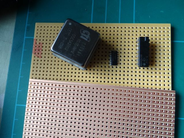

        Before xmas, thanks to John Haine, I ordered a second-hand 10MHz Oven Controlled Crystal Oscillator. Not the best OCXO ever made, but only cost a few pounds and it's 5 times better than anything else I have. The output is a 5V logic level too, ideal. It needs to be boxed up and powered.
        Annoyingly, the microcontroller the OXCO is intended to feed has a maximum external clock speed of 6.4MHz, so simply stuffing 10MHz into it won't work. Not a big problem I thought because there are lots of chips which will divide by two, and the microcontroller will be happy with a 5MHz input. Silly me. My junk box failed to provide a suitable chip, so I ordered a couple, which arrived yesterday. Big mistake, they're sub-miniature, which don't go well with my eyesight and clumsy soldering technique. What I assumed was an old-school 14 pin dual in-line package, a type that's become rare with passage of years.
        Wanting to show the difference, and to show that the older DIP package fits neatly into a 0.1" stripboard, I grabbed an example at random and took this photo:
        As can be seen, the pins on the tiny chip don't line up with the copper strips or the hole grid. This is a right pain, because I either have to source a larger chip, or make a printed circuit board, or make a carrier for the small chip. A simple job suddenly got complicated.
        However, at this point I noticed the workshop gremlins had got me good and proper. The random chip in the photo in a 7490, a decade counter equivalent to the tiny one, and exactly what was needed in the first place. So I've wasted time and money!

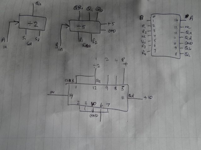

        Moving on, I have to assemble this circuit:
        10MHz from the OXCO will be taken direct to one BNC socket, whilst pin 12 on the chip puts 5MHz on a second. I'll also use the chip's divide by 5 module to put a 1MHz output on a third socket.
        A problem solved though is that the OXCO pins aren't on a standard 0.1" setting. However, it will fit standard stripboard if rotated as shown, and a hole is enlarged for the slightly off earth pin.

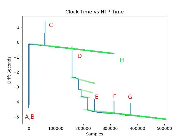

                Meanwhile the latest clock graph has started an investigation:
                I don't know what caused the A & B down spikes, or the C,E,F, G up spikes. Or the down staircase at D. Maybe a bug in the maths, because the log data doesn't seem to be jumping about. But as the changes are quite small, I'm writing a program to zoom in on anomalies.
                The green slopes, showing GPS and NTP are apparently drifting apart, might well be due to rounding error. I measure the pendulum in 16MHz crystal ticks giving 8 digit precision, but my clock code truncates them into 6 digit unrounded microseconds. Better I think to alter the clock to measure internally in crystal ticks rather than microseconds, only converting to human time after the sums have been done .
                Good news though is that a simulation of the temperature compensation code looks effective, so I need to implement it in the clock, and then add barometric compensation as well. I'm optimistic this might work reasonably well and there are more improvements in the pipeline.
                If I was running this as a project, I'd sack the Designer, Machinist, Programmer and Mathematician because they've all made silly mistakes. Unfortunately these roles are all done by me and I have to put up with the team I've got.

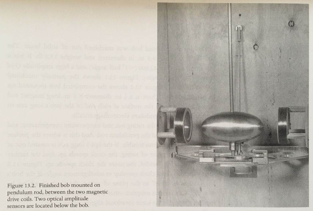

                                  This is an abstract from a book on pendulums by James Matthys in which he mentions the best shaped being a prolate spheroid, which is academic speak for rugby ball (or football if you're American). He says that a cylinder with 120 degree pointed ends is pretty good, but no mention in the abstract of L/D ratio. The long axis is in the direction of travel obviously. However unless the rod is non circular it won't be easy to make sure that the long axis is aligned, hence the use of spherical bobs, which are a non oblate spheroids
                                  no-one has mentioned the drag on the pendulum rod. This suggests it is not necessarily negligible. Perhaps SOD is on to something with his thin carbon fibre rod

                                    Posted by duncan webster on 02/01/2023 12:50:19:
                                    This is an abstract from a book on pendulums by James Matthys in which he mentions the best shaped being a prolate spheroid, which is academic speak for rugby ball (or football if you're American). […]
                                    My copy of Matthys is packed-away at the moment; but I don’t recall him exploring the proportions of that shape in any great detail. … I may be wrong, and perhaps John Haine could advise.
                                    Obviously there is a geometric similarity between all prolate spheroids, but I suspect the devil would be in the detail.
                                        Interesting reference that ^^^ thanks Duncan yes
                                        I was more than a little surprised, though, to see them using Nylon monofilament as the ‘string’
                                        s-t-r-e-t-c-h-y stuff, is it not ?
