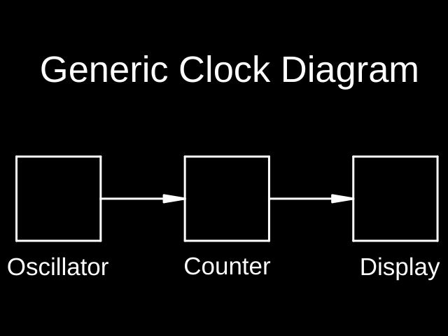

      Ah, a misunderstanding! Here's a block diagram of a clock:
      Typical oscillators are the earth's rotation, pendulums, balance wheels, quartz crystals, and the vibration of certain atoms. The perfect oscillator is stable, it doesn't drift, jitter, and it maintains a steady output no matter what. There is no perfect oscillator. Pendula are sensitive to temperature, air pressure, vibration, tidal effects, and possibly humidity. All friction is bad, as is any physical change in the bob, rod or suspension.
      The counter is any device that counts beats and divides them into something useful such as Hours, Minutes, and Seconds. It also allows the clock to be set to a particular time. In a mechanical clock the counter is a fixed ratio gearbox.
      The display is any device that converts the counter output into human useful form – the hands of a clock, or a digital display.
      It's important to isolate these stages from each other. The Display mustn't effect the Counter, and the Counter mustn't effect the Oscillator. This is quite difficult to do in a mechanical clock, and pendula are very sensitive to outside influences, especially impulses, temperature and air pressure.
      My clock minimises impulse problems by removing all physical connections to the pendulum. The escapement is replaced by an Infra-red beam and an electromagnet. I have accurate control over when the pendulum is impulsed, and impulse strength. In practice so far, these have been reduced manually to the point where the clock runs reliably. They could be used synchronise the pendulum to GPS, but aren't.
      A conventional pendulum clock compensates for temperature mechanically in the pendulum, usually by exploiting the different expansion rates of two metals. One way is to partially fill the bob with Mercury. When the temperature rises the rod expands and would alter the timing, except the Mercury also expands, lifting the bob's centre of mass by rising inside it, and counter-balancing whatever the rod does. I'm not doing anything like that.

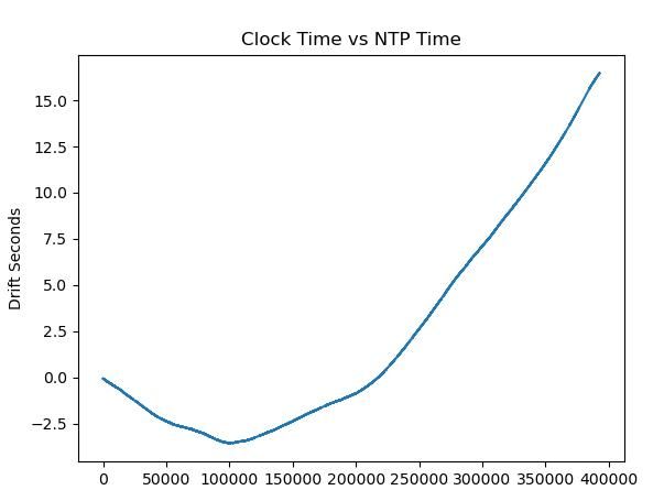

      Instead of compensating the pendulum, I correct it's errors in the counter. My counter is a microcontroller, where the ratios are implemented in software. In addition to counting pendulum beats, it also reads temperature, pressure and humidity. After testing the clock over a long period, I know what the pendulum's period should be at any given temperature, pressure and humidity, and can compensate for them in the counter, not in the oscillator.
      For this scheme to work the pendulum has to be reasonably well-behaved, which it isn't yet. I can compensate for reliable changes, but not for variations caused by unknown factors. This graph is giving me grief, it shows my clock is drifting and is fast compared with NTP:
      What I don't understand is why the clock drifted slow at first, and then switched to drifting fast. It's not temperature or pressure related. If the rod were stretching or something like that the drift would be constant in one direction, not a tick shaped curve.

      That all sounds very satisfactory. Essentially you are testing the pendulum to determine the rate under all conditions.
      If you know the rate and can measure the conditions you can keep track of the time by integrating the ticks with a variable rate co-efficient. No different to any other precision clock including Harrison’s where the rate was measured and the time calculated from the time of running since setting the clock and the going rate.
          Thank you Dave, now I am a little clearer about what you are attempting. What confused me was the digression into PID control – a technique I learned (and forgot about) long ago, but all in the context of closed loop feedback control. So I assumed you were trying to close the loop electronically.

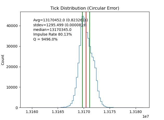

                                          Last night watching a boring film on telly, I tackled the problem of extracting Q from my clock's data log. It contains nearly half a million records, including an accurate measure of the pendulums period.
                                          Pendula have a number of characteristics, most obviously how long each swing takes. Nearly as important is 'Q', which is a measure of the pendulum's "goodness". It's the ratio between power stored and power consumed.
                                          Q = 2π × storedEnergy ÷ energyLostPerSwing
                                          An ideal pendulum would lose no energy and swing forever after a single impulse. Real pendulums lose energy stirring air and in the suspension. After building a low-loss suspension, running the pendulum in a vacuum increases the Q by a factor of about 5.
                                          One way of measuring Q is to set a pendulum swinging and measure how long it takes to the amplitude to halve, the time being multiplied by 4.5 The method is tedious and not particularly accurate unless special care is taken. Another way, when a log is available, is to determine the signal's bandwidth from the distribution of tick times. Then:
                                          Bandwidth = resonant frequency ÷ Q
                                          The maths is explained in more detail here.
                                          For my purposes, coding in Python with the numpy (Numeric Python) module, the calculation is rather easy because numpy comes with a percentile function. Given a list of periods, the resonant frequency is the 50% percentile and the bandwidth is the difference between the 70.7 and 29.3 percentiles. In python:
                                          # Q
                                          h, l, r = numpy.percentile(ticks, [70.7,29.3,50] )
                                          b = h – l
                                          q = r / b
                                          print('Q',q)
                                          Bandwidth of the tick distribution shown graphically, green lines, below:
                                          Thus my pendulum has a Q of 9496. This is in the range Q=3000 to 15000 given by Rawlings for Regulator pendulums in Air. It suggests the suspension spring I made from a disposable safety razor blade is acceptable.

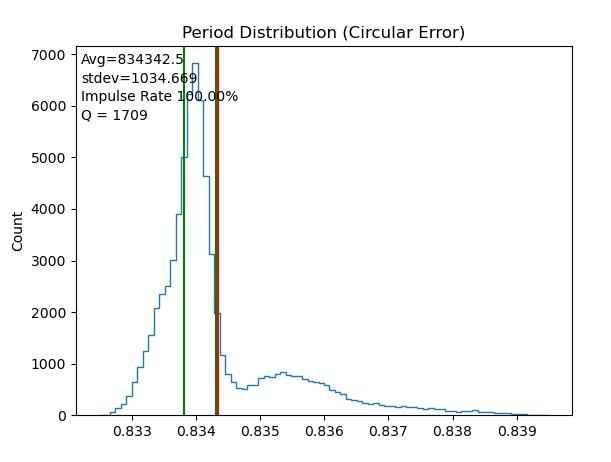

                                          Sharp-eyed clock-aficionados will have noticed not all is well with graph above. The distribution, which should be balanced around the red-line is skewed in favour of fast periods. Coupled with the rate graph, it appears my pendulum is speeding up. The clock is now 29 seconds fast after 4 days 15 hours (poor). The drift probably explains why Q is dropping, last night it was nearly 9600, now it's 9350. I think the apparent bandwidth increases as the clock drifts.

                                            Great progress, Dave
                                            … I am very impressed [and genuinely surprised] by that Q
                                            Looks like you are heading for stardom !

                                                The result assumes I understood the maths and wrote the code correctly! I'm not entirely surprised it's that good because the design is so simple. Provided it's hanging straight, and the spring is about the right boing, there's not much to go wrong. I took your advice last time the suspension was apart by exposing more spring. In the next version I plan to make a new spring longer and thinner as you suggested ages ago.

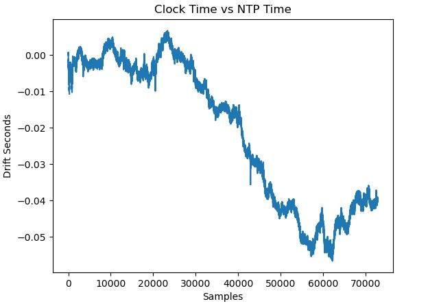

                                                Good news though is that the GPS corrected period measurement appears to be working. This was the main reason for upgrading the clock.
                                                So far GPS is holding up. The antenna now looks out of a west facing window, and the GPS module locked immediately rather than taking an age to find enough satellites, always a good sign. But, the availability of good signals might change as the earth rotates and the satellites in view change. A disadvantage of using GPS is poor signals cause my period correction to go potty. When the parts arrive an OCXO will be substituted; less accurate than GPS, but doesn't depend on an indoor antenna.

                                                      Set the clock up in a mad rush yesterday and after frantically fixing a few software bugs, I left it running.
                                                      Ran the statistics just now and had a heart attack because the results are so good! After nearly 17 hours, my clock is 0.039 seconds fast, an error in the same ball-park as Shortt №48, which wobbled about 0.02 seconds per day when measured with an Atomic Clock.
                                                      Of course it's a false dawn. I've inadvertently created a GPS locked pendulum of the type suggested by Peter and Howi. I added GPS to the apparatus to measure pendulum period more accurately, and didn't notice that the real value was fed into the clock's counter. So the clock counts in GPS measure, not natural pendulum beats. The figures show that GPS and NTP are accurate, not that my clock is wonderful, sob!
                                                      The circular error graph confirms the lie. The distribution is badly skewed, and Q has dropped to 1709:
                                                      Two likely reasons. A known error in the Impulse logic is walloping the bob too hard, but mostly I moved the clock to another room. and the suspension is easily upset by being moved. An improved suspension is already on my 'To Do' list – need to get on with it.
                                                      On a positive note, a potential source of measurement error is eliminated. The GPS enhancement confirms the clock's temperature drift is mainly due to the pendulum, not the Arduino crystal.
