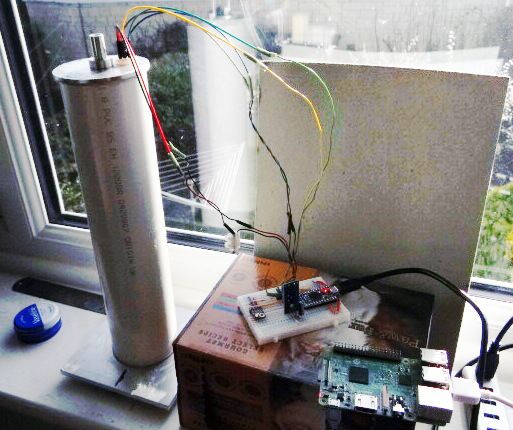

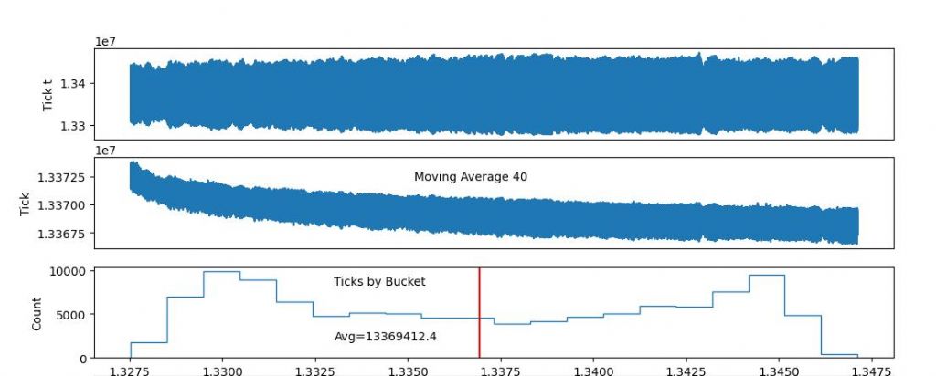

Good questions. The microcontroller is a Sparkfun Pro Micro, a miniaturised version of an Arduino Leonardo. It comes with a quartz crystal rather than a cheap unstable ceramic resonator. However, the crystal is an ordinary 50 – 100ppm type, there's no capacitor, and I've made no attempt to stabilise the temperature.
The microcontroller measures the number of crystal ticks per swing and for best resolution this is mostly done in hardware. The 16MHz system clock feeds a hardware counter triggered on/off by the pendulum blocking an IR beam. The counter is zero at start and on overflow, it clocks another counter. When the off signal is received both counters are frozen and a simple sum gives the total number of crystal pulses per swing. As the counters run at 16MHz, the pendulum is measured in ticks of about 0.0625 microseconds, considerably better than doing the same in software (worse than 4 microsecond resolution.) Accuracy depends on the quartz crystal, which of course could be wrong by 100 parts per million, and is temperature sensitive.
The same counter technique can be used to measure the actual frequency of the crystal. Substituting the seconds pulse output of a GPS module for the pendulum, the microcontroller counts the number of oscillations made in one second. This can be repeated and averaged.
In the clock, during the 0.8s between swings, environmental data is read, and everything logged to a Raspberry Pi3B.

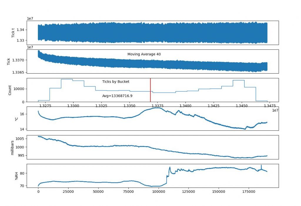

The data is:
13432949 0.7461 200 0 994.76 81.29 14.87 836040 1669630663 148802507
Tick Count – 13432949
'Amplitude' – 0.7461 (actually a measure of how fast the pendulum is swinging, used to decide if an impulse is needed)
Pulse – 200 How long the magnet is switched to impulse the bob
Power – 0 (false) Whether or not the magnet was impulsed.
Pressure – 994.76mb
Humidity – 81.29% Relative
Temperature – 14.87°C
Nominal Clock Period – 836040uS. The uncompensated period used by the stand-alone clock. (Should be 835650)
Clock Time as UNIX Timestamp – 1669630663. Number of seconds since 00:00:00GMT 1/1/1970
Clock Time UNIX subseconds – 148802507. Fractional part of UNIX timestamp.
In the current set up I'm measuring the crystal's average frequency by comparing it with Network Time. The Raspberry Pi3B is connected to the internet and synchronises using NTP every 38 minutes. It timestamps log data on receipt, making it possible to compare pendulum clock time with network time, but otherwise has little else to do that might interfere. The arrangement isn't brilliant, but the Pi3B's notion of time is always better than 0.1s accurate, making it suitable for long-term comparisons. The number of crystal ticks counted over several accurate hours gives the frequency. I should also analyse the data by time slots, to see how the average frequency alters hour by hour.
Until this morning, results suggested the experimental clock wasn't sensitive to the environment, but today suggests it could be tracking air-pressure. In the graphs below, the moving average falls with the millibar line until this morning when both lift together. Far from conclusive! I need to let the clock run for a lot longer.
I'm flummoxed by the shape of the 'Ticks by Bucket' graph. Next job is to check my code for the fifth time! Maybe I've misunderstood matplotlib or messed up the analysis. Otherwise I can't imagine how a pendulum's period could vary like that.
